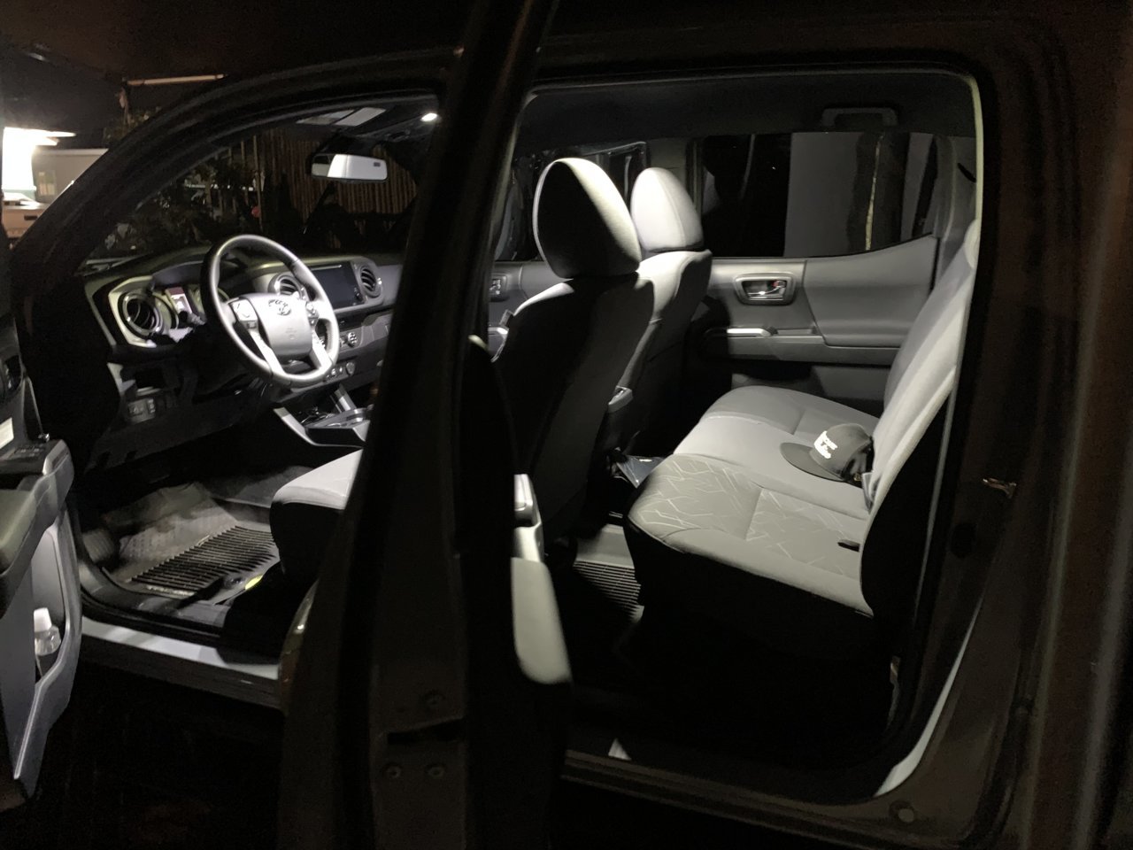

    Got my map and dome in and it’s brighter than my future. I disconnected my battery while installing and connected it to test. Then disconnected again and flipped the connector around and it works. Thanks for the tips fellas :taco:

    I was in amazed how bright the dome and maps were. First time opening the doors in the dark I was like "MESO blinded!"
