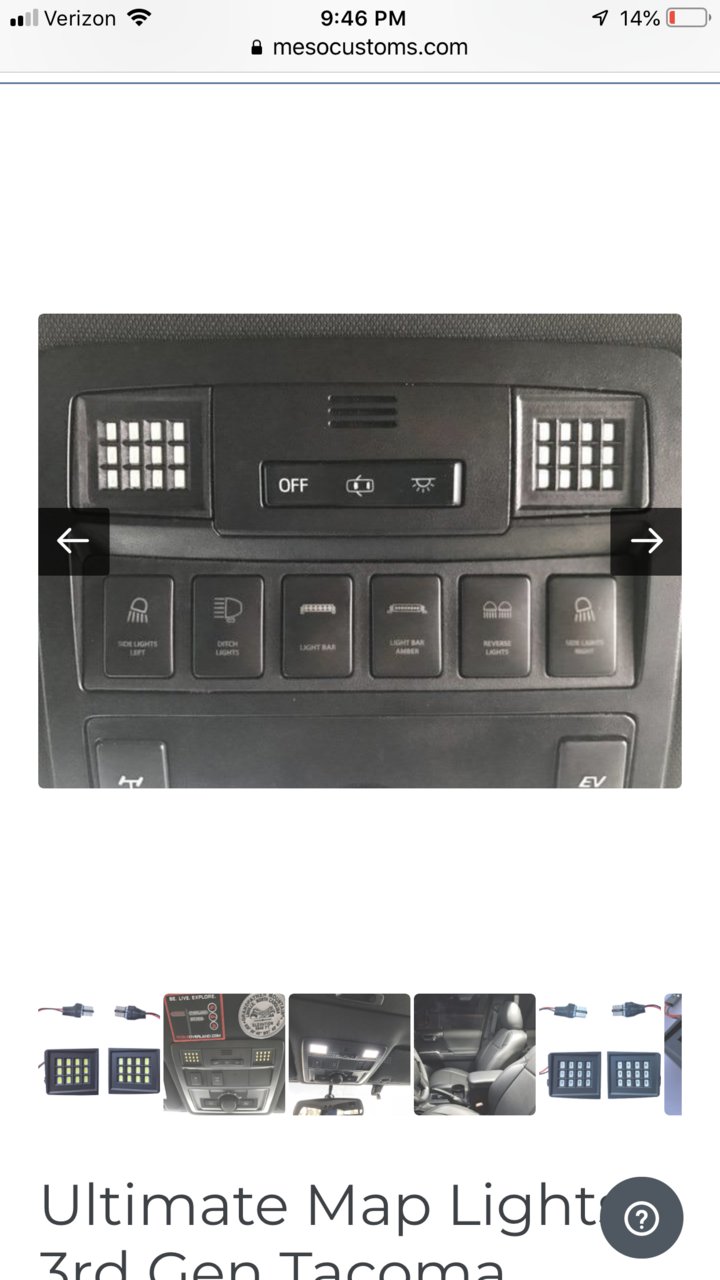

    Installed Meso Dome Lights, and shorted a fuse in the process. I’ve since replaced the cgo lamp fuse, and the light turns on. However, my interior lights stay on if they are set to turn ‘on’ whenever the door opens or the doors are unlocked. They should turn off automatically when the doors are closed.
    Is there another fuse that is responsible for ‘reading’ the status of the doors? Has anyone else experienced this?

    Dome light or Map lights? If it's the map lights, try pressing on the light itself, the have their own independent switches.

    Dome lights. It seems to rely on the map light switch though. If that part is in the middle (pic of open doors), both lights stay on regardless of doors open or closed.

    That circuit (electrically) is quite weird. Try switching polarity on the map lights, then the dome light. You haven't broken anything I don't think, but the ground path could be wrong.

    I didn’t do anything to the map lights - those are stock. If I reverse polarity on the dome lights, I fear it will short again and put me back to where I started.

    You say it “on” but describe the “door” setting. I’m probably just misunderstanding do to the fog of the internet. Just to make sure the switch has 3 positions off, door, on. To have it operate that way you are wanting the switch must be in the center not clicked on either side. FE35A10C-177B-4E7E-B966-A9EDDE5B2D8C.jpg

    Yes, it’s clicked to ‘door’ but behaves like ‘on’, meaning regardless of door open or closed, the light stays on.
    Internet fog is real, harder to explain without a video. Maybe I’ll make one of those soon.

    Sounds like both your maps are turned on at the map switch not the center switch.
    Try pushing each map light on/off.
    There are 5 switch positions for each map.
    Center switch OFF
    Center Switch DOOR
    Center switch ON
    Push switch ON (Overrides center switch setting. Light will be ON regardless of center switch position for THIS light only)
    Push switch OFF (Gives control to center switch, Center switch now controls ON/OFF of this light)
