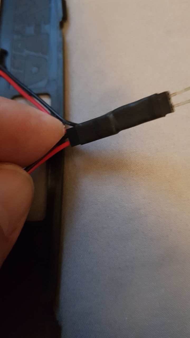

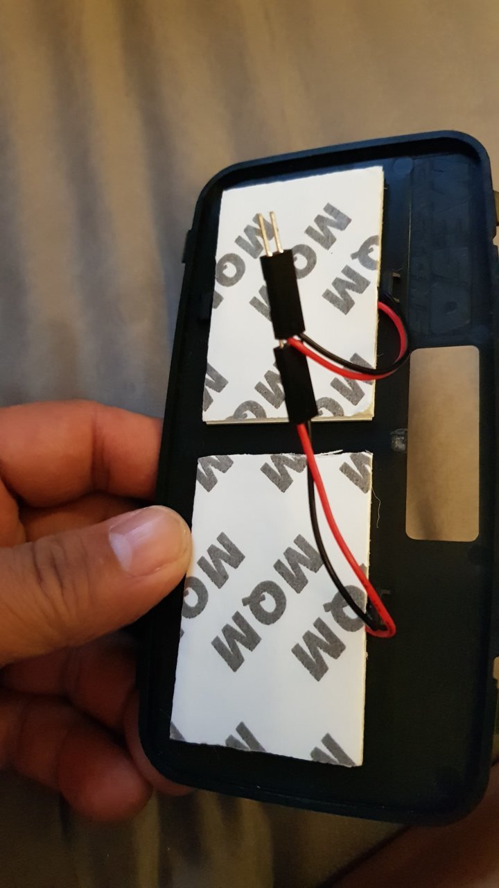

    Just checked and the red dome is available on his website. I just got them yesterday in the mail. Installing it in a few minutes although I changed them out to white SMD lights going to piggyback the two separate panels and use one festoon adapter. I have about 10 of the white SMD 48 LED panels and popped them in to the MESO housing. Had them when I changed out the old festoon bulbs in the Yaris dome light. Going to use the others in the Buick dome light. Thinking of changing out the map lights in the Verano and see if they will fit under the diffusers. The red I am setting aside just in case.

    As long as the pattern is the same should be okay. I got two 12 (3X4) SMD for the front and two 48 SMD for the rear. If you do some more digging you should find them in two packs instead of buying 4. I’m just taking a chance here but the ones I ordered seem to be the same. Will know for sure when they arrive, and for 20$ shipped for all 4 I’ll be okay if they don’t work at all. The rears will require some soldering to join the wiring from the two panels to one adapter for the dome light. If you look at your MESO rear dome you’ll see how to solder the two panels together.

    Hey that piggyback definitely works too! Cool to see someone else mod their mod as well lol.
