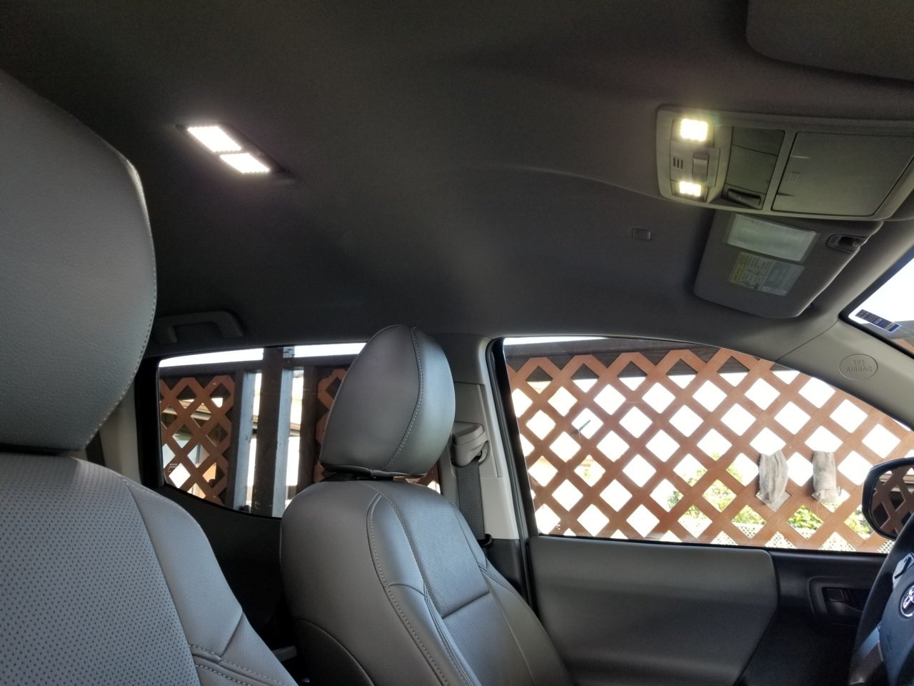

    Disconnected negative on batt, installed with red (+) wire on drivers side for the maps and dome and successfully installed on 1st try. YMMV.
    Bright even during the day, must be crazy bright at nite.

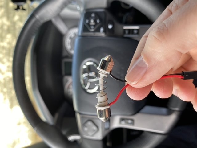

    same problem here, no matter how compressed it will not fit
    edit @MESO sent you a pm on the connector for a different reason, too
    edit #2 - got it to fit. Prebent the rod just slightly and it fit. Super tight.

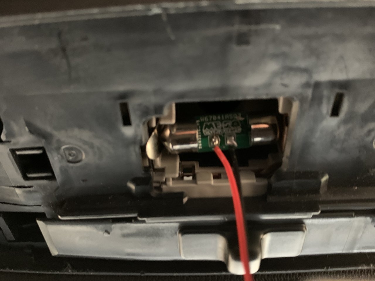

    @MESO finally got to give it another go w/ the prototype you sent out. Much easier install, works flawlessly now, and a lot less frustration. Thank you much!

    I also received the prototype connector today and got it installed. It fits much better and was very easy to install.

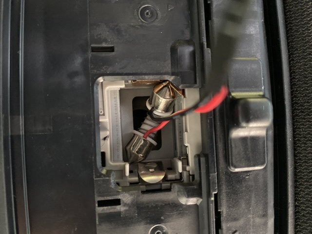

    For the dome light on a 2019 it took me several minutes with a razor blade to trim the plastic down so that the one end went to the other. I did not take pics but that solved the issue. Just took a bit of time.

    I too buggered up the Festoon spring adapter trying to get mine installed. Luckily I had a bag full of spares from when I bought a bunch of cheap SMD LED panels years ago on ebay. Was able to get it working the second time around. This new design should work much better.

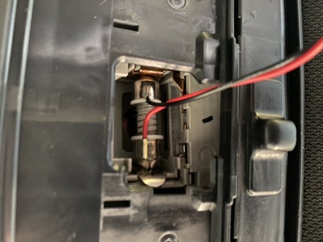

    Hey Stew. Maybe I missed something but I just went to install the Dome light on my 2019 and it doesn't seem to fit even with this new style. I see in your picture there that it still kind of pushed the terminals on the left side but mine seems like it is really pushing them. Is this normal? I ended up putting the old light back in because I was uncomfortable with how much the terminal moved on the left but if this is normal and it will stay in place, I will reinstall. Please advise and thanks for the great products! (I just install your calv blue chrome delete kit on my truck and it looks great!)
