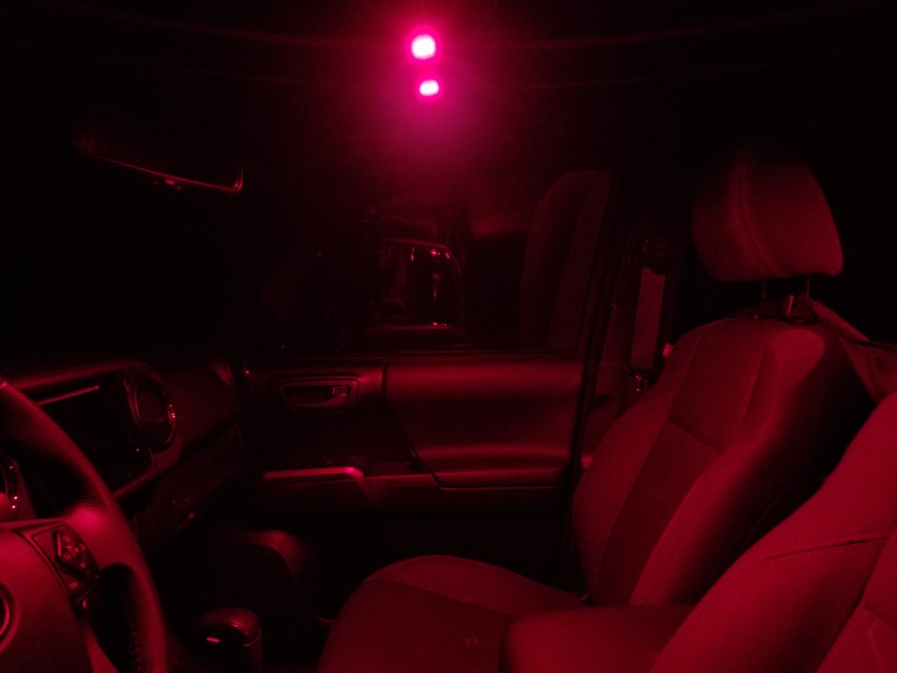

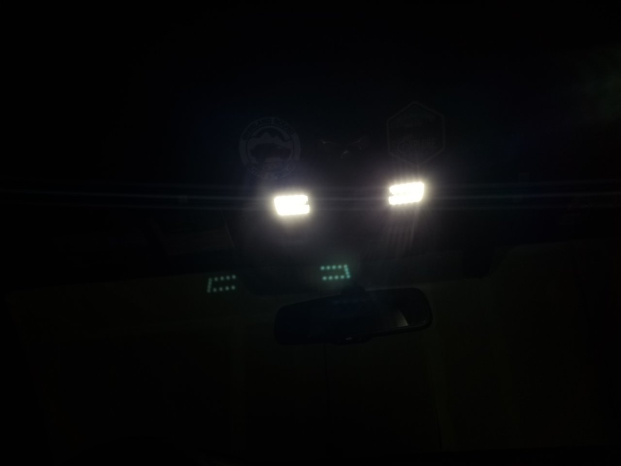

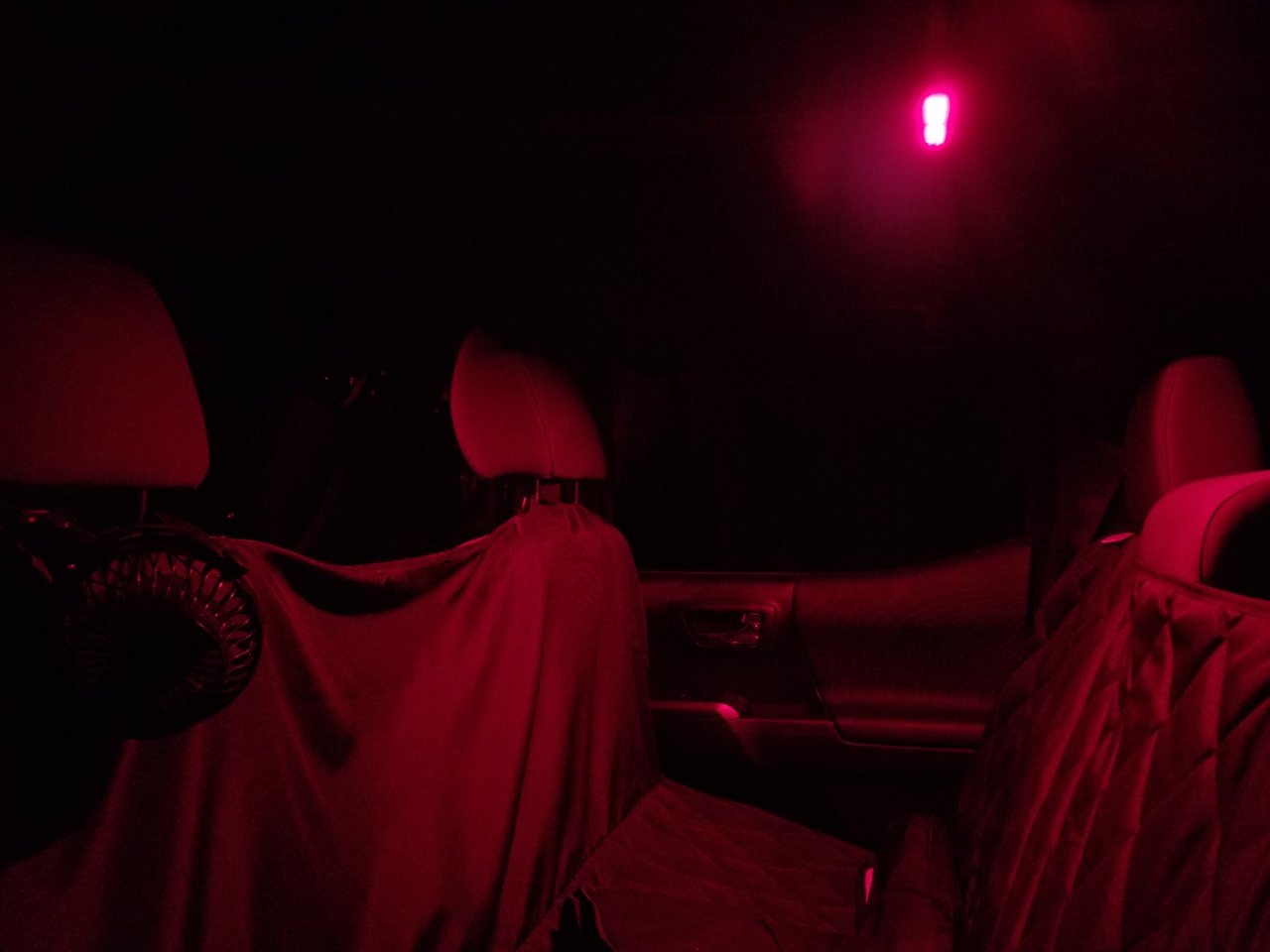

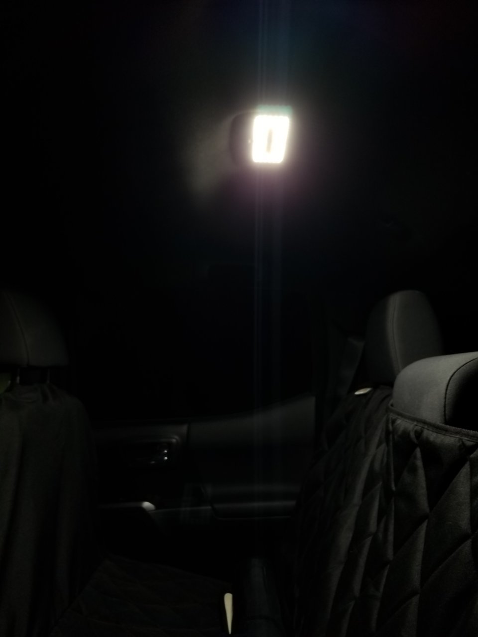

    20211005_201027.jpg 20211005_201041.jpg 20211005_200506.jpg 20211005_200422.jpg
    Red maps and dome lights works.
    White maps and dome lights works.
    All is good!

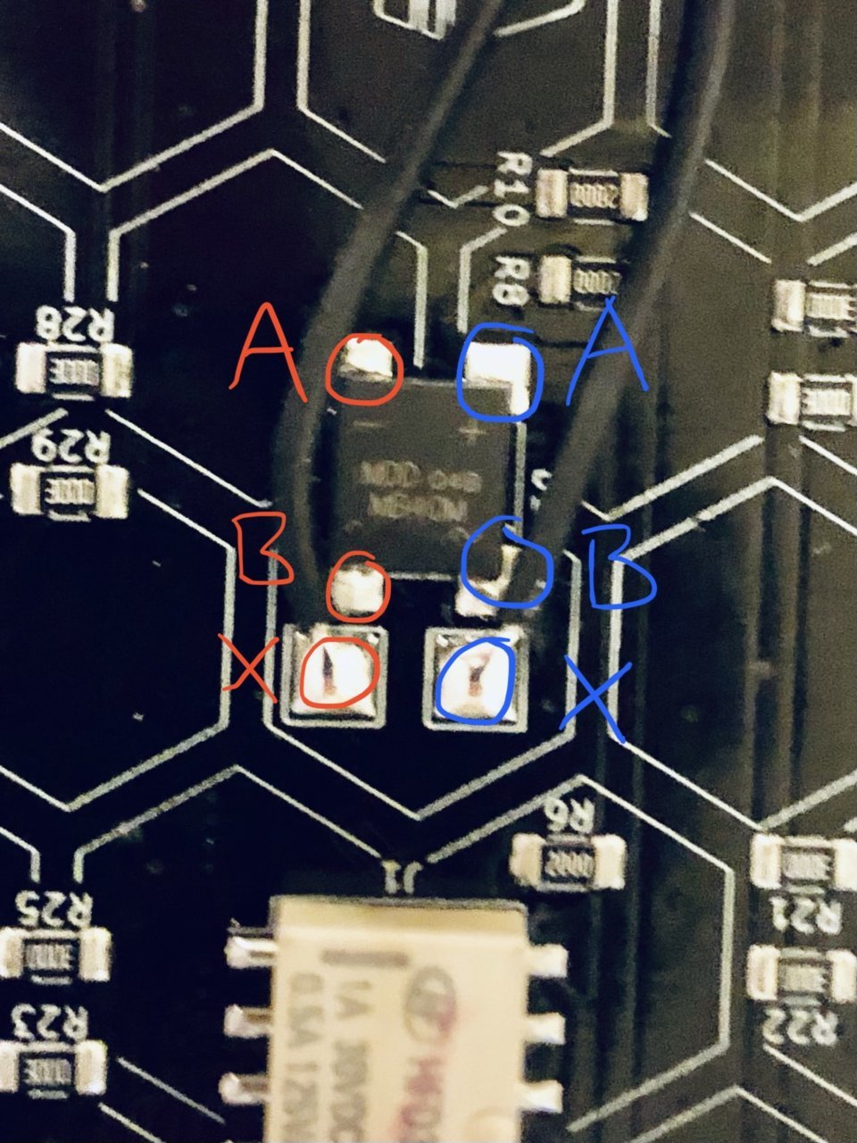

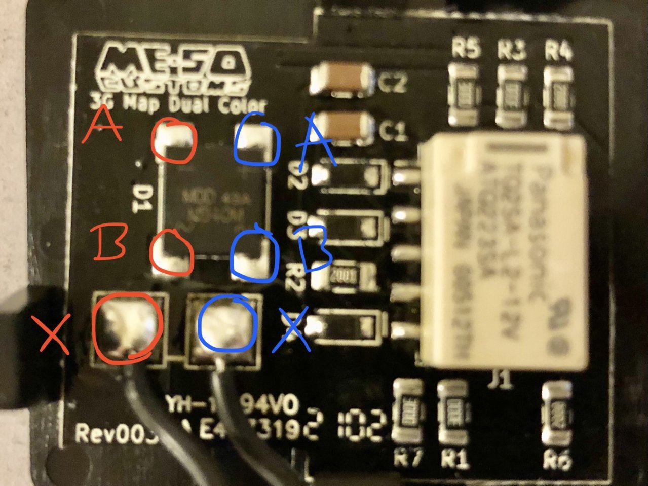

    Thank you for sending a replacement set (MESO has amazing customer service), but I am still having issues changing color and I want to give this a try. Are there any instructions on how to solder these for idiots like me? The way I understand it I need to completely remove the black square (diode bridge?) then remove the wire from the X's and solder it to the corresponding A's? Then its just guess and check on the polarity like the old version?IMG_3038.jpg IMG_3039.jpg

    Yes. I did it myself and it’s great. Not too hard at all. Did Austin send you the video?

    Thanks the help @daveeasa and @MESO. It looks like I had the correct solder points circled for the dome light. Before I get in there can either of you confirm that I have the right points for the map lights too? Thanks!

    Removing the diode bridge completely, you would want to desolder the ends to input A. Some trucks are just affected differently, and it has to do with voltage. I do have a new map light design with a digital switching instead of a manual relay which should alleviate the inconsistent switching. Anyone that ran into this I will send them a set of new ones when they come in.
