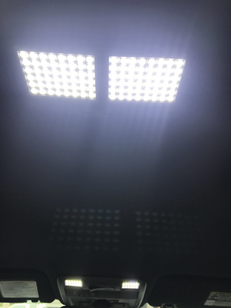

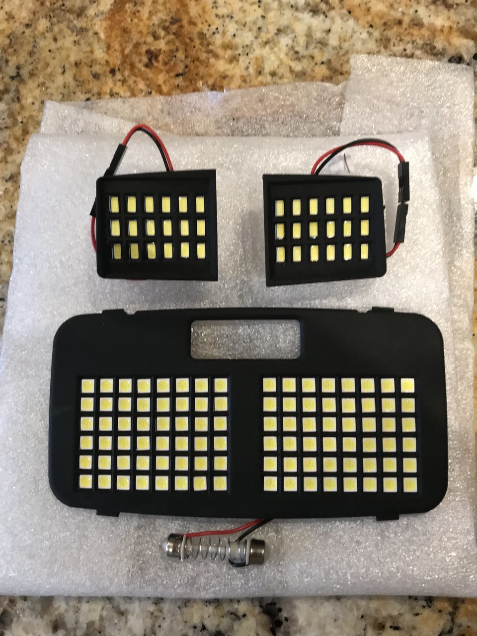

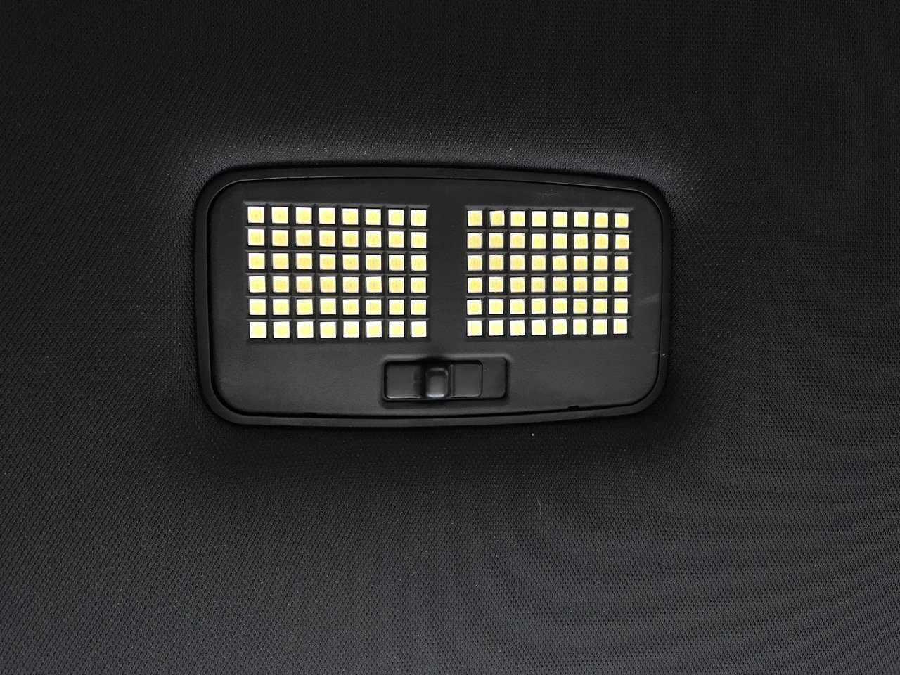

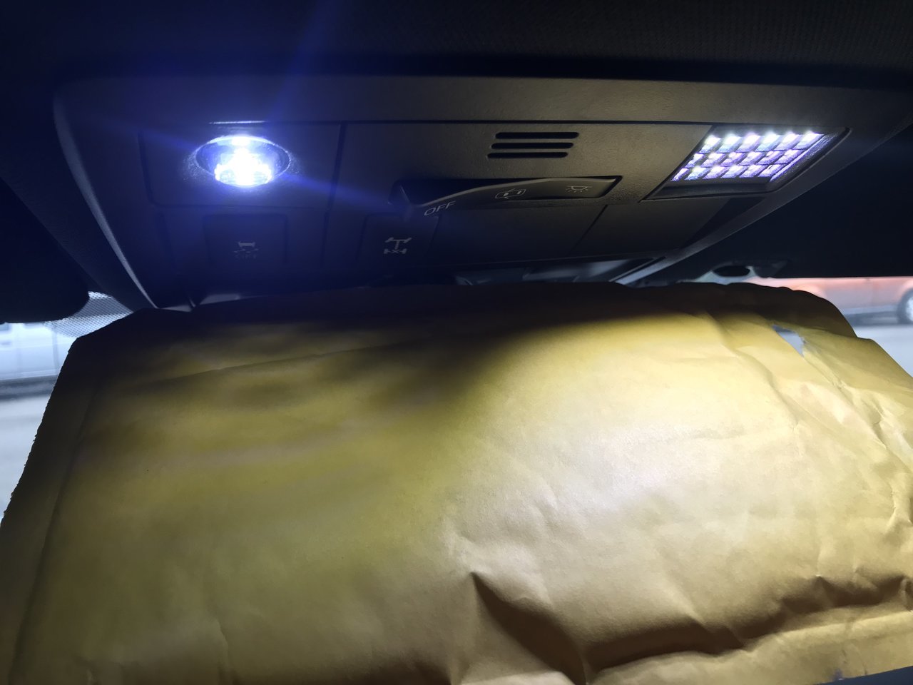

    Ultimate combo = SO F'N BRIGHT! = mesoblind
    Highly recommend a welding helmet to install these. I might need someone to drive me around to even out the tan. Amazing product and factory fitment like everything else he has for sale. Damn!

    You were warned.
    The round map light is a good upgrade, without being super bright. But the ultimate is..well... ULTIMATE. Your picture comparing both puts it into perspective, thanks!
    Dome light pretty easy to install?\

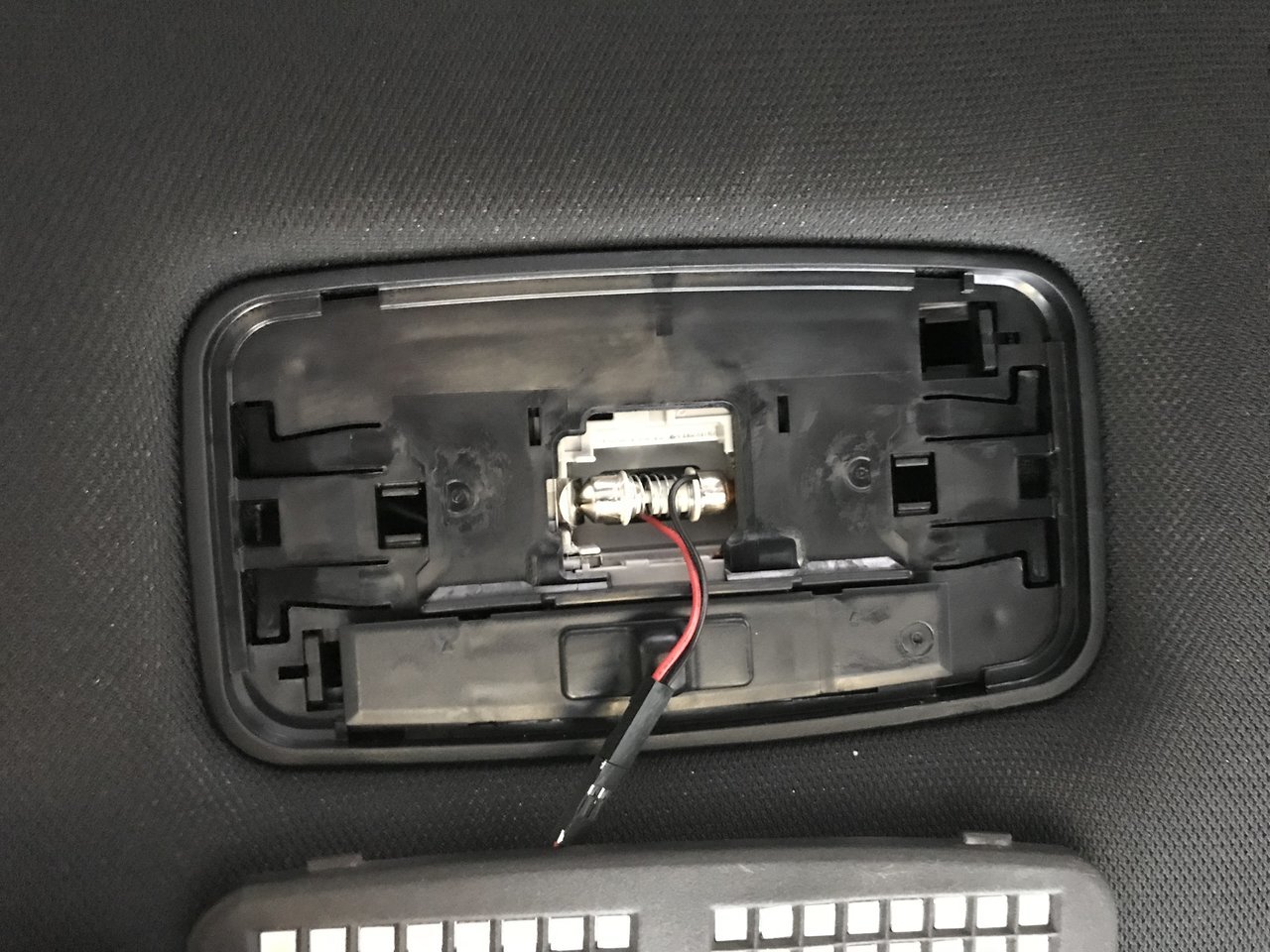

    JUST FYI for everyone, the Dome light POSITIVE + is facing the drivers side. when looking at it from below

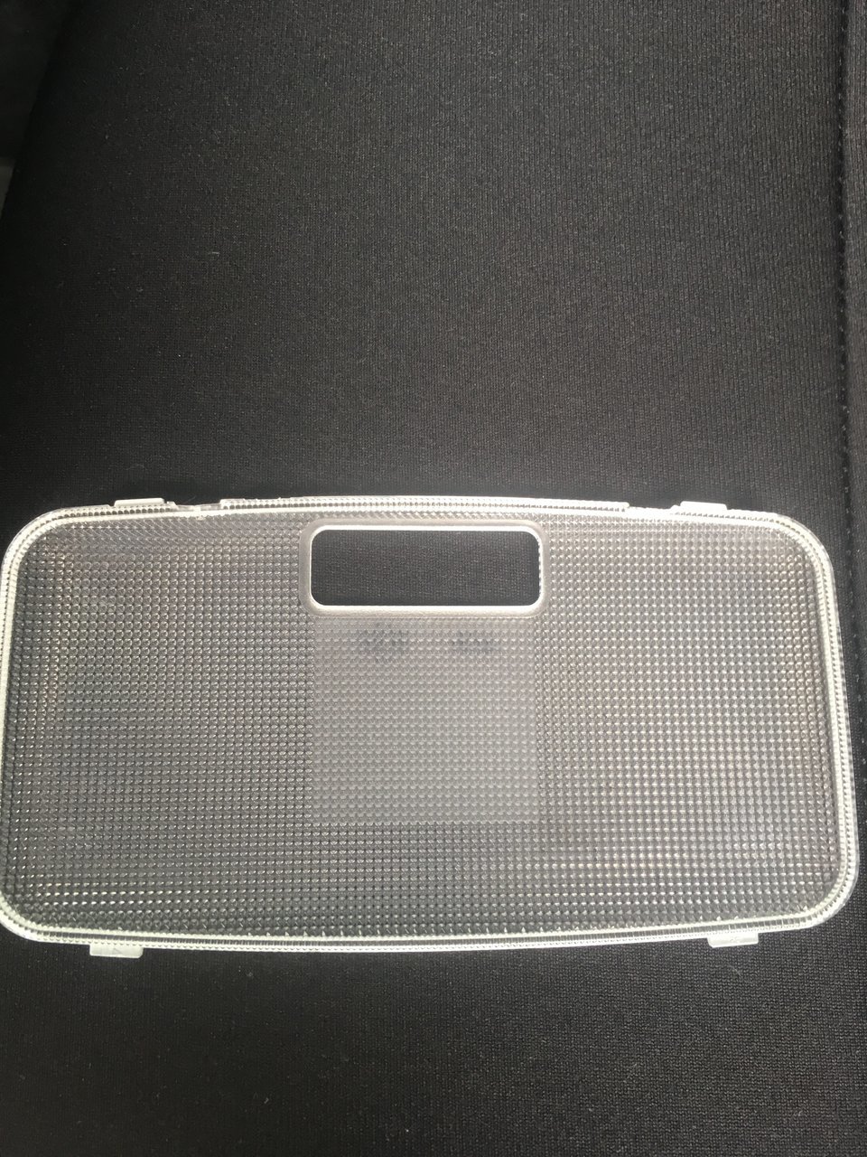

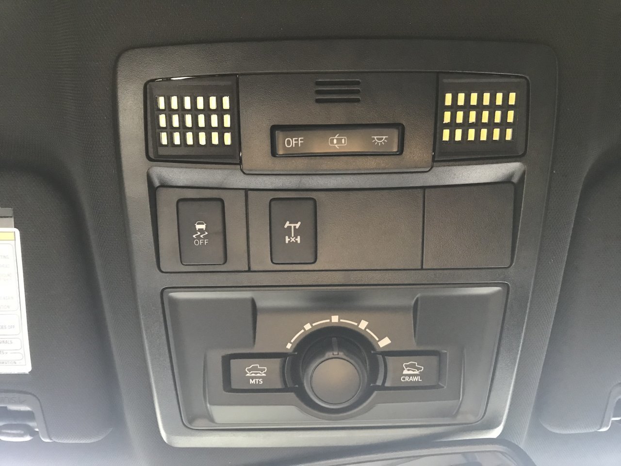

    Yes dome light was super easy to install. I was worried about how I was going to remove everything and thought I would need a video or something, but I was wrong. I pryed the front clear cover of the dome light to remove it with a pocket screwdriver, popped the inferior led bulb out, and then realized your light replaces the clear cover(GENIUS!). Like you said and I was going to warn people that the red wire faces the driver side of the vehicle on the dome light which is why I included that pic before I put it back together. I also figured out that the red wire on the map lights faces the front of the vehicle when it comes out of the socket, but always double check before putting everything back together. Thank you Stew!

    Yeah Rob the factory lense has two small cutouts (notches) so you can use a small screwdriver or whatever your choice of tool is to pry it off, and it comes right out.

    For re installation, insert the REAR in first(will catch the 2 little nubs) and snap in the front of the dome light

    DAYYUUUMM!!! Dude those look badass and holy shit are they bright... My ultimate combo comes in today as well and I'm pumped. Looks sick man!! Thanks for posting :thumbsup:
