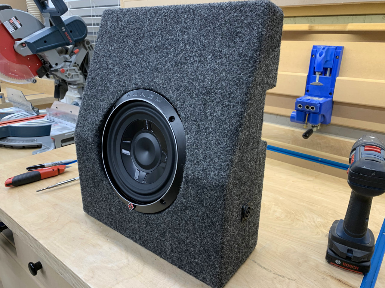

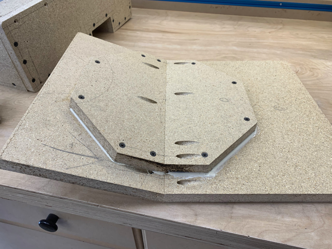

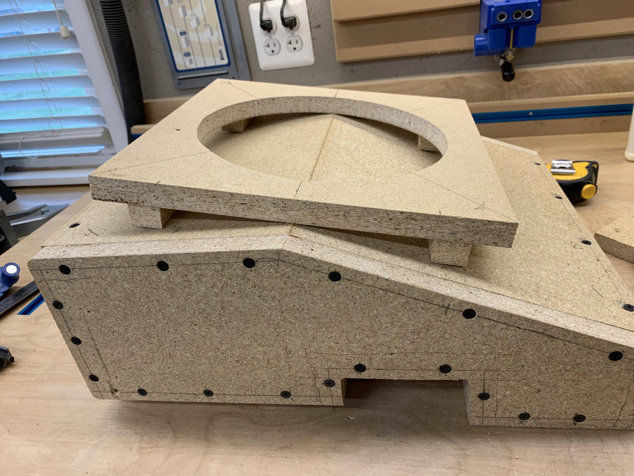

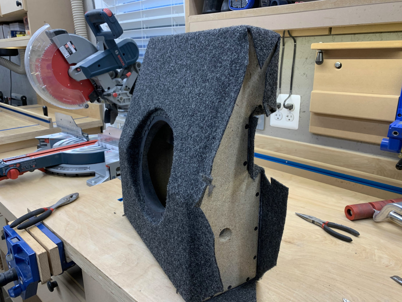

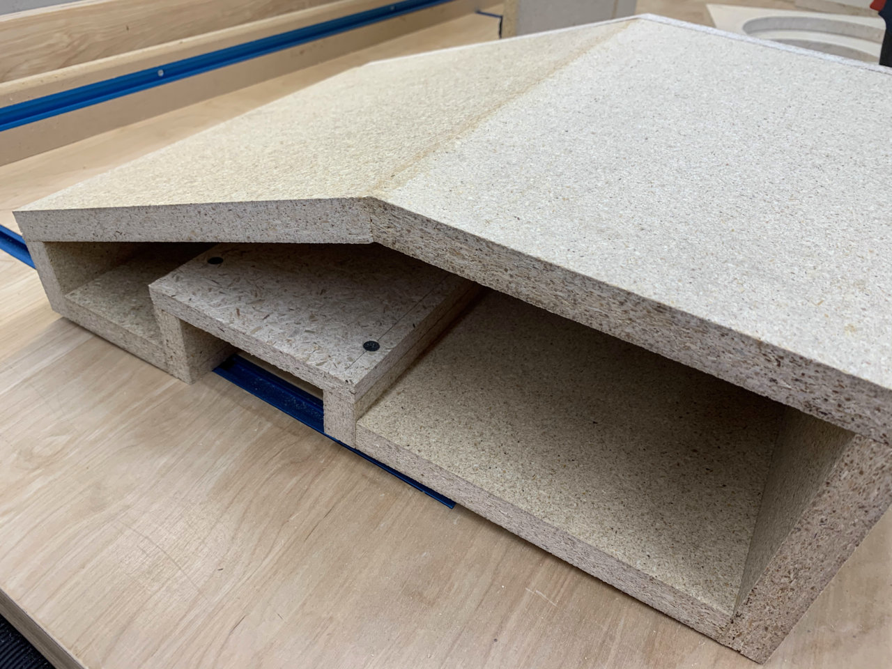

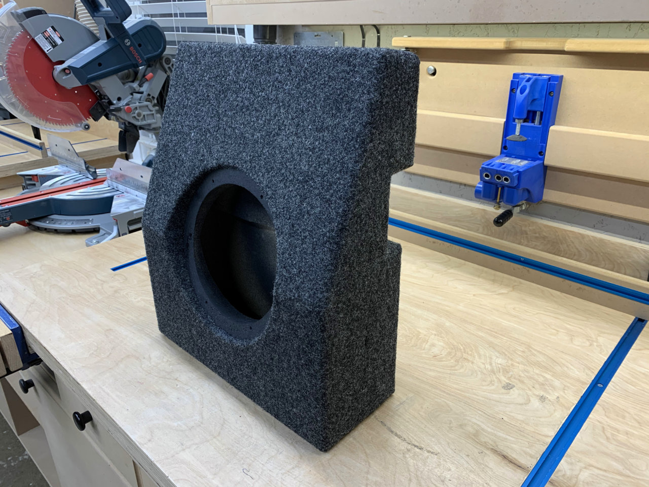

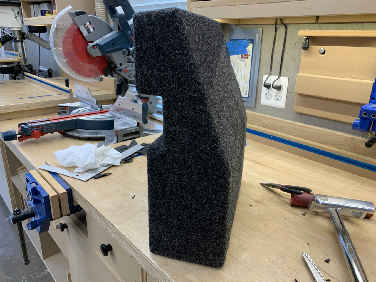

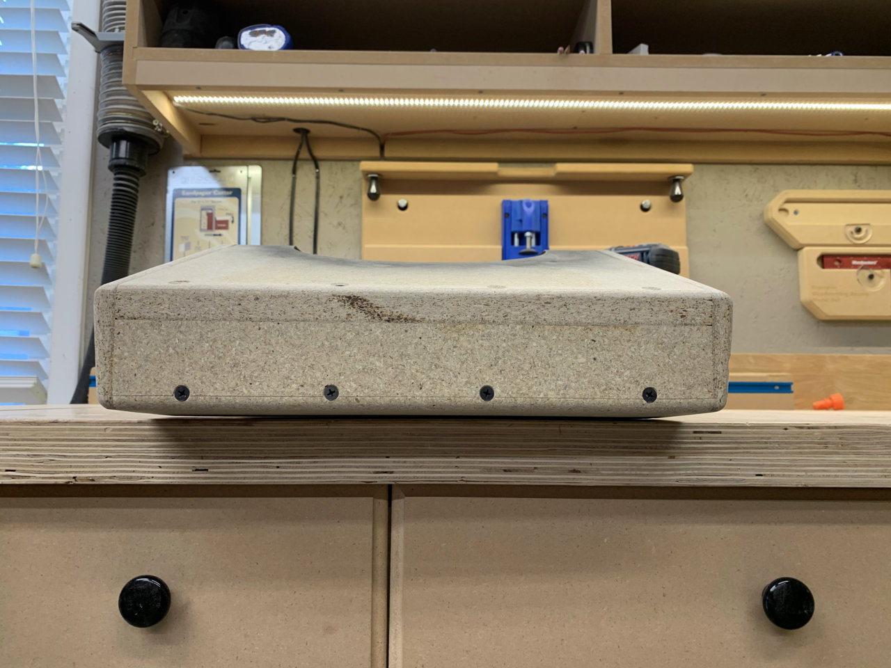

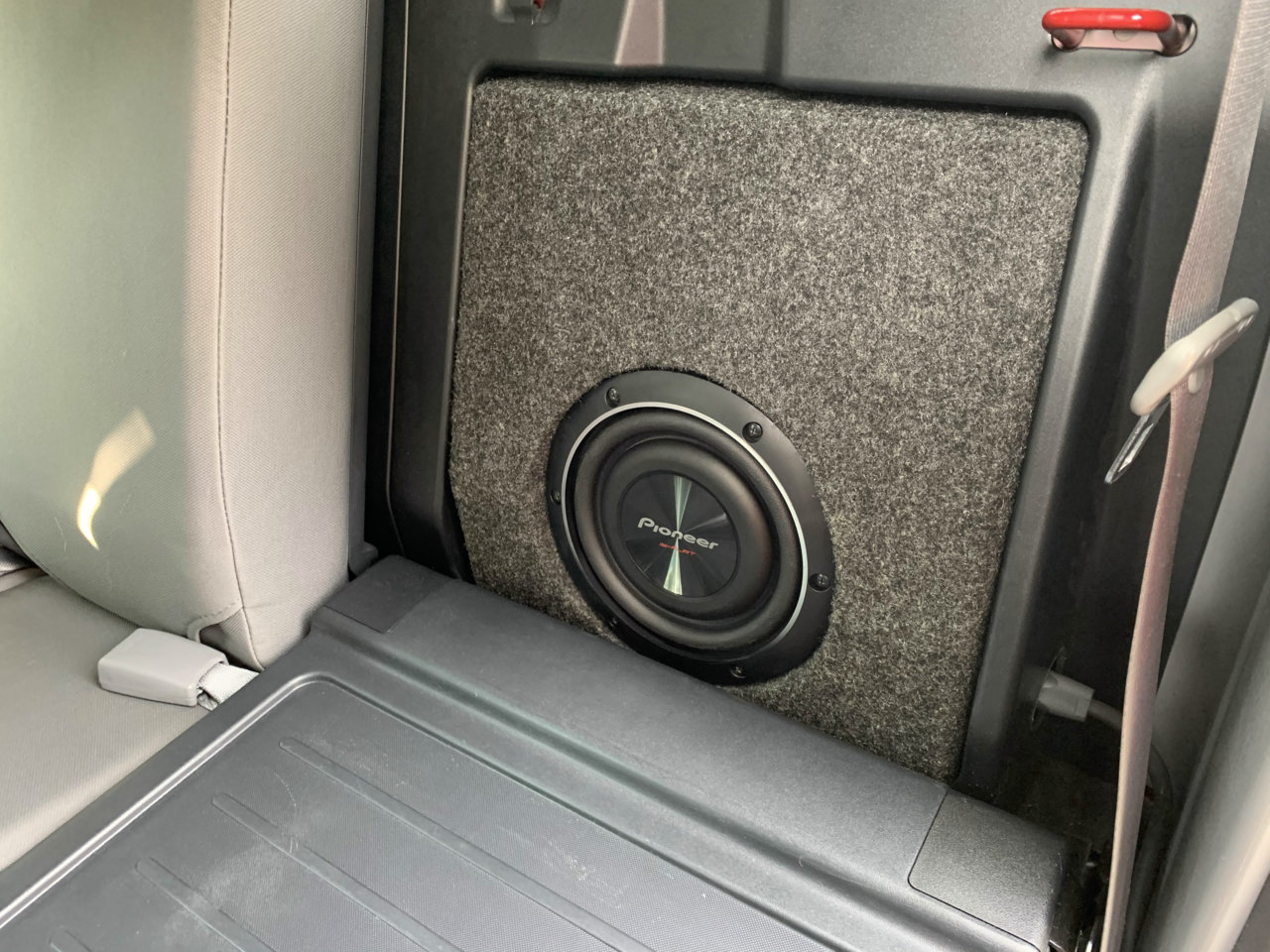

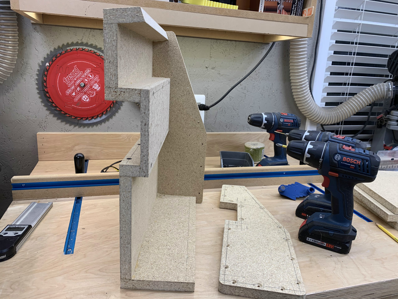

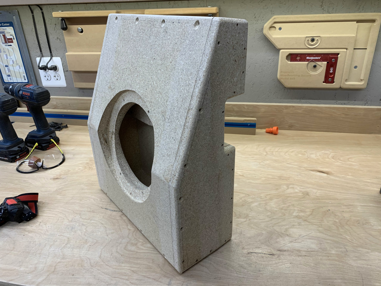

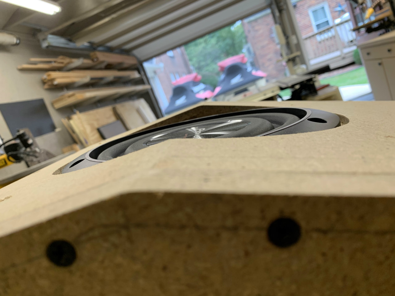

    Had a good Pioneer amp and Pioneer 8" dual voice coil laying around. Since I do wood working, I thought what the hell...the speaker needs a cabinet and I want more better bass. Always liked the MTX Thunderform cabinet the way it just sits in there and everything else behind the seat stays put. So I made one very similar. Wasn't a piece of cake by any stretch. The angles and there not being a flat surface big enough or with enough depth behind it made it challenging. Making a flat surface for the woofer to mount to between two angled surfaces was tough...but a couple of jigs and a long tracing router it did the job. Unfortunately after finishing I overlooked that the Pioneer sub woofer was rated for two ohms which made my amp (mounted under the seat) hot as hell. Since it was easier to switch speaker driver than find a different amp I found a 4 ohm Rockford Fosgate replacement. The amp runs cool and the whole system sounds great.
