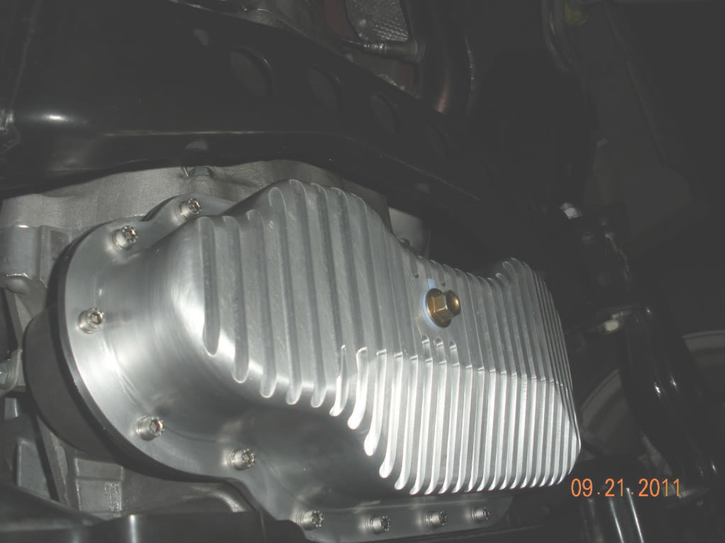

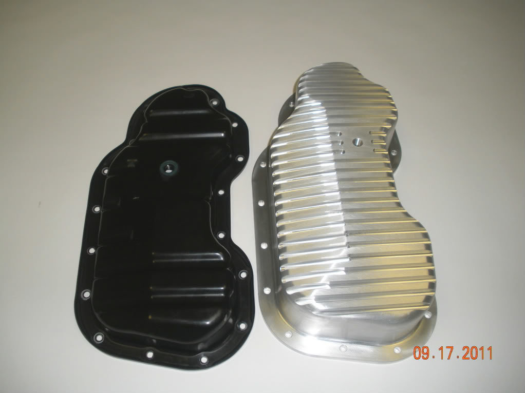

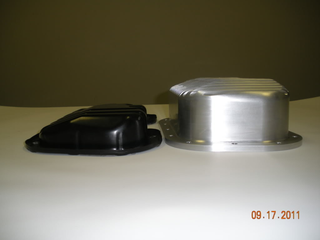

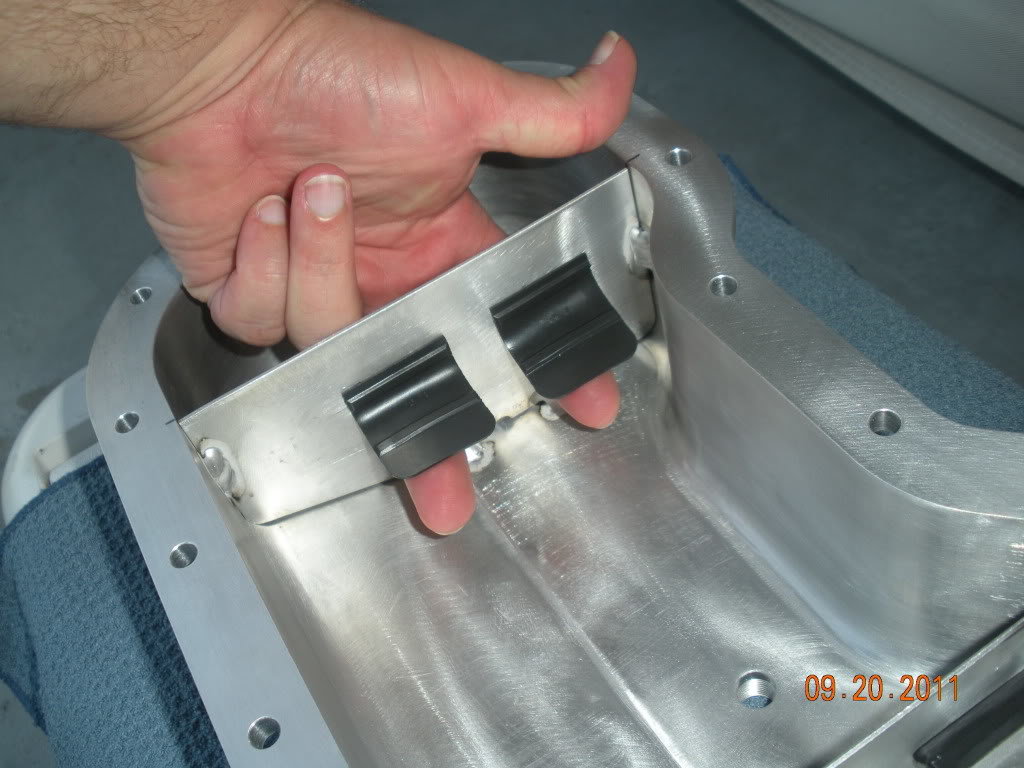

    I made this custom baffled oil pan. It holds 7 1/2 quarts.
    Compared to a stock X-Runner oil pan.

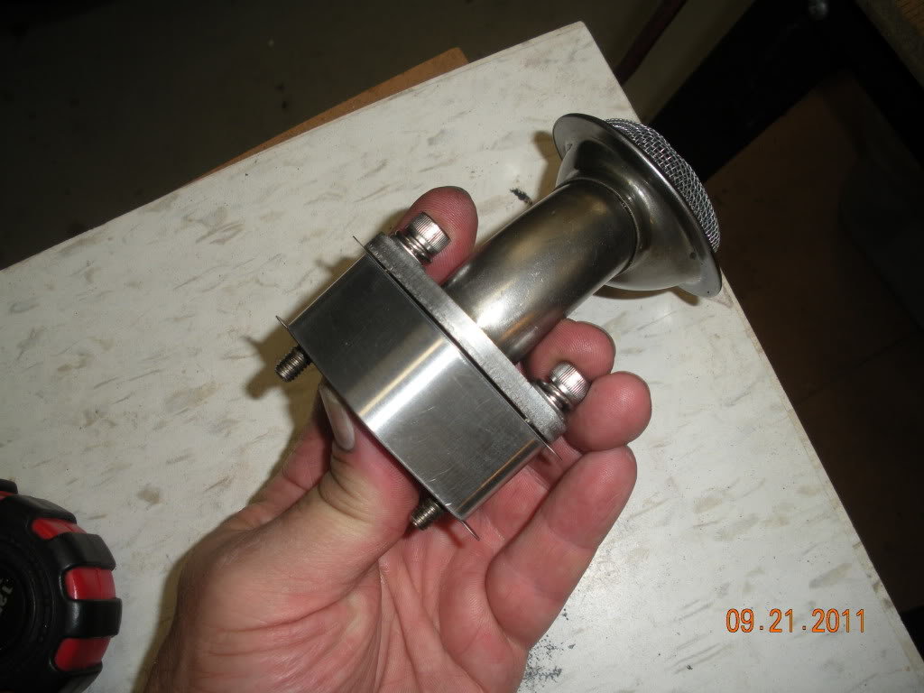

    Extended oil pick up tube.

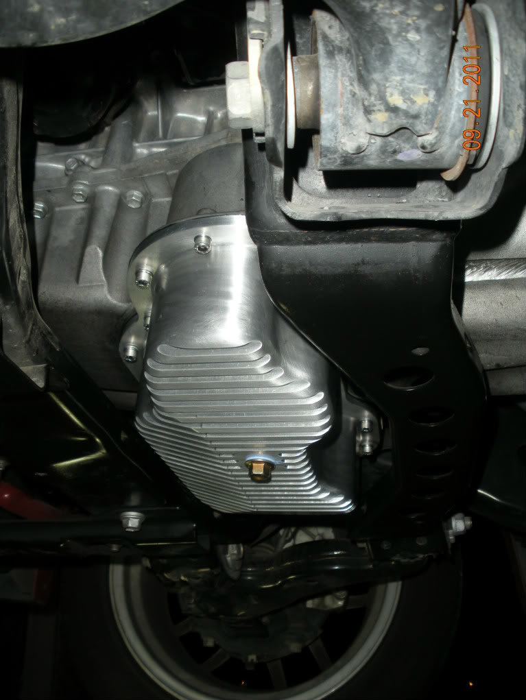

    Installed on truck.

    looks awesome!!! hope the truck is not too lowered, gonna be replacing alot of those.

    It tucks behind the crossmember pretty well.
    I am going to make a guard to protect it.

    That is one of the nicest pieces of work/good idea I've seen in a long time. If you could make it an inch shallower all the concerns about draging would be taken care of. I really like the way you put the heat fins on this bottom.

    My first one was an inch shorter. It tucks better, but you loose a quart.
    I am going to build a crash bar to protect it. I will post some pics when it is done.
