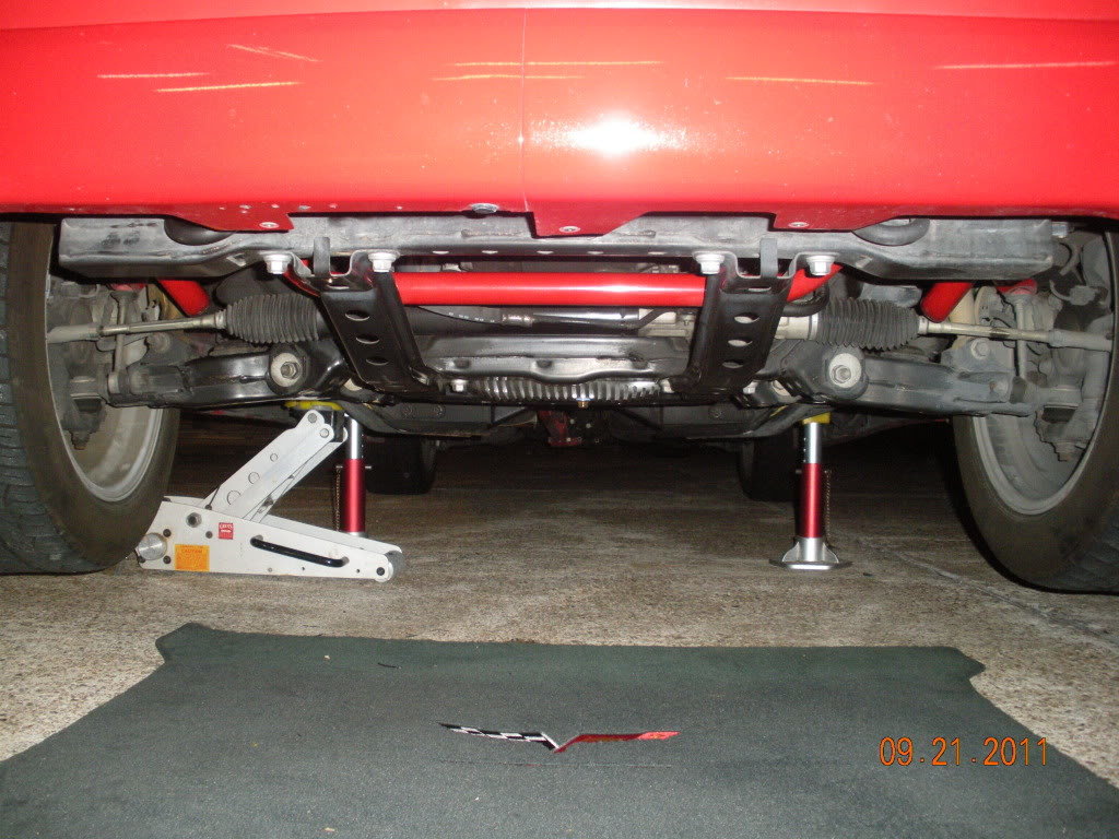

    I had it made. I took some measurements off the stock pan and the crossmember. I made some drawings and had a machine shop carve it out of a solid piece of aluminum.

    U are the creator of this good idea.
    But, I would choose to loose that qt. to get that drain plug up & out of the way. Any crash bar U put on will only lower the ground clearence more , causeing more bottom drags.

    If you go look at the pics again, you will notice the lower a frame pin points are lower than the oil pan. Also the two long axis structural members are about (not quite) the same depth as the oil pan. You do not need much to protect the oil pan from a front hit. Even as it sits, it will clear a standard 4" curb.

    i have to ask, is that a corvette trunk mat?
    i saw it and thought "what the heck?"

    My wife drives a Z06. This is the mat that goes in the hatch portion. Sun fades them pretty fast. I get the old ones and use them for working under the vehicles.
