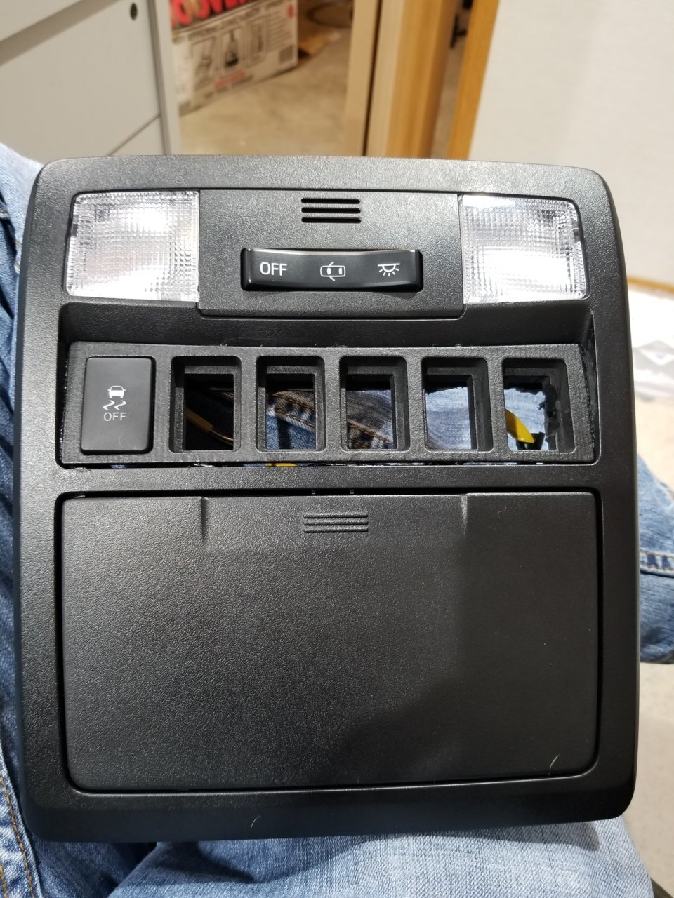

    Ordered this a LONG time ago. Then my dog ate it so I had to order another. Then it sat in my garage for months. Finally had a free weekend and worked to get it installed. Took advantage of the ch4x4 bla k Friday sale to order switches

    awesome! Not sure why there is a little gap along the bottom(maybe switch plate didn't get pushed down far enough?) regardless, once up in the headliner the black behind will hide it.
  13. Nov 23, 2018 at 1:16 PM
    #133
    VangaSTL
    VangaSTL Well-Known Member
    Oct 27, 2015
    #167889
    3,602
    Garrick
    St. Louis, MO
    2016 TRD Sport 4x4
    Yeah I dont know. I was wondering that myself. I realized the whole piece has a slight arch to it. I figured it was just normal from printing. I'm not too worried about it at the moment. I may get concerned once all the lights are on. If light starts shining through there I might try and take some black silicone and seal it up.

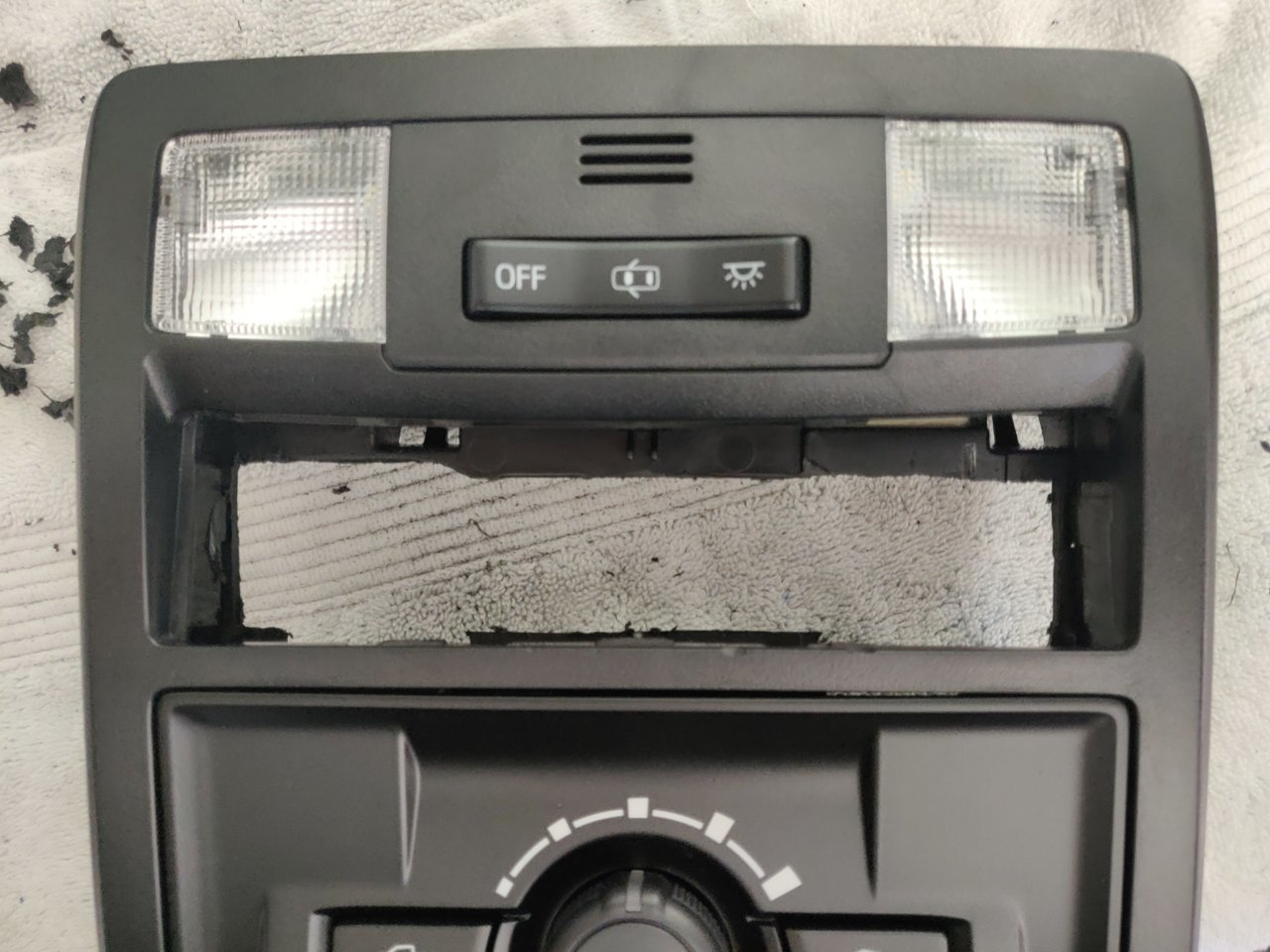

    Does anyone have any install instructions or pics of what they cut up on the inside of the console?

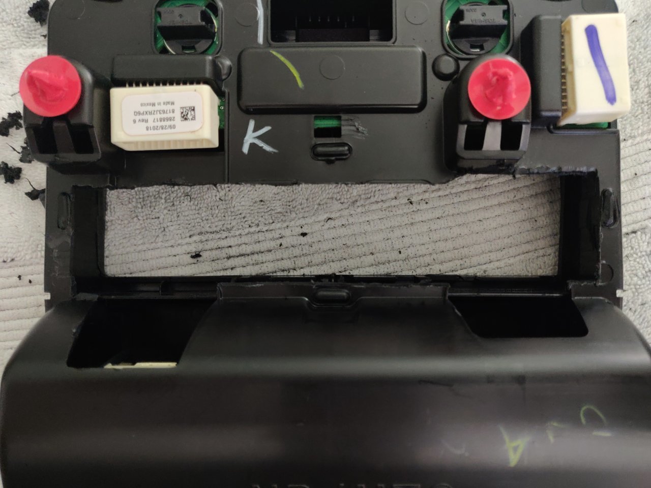

    Here you go. I took everything that protruded skyward on the back, avoiding those two heat welds to the left and the right (oblong protrusions). Everything within the space between the front and back cutouts was also taken. Be more careful than I was on the front. I caught the edge with the collet nut on my dremel and scraped away a bit. A couple layers of masking tape would have prevented it.

    Awesome, thank you! So the new panel just drops in and sits on a small ledge that you plastic weld it onto then?
  20. Aug 18, 2019 at 7:17 PM
    #140
    kecknj
    kecknj Well-Known Member
    Oct 19, 2018
    #269900
    225
    Nick
    '19 TRD Off-Road
    There is a ledge on the left side, but not the right iirc. The right I just fit in place and brushed the epoxy on from the back.
