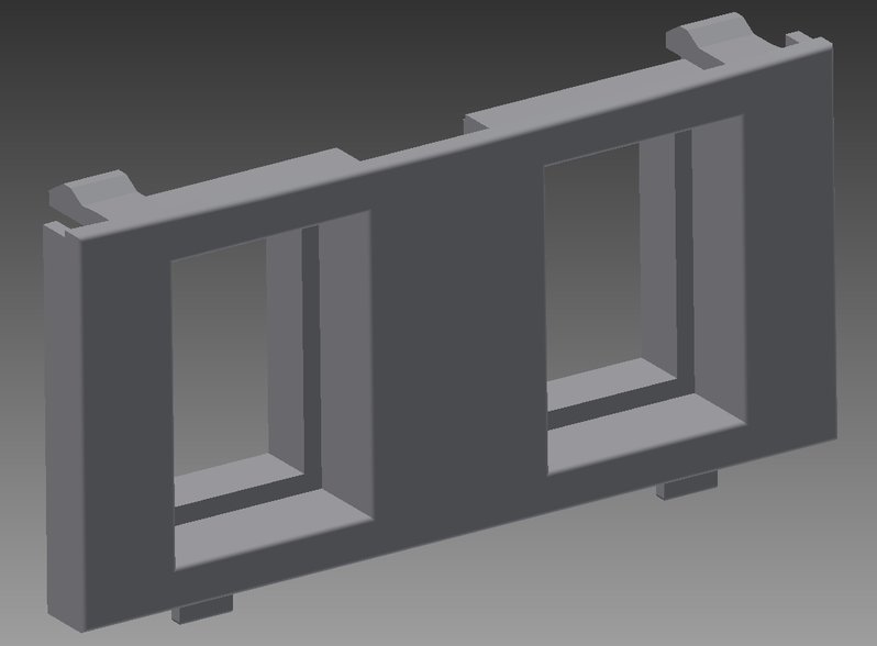

    Will the CH4x4 small push buttons work?
    So I got the switch you showed me on CH4x4, the small push buttons. Did you have to make an mods to make it fit or it slid in perfectly

    yes, the small ones should work, no mods needed. My panels are designed for them.

    Do you need to install all the panels or can I just order the venter panel?

    depends on your needs. You can do all or just a single one like the center piece. They will fit with oem panels.

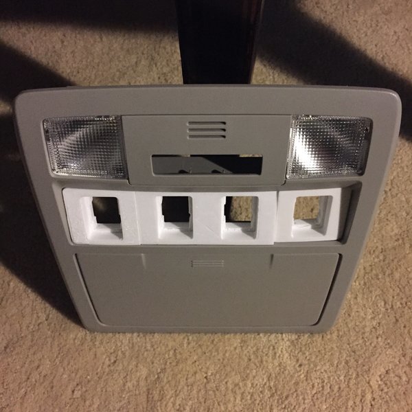

    I was messing around with the overhead console and found that you can remove that middle panel without have to cut the plastic welds off and opening the console. I used a flat screwdriver and just a little force through the two cutouts in the back housing and that middle panel just popped right.

    That is correct, the only reason one would need to cut the welds is to replace the blank on the right side where a sunroof switch would be located on some models.

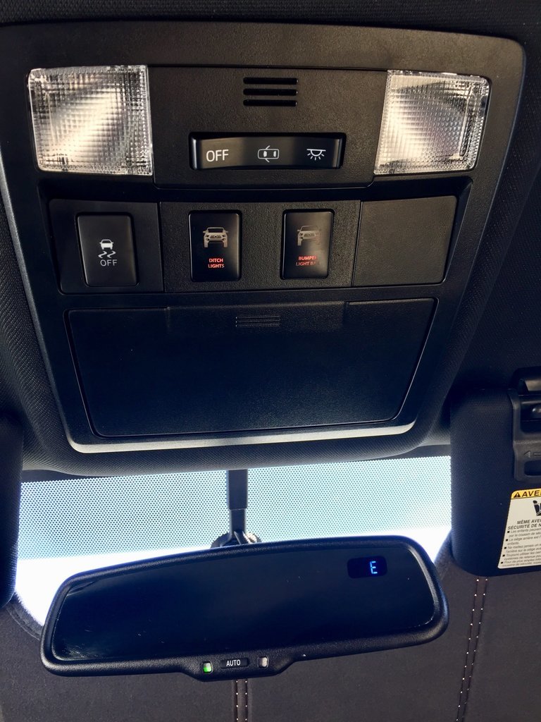

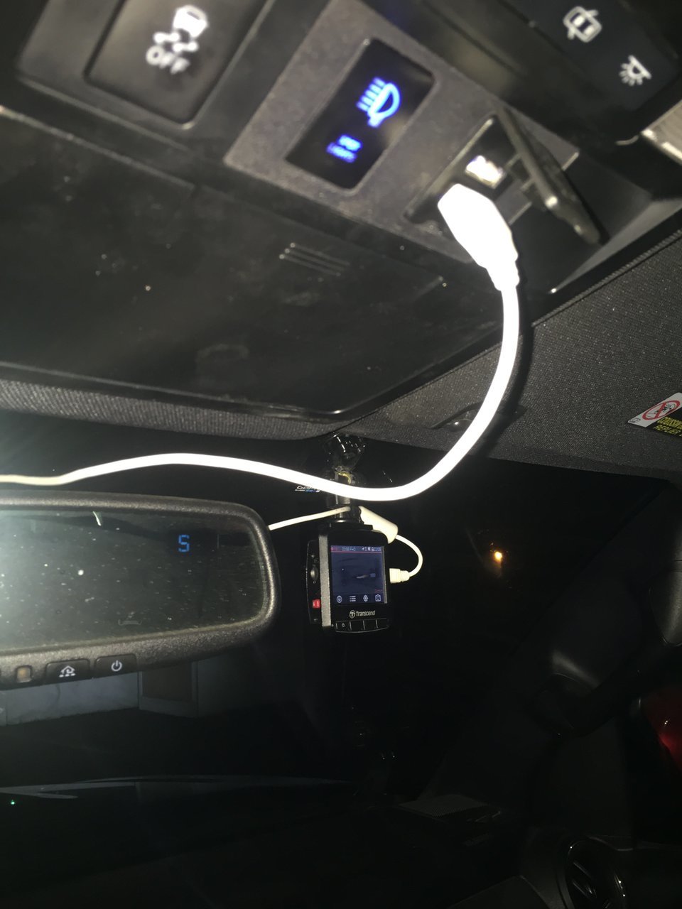

    Finally found some free time. Overhead USB always on, and ditch lights installed with switch.
