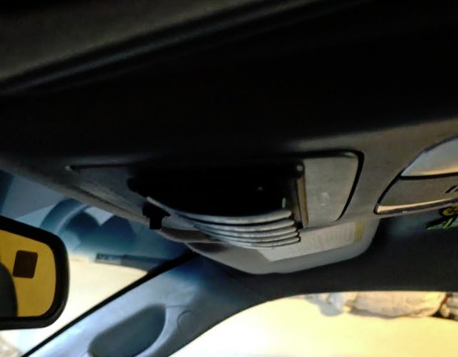

    @mesojdm You have a bunch of really cool items you have created. This is almost exactly what I am looking for... ...I put my Spod 6 switch panel in that spot and it does not have enough angle. Can I get one of these for a 6 switch panel in my overhead console? I have a Gen2 Tacoma (2015 Off-Road). I checked the site but didn't see one for second gen that would fit the 6 switch sPOD (or any). Maybe I'm just blind. Either way I have $$ and willing to buy just need a link on your site or a paypal. :)

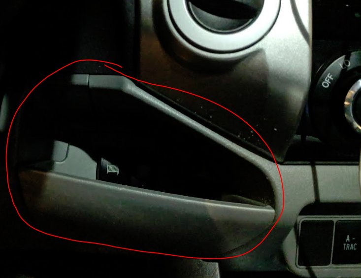

    @mesojdm I am also looking for something to replace this drawer under the steering wheel with a 2 or 3 switch panel.

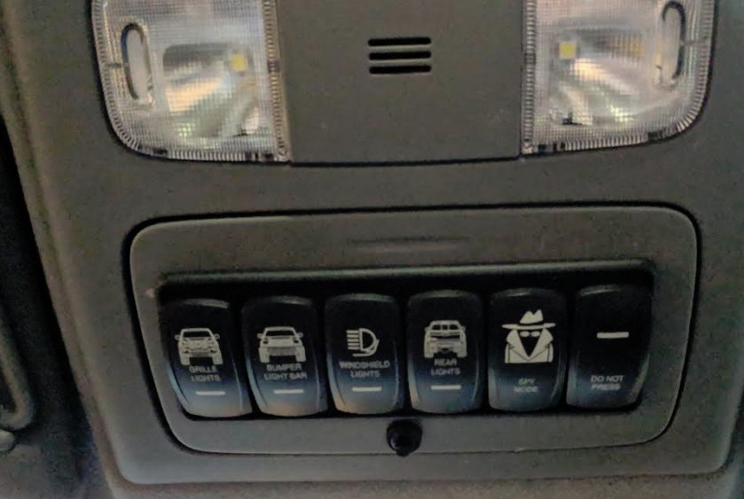

    Got mine wired up and working. Went with AOB red/green switches and used 2 Cat7 cables up the A-pillar for the outputs. Very happy with the results. I'll get some better pics on the weekend.

    Looks great. How did you attach it on the inside? Screw or bolt through the stock console into the switch plate tab?

    I drilled holes in the sides of the stock console and put M5 nutsert/rivnuts in the tabs, then an M5 bolt from the outside of the stock console into them. Feels sturdy.
