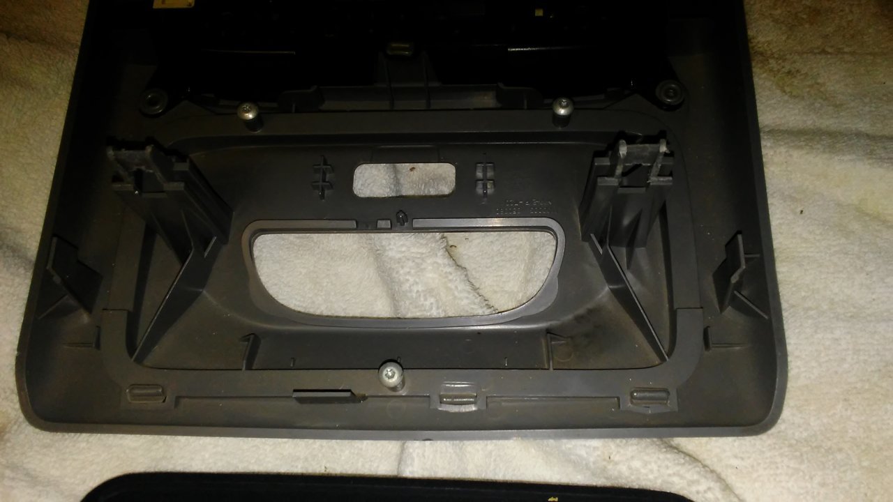

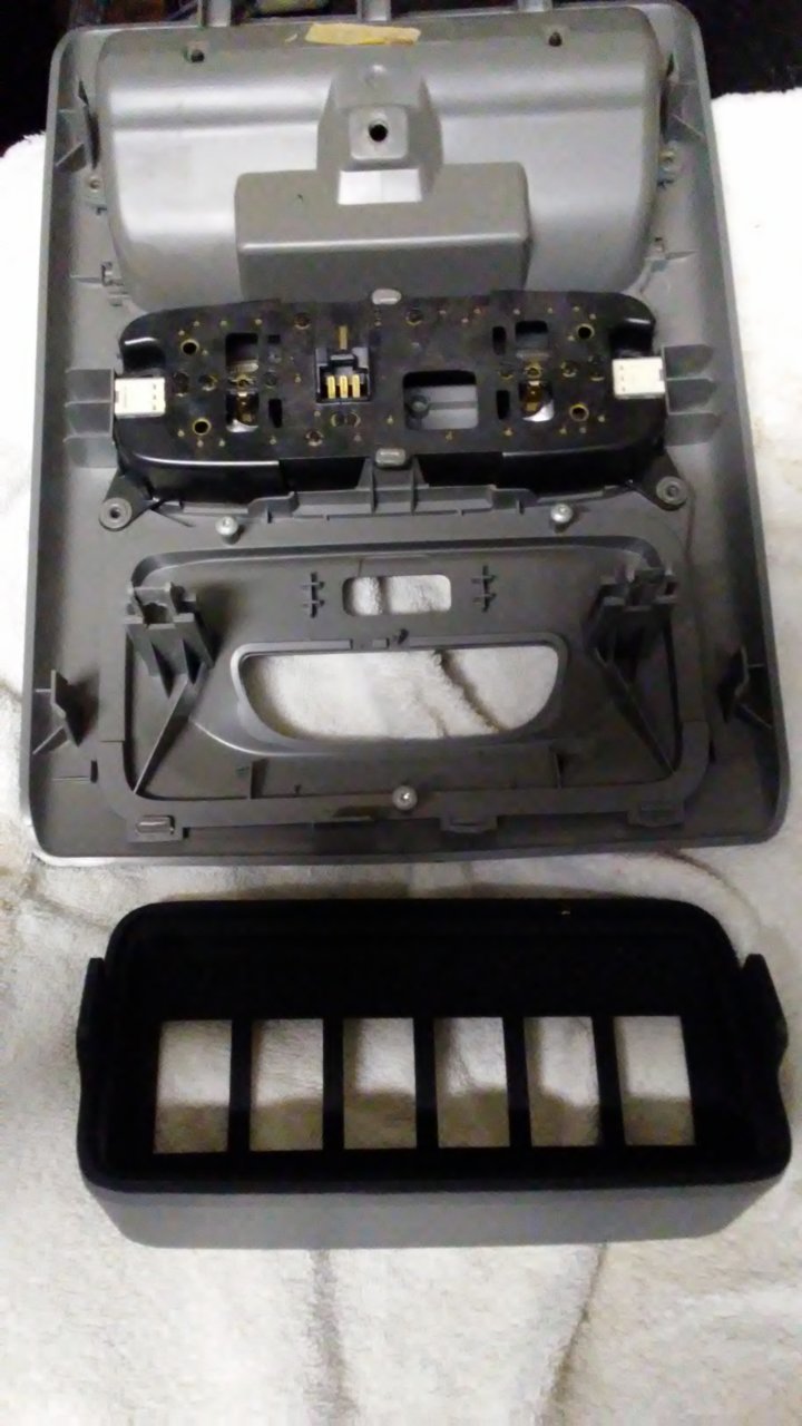

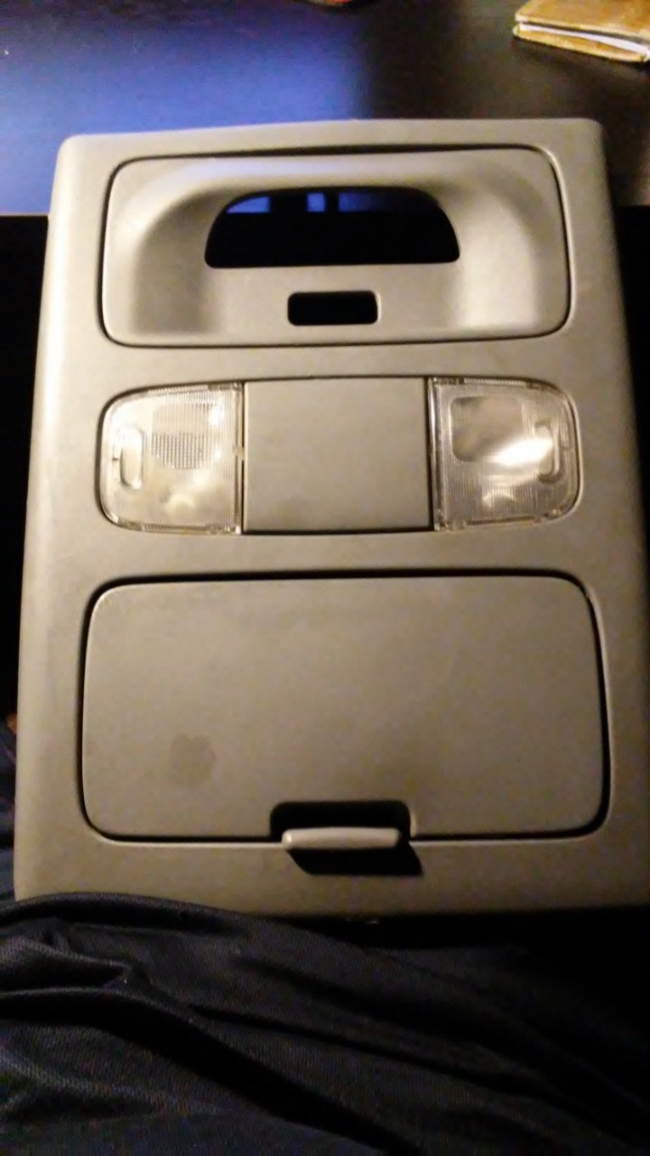

    Trying to figure out where to attach my switch panel where the digital compass/temp readout goes.
    I'm guessing I have the "old" style setup?

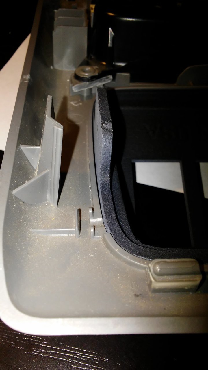

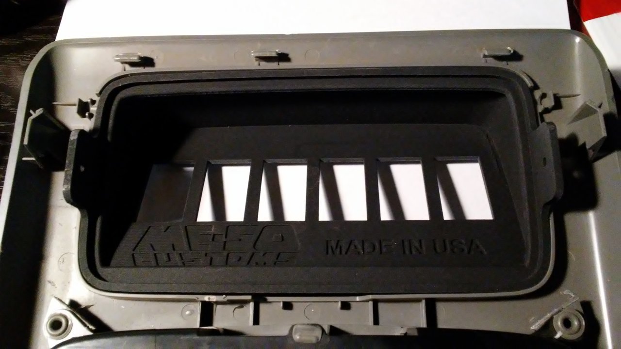

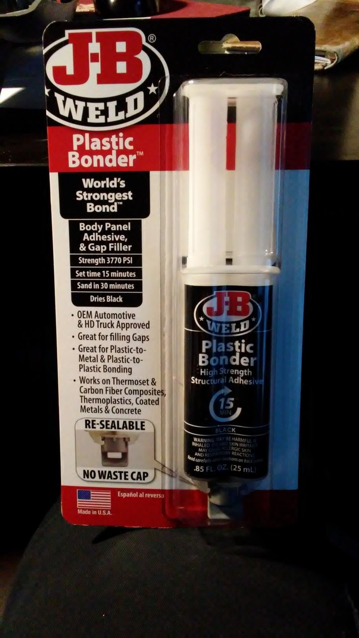

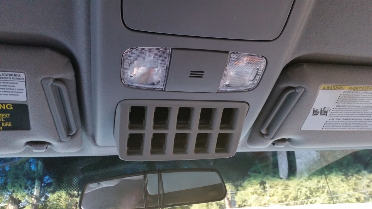

    I removed the old temp/compass assembly and just press fit the switch plate in. Now I'm sitting here trying to figure out how to secure it. The upright "tabs" on the overhead console dont line up with the tabs on the switch plate so putting a screw in across that space is not an option.
    I picked up some JB Weld on my way home from work.

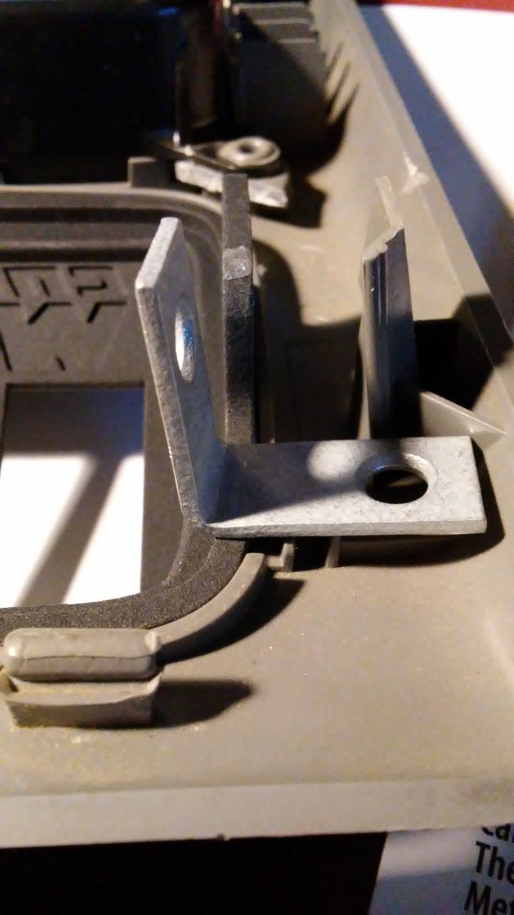

    I'm considering using 2 small modified "L" brackets with the JB Weld to secure the switch pl1557541057302301302973.jpg 1557541103283622092157.jpg ate.

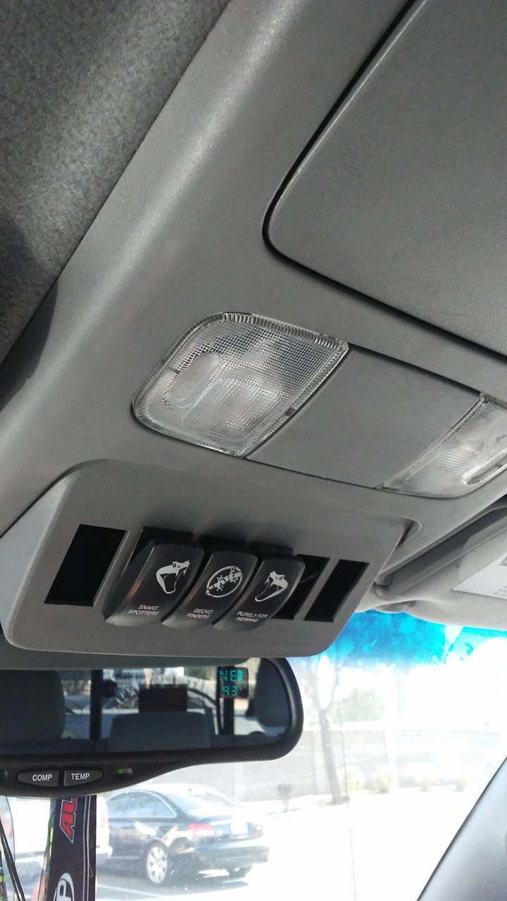

    I forgot to post a pic of the final product. Right now I only have 3 switches, but I hope to soon have all the spots filled. 20190611_080228.jpg

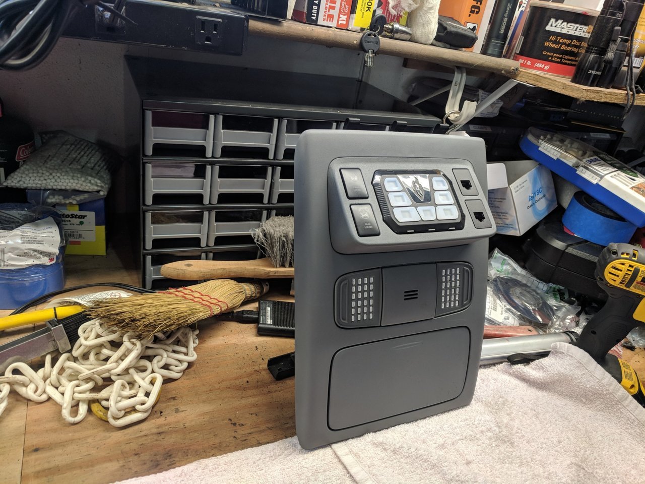

    Finally making some more progress....

    Looks like you're done!

    That is clean AF

    There’s a bunch of wires to run and solder....:frusty:

    Look up stinger SPEEDWIRE. Run only 1 cable

    I would of never thought to use that awesome idea and good thinking outside of the box.

    Gotta ask, what’s the center locker switch and fuel pump? Unless you description of vehicle is wrong.
