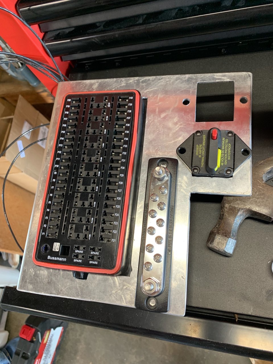

    I talked @Sharkfrog into one and myself in the process, so I already have one, plus I built a new bussmann to go with it

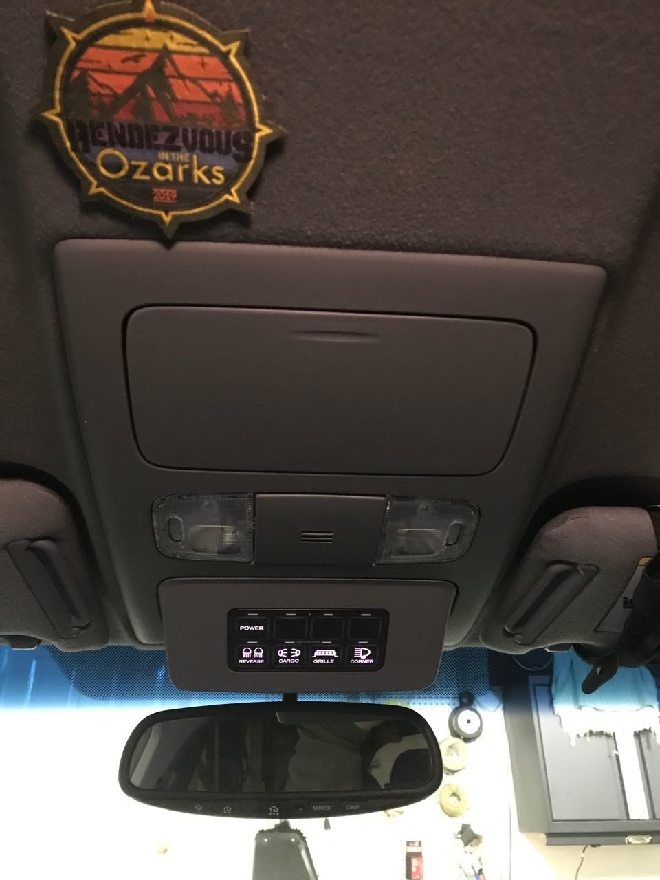

    Got it yesterday! Installed it in my 2.5 gen Tacoma. If you install the switch-pros version in the first cubby, you can't get to the screw that holds the console in place. I opted to install in the second. Can't think of a negative, except that I have to pull my RVM down a bit.
    You do have to cut away some plastic and a little gear that smooths the opening of the glass holder. So, no going back to stock, but you can still pop the holder back in place. It'll just fall open once you push on it to open it.

    Here a picture. I don't think there is one with the SP installed.
