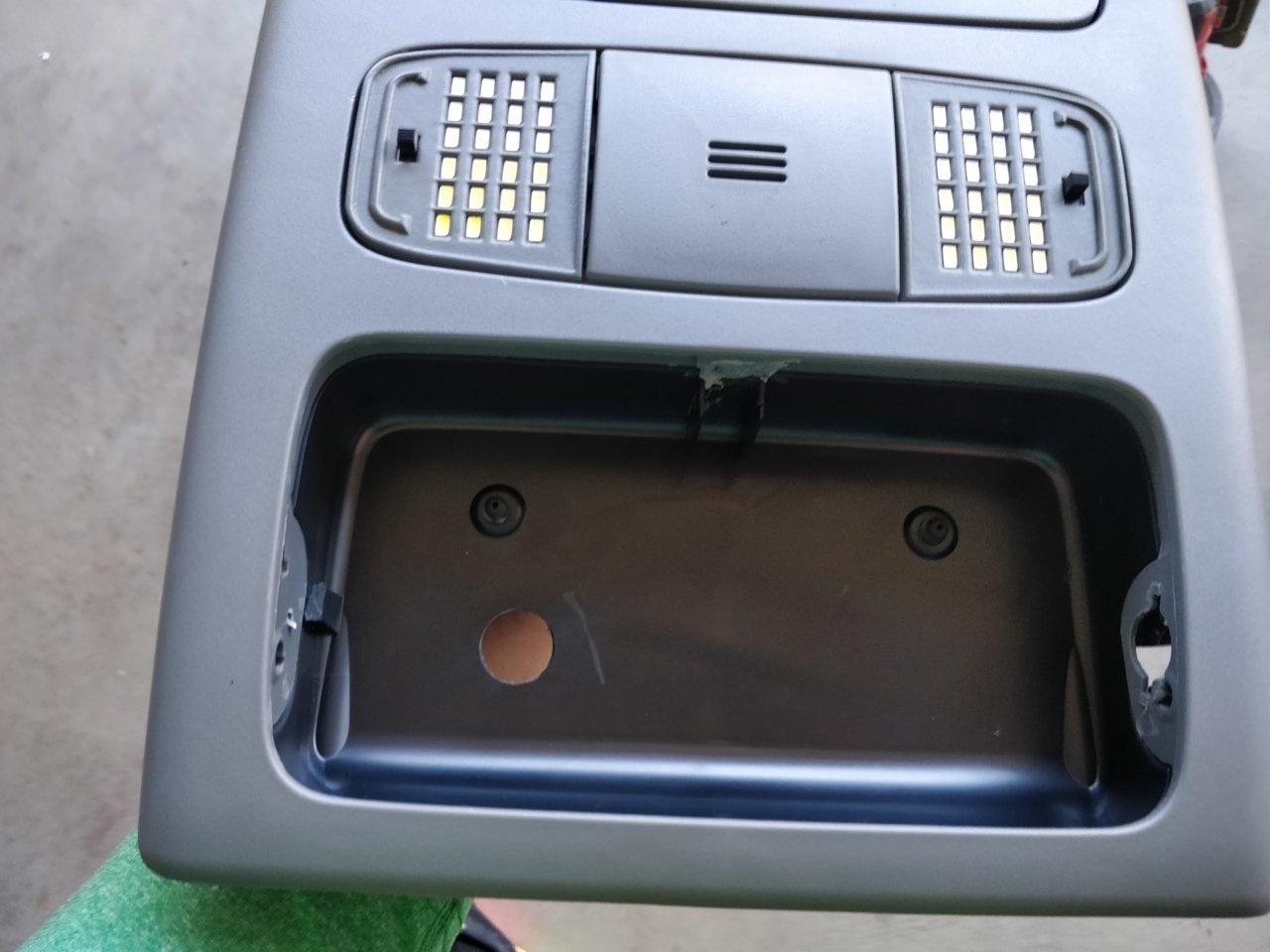

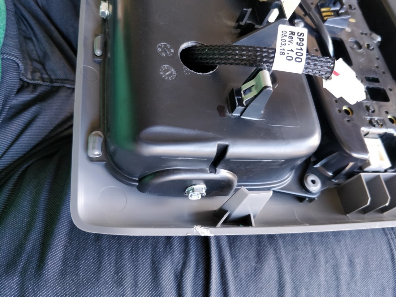

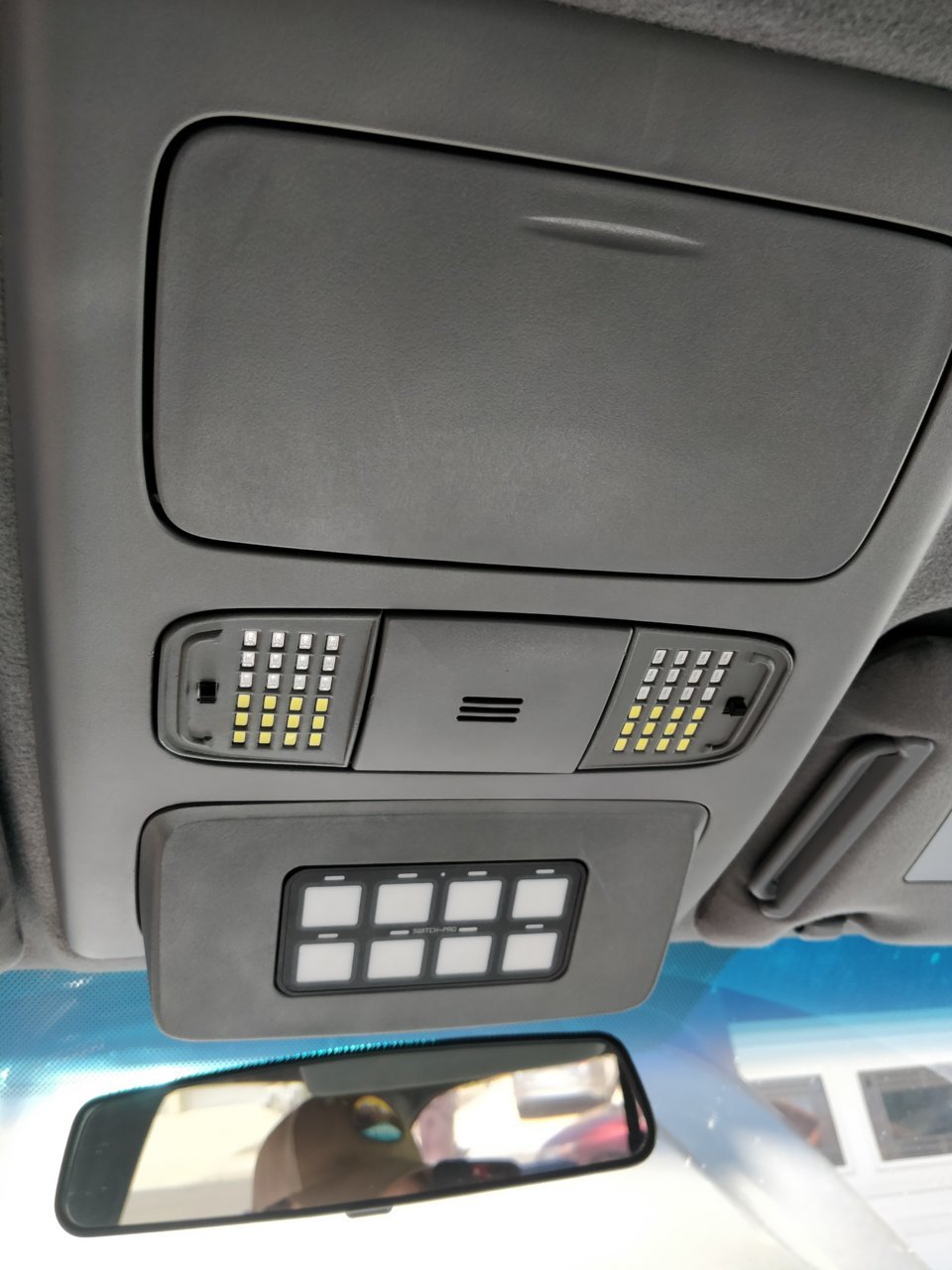

    Installed the SwitchPro mount today. I have a 2015 which has 2 sunglass holders so I mounted it in the forward one to keep access to the mount screw.
    Pulled the sunglass holder and used a Dremel to grind the latch on the center and some plastic on each side so it would sit flush.
    Drilled a hole for the harness to come through.
    Drilled holes and used some course threaded screw to hold it in place.
    Reinstalled the panel and it looks awesome.

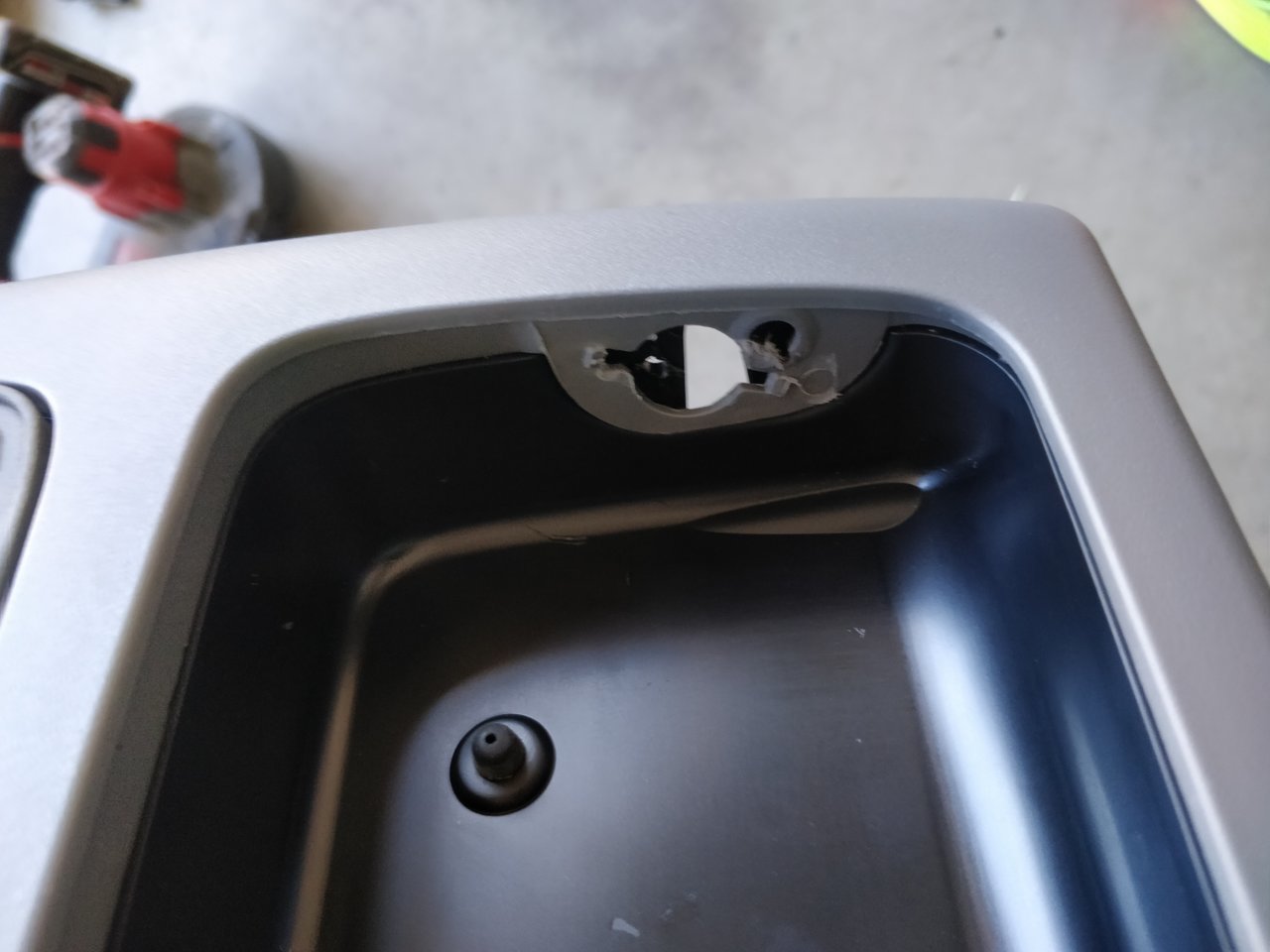

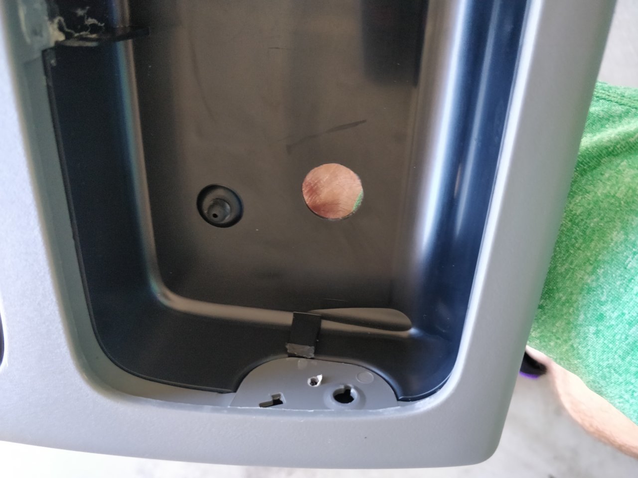

    Hey guys, I'm getting stuck on what's probably the easiest part of the install, how do you remove the sunglasses holder? I've read through all of the pages here and havent seen how it's done. I dont mind cutting up the plastic behind it to fit the switches and wiring, but I dont want to cut up the sunglasses holder to get it out in case I end up going back to stock or moving the switches to the other opening.

    Open the sunglass holder portion and there should be a screw up in the center. I know in later models this may have changed. Once that screw is out you can gently but firmly pull down on the portion closest to the windshield.

    Or if your talking about the actual holder I cut the tabs. Unfortunately there aren’t great ways to retain it. Some have had luck heating it up and removing.

    I pulled the whole console out, it's just getting the sunglasses holder itself out. No matter how I try to squeeze or wiggle it out, all I'm doing is flexing the plastic. It looks like it was placed in, covered with the plastic backing (the part that gets cut up for electrical work), then that was sealed on with what looks like plastic "rivets".

    I've got the compass, but I'd like to replace it with a scangauge. Definitely right about switches though, I think it's the best place on the truck. I ended up using a thin sanding disc on a dremel to take off 1 pin, left it in the console, and slid the holder out. If I really feel so inclined as to use the front pocket or delete it, I can JB weld the pin back on and it'll be 99% stock.
