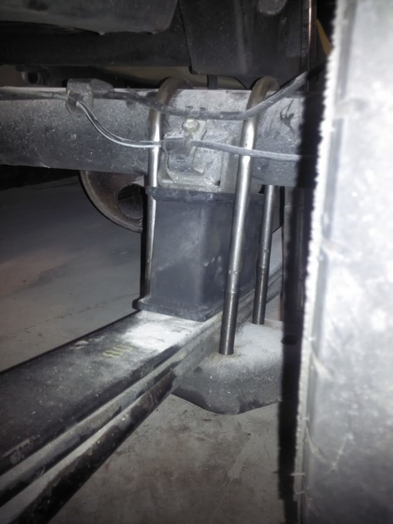

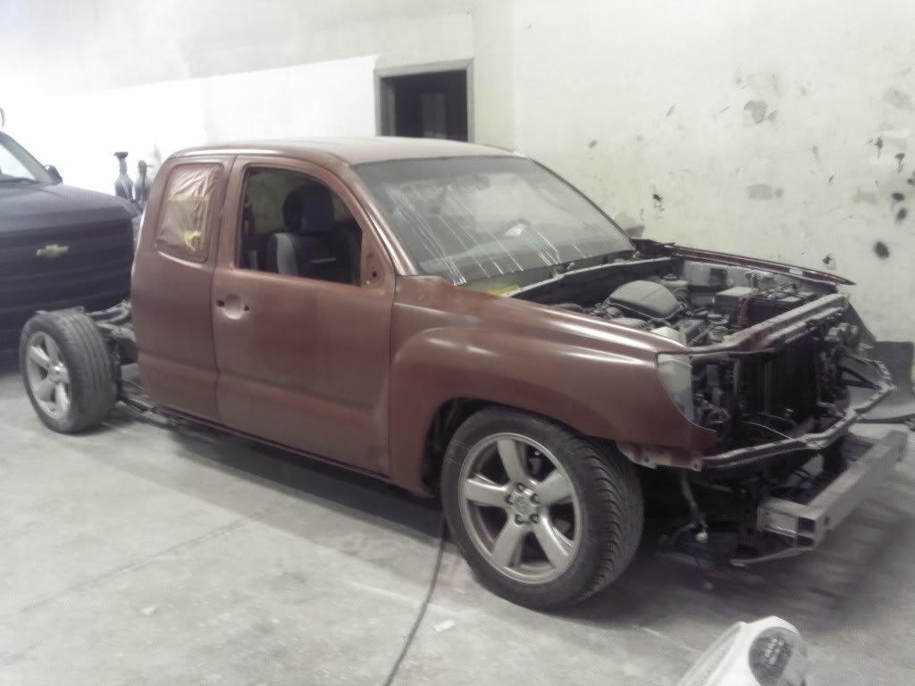

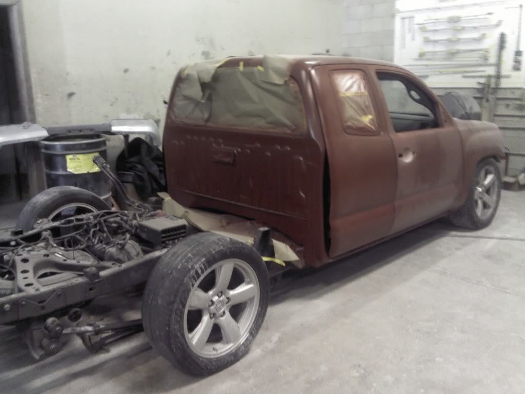

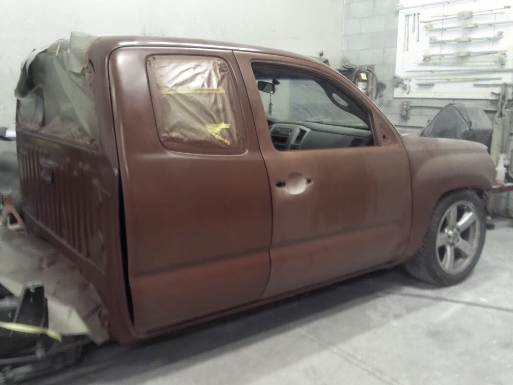

    I was in the area so I thought I'd stop by and take some more pictures with the doors on and cab fully sprayed with the base.

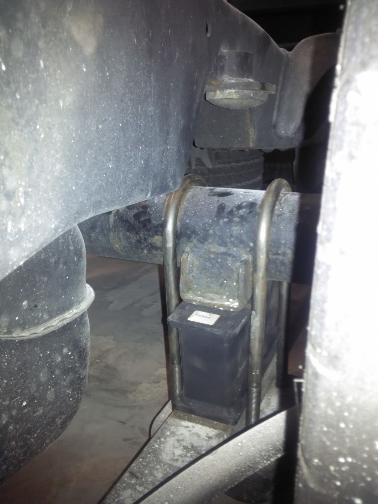

    Since the bed was off, this was my chance to install the custom u-bolts and 4'' blocks I purchased a few months ago from "BEEFED TACO" I swapped out the 3 inchers so my truck sits leveled with the lower front.
    Oh and here's a nice shot of the great work Brian aka beefed taco fabbed up for me a couple years ago. I've been driving the taco daily ever since and everything's smooth since day 1! Custom welded C-notch with custom bump stop mount, and with reinforced back metal plates.

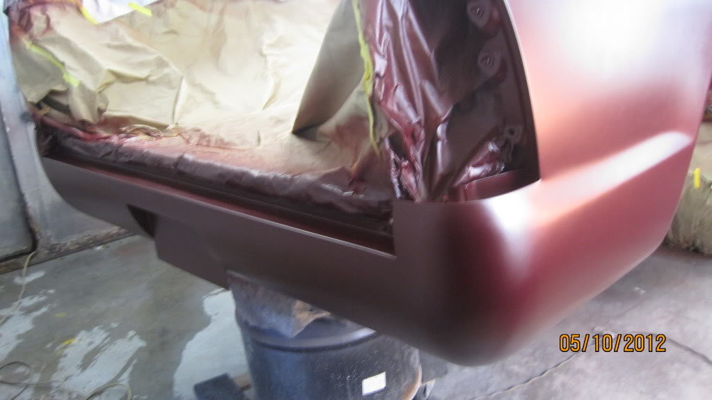

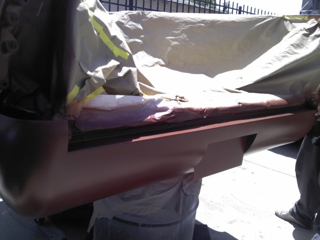

    Nice rollpan.. is it a Grant custom or did you have it fabbed yourself ?

    That's a great looking stance! looks like a 3/4 drop?:notsure:

    I believe you can get away without a notch if its 4'' or under with QA1 shocks
    Its from Grant Kustoms. Superior quality but took about 3-4 weeks to ship out.
    Front: OEM X-runner Coils, 1.5'' Custom Drop Spacer, DJM Upper and Lower Control Arms, and OEM X-runner Bilstein Shocks = approx. 4.75''-5'' Drop
    Rear: OEM Pre-runner Leaf Springs, QA1 Shocks, 4'' Beefed Blocks, Custom Beefed Notch w/ Bumpstops = 5.5''-5.75'' Drop

    Yeah i thought it was.. there pretty nice my freind lenore has one on her X-Runner..

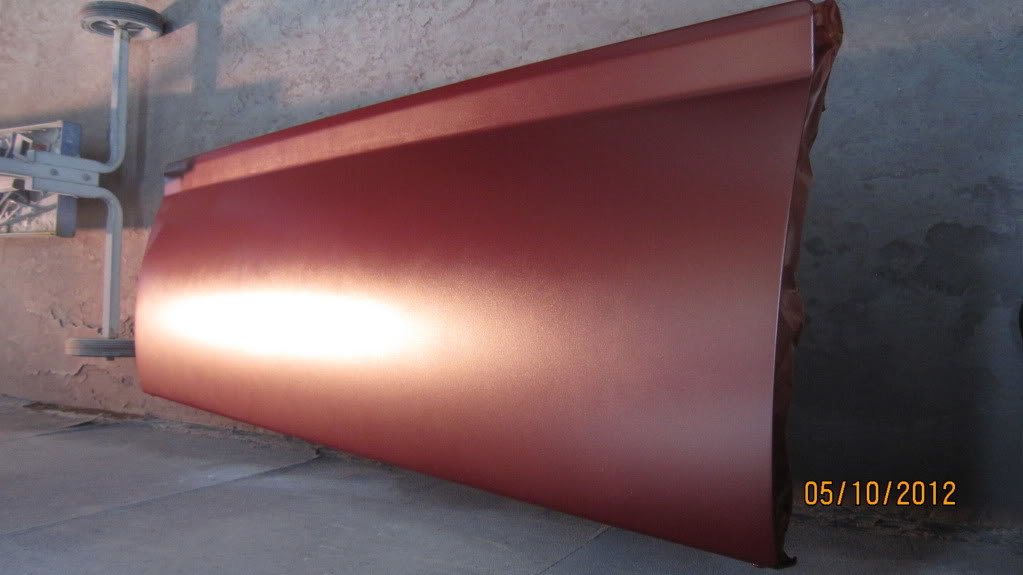

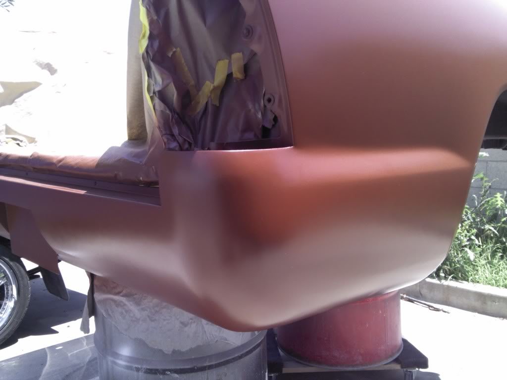

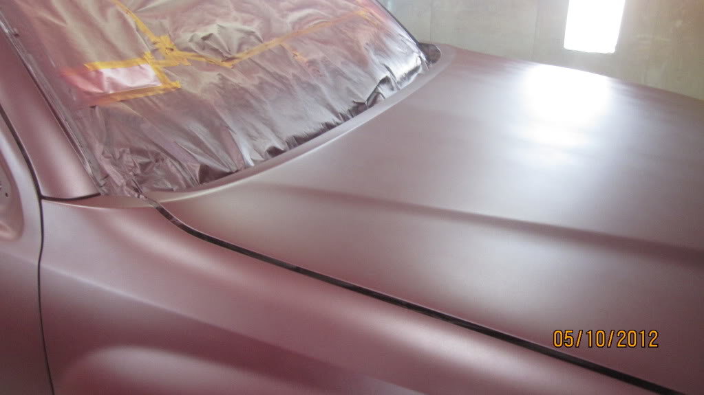

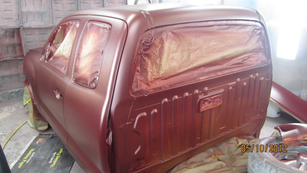

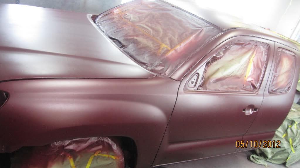

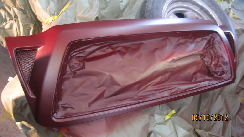

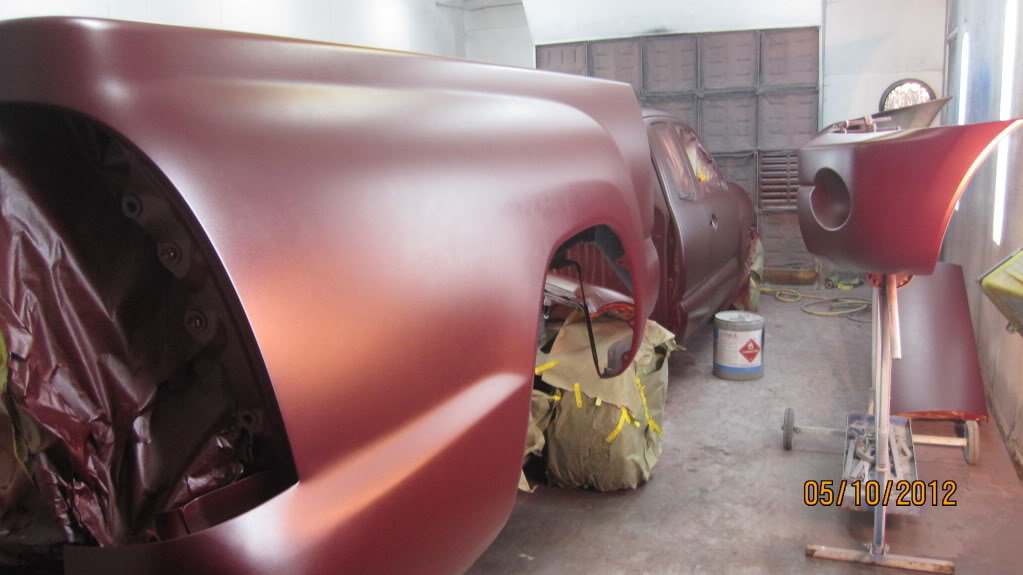

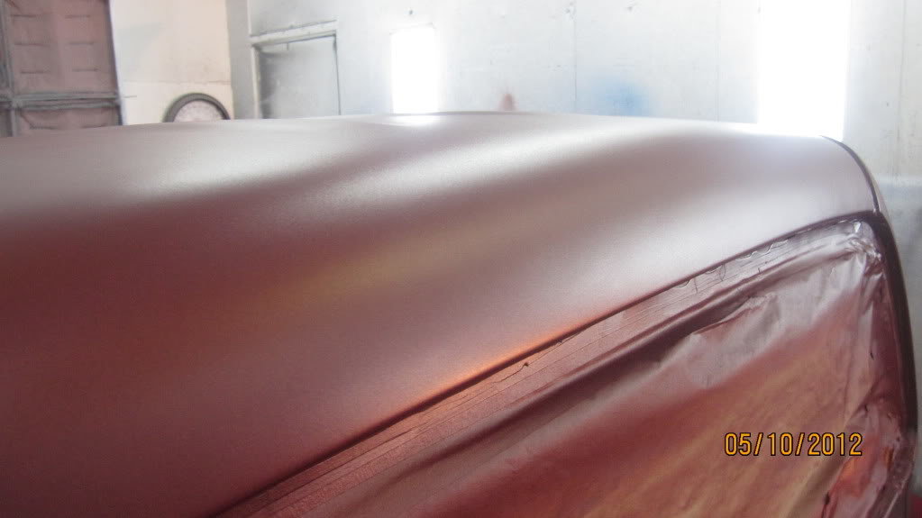

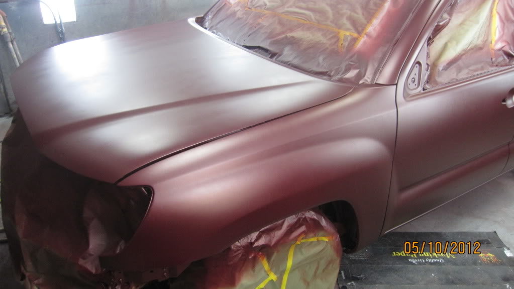

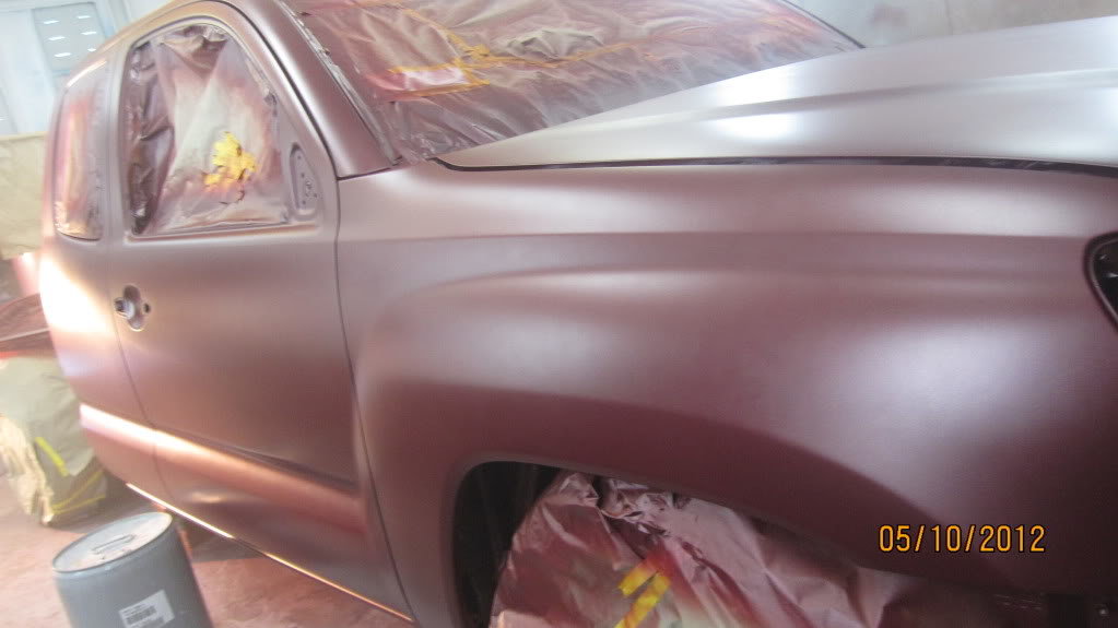

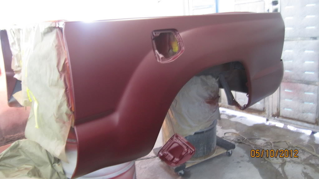

    Finally some shots of the first pearl/transparent coat. I'll have more after they spray the final clear coat stage.

    :drool: sick!

    I'd leave it like that with a matte clear coat. :cool: I like it a lot.
