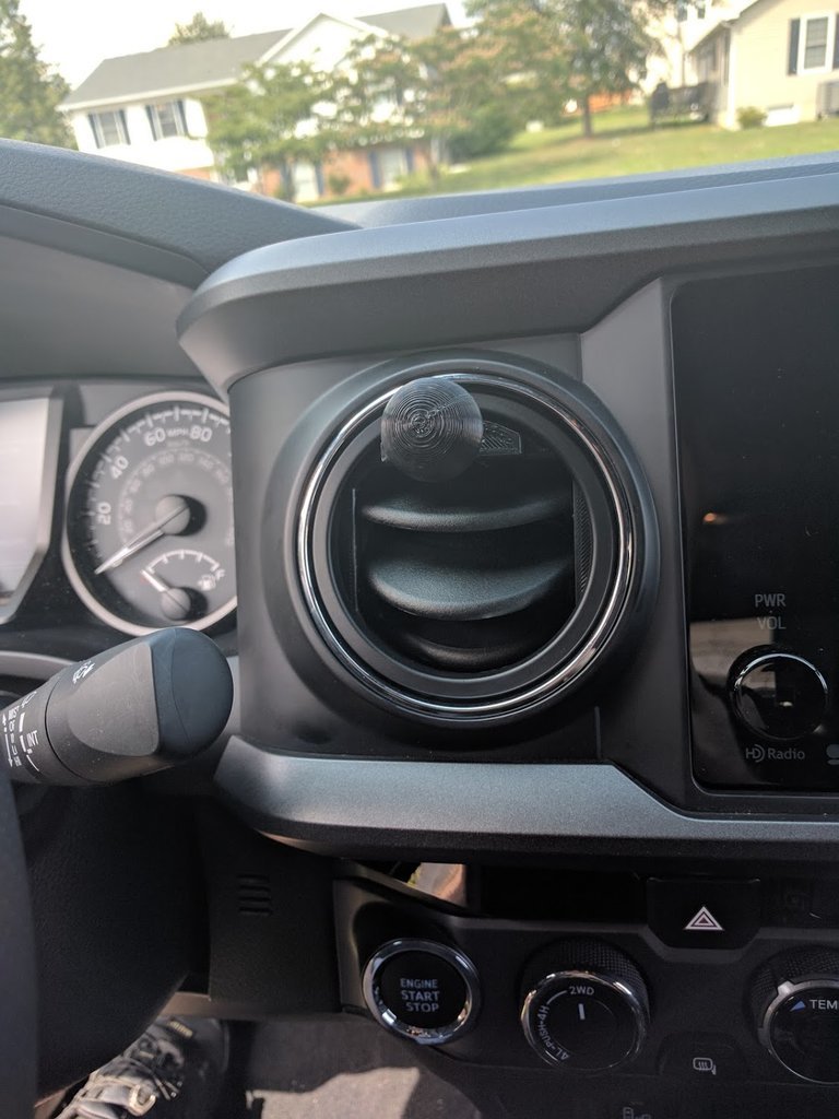

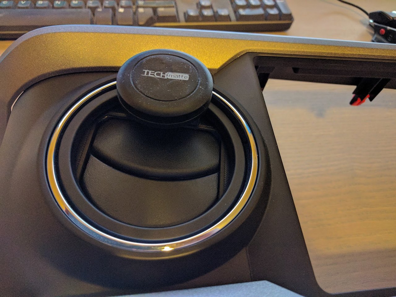

    Brand spanking new...
    Actually I went this route because I didn't want to tape anything to the dash, to me that's more permanent than my design. This simply sits between the vent and the bezel, nothing is permanent, no physical modification to the track what so ever, simply a spacer. If I want to remove it, I simply remove the panel, remove the vent, take out the spacer, reinstall in the "default" manner, and bobs-your-uncle. No glue or tape to remove after.
    That is a nice mount though, kudos!

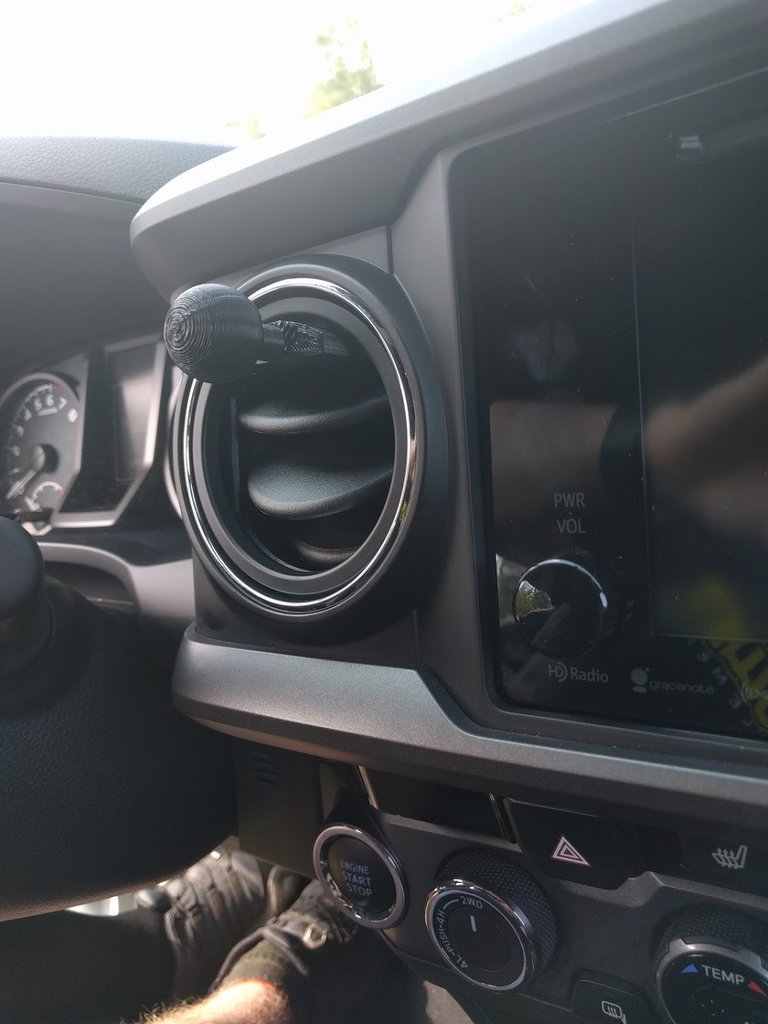

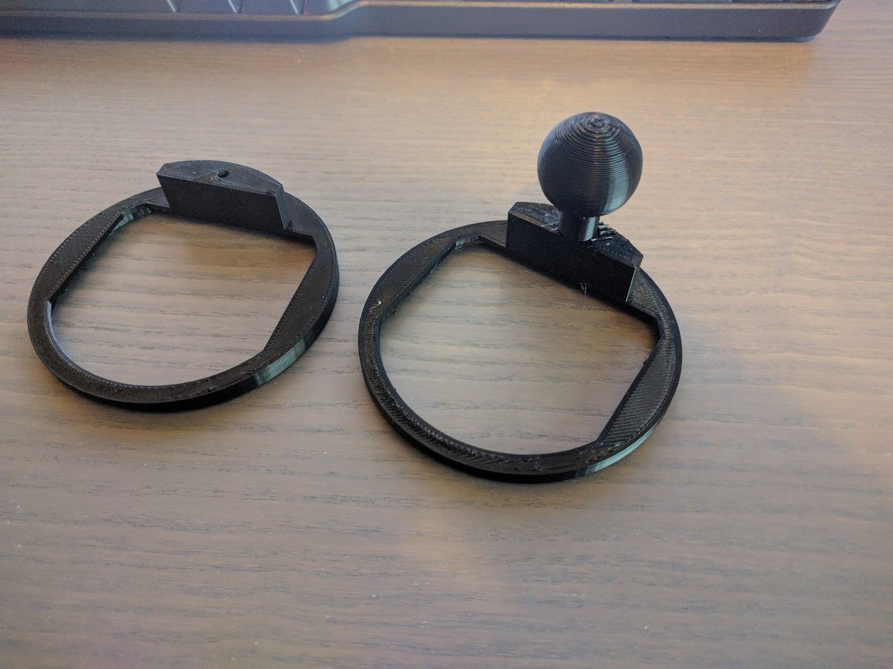

    **UPDATE**
    Decided to attempt a RAM mount (1" ball) but the bolt on version looked like it would be a bit much to mount, so for a concept, I simply printed a version with a 1" ball on it to test. I know up-front this isn't a design I'm interested for my own needs, but know others might like it.
    P.S. all prints have been prototypes, so speed has taken precedent over quality.
    eFetL_Z_fIxFgp6WkVtbIiQhP3zQTPWpaz8MzePE_e9b6f19e730a2c567f9130aa98015bbd91752f55.jpg
    LTIgfDqI3q8kE0Tk2Ej_W5lKUrkujVrtwMCp_Zoq_8a4f7fb4f4b857f860de218b89e7ec3b182c2845.jpg
    I already know it sticks out a little far, but wanted to test for clearence, etc. I can probably push the "stick-out" back in ~0.500"

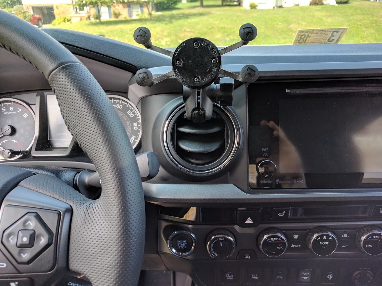

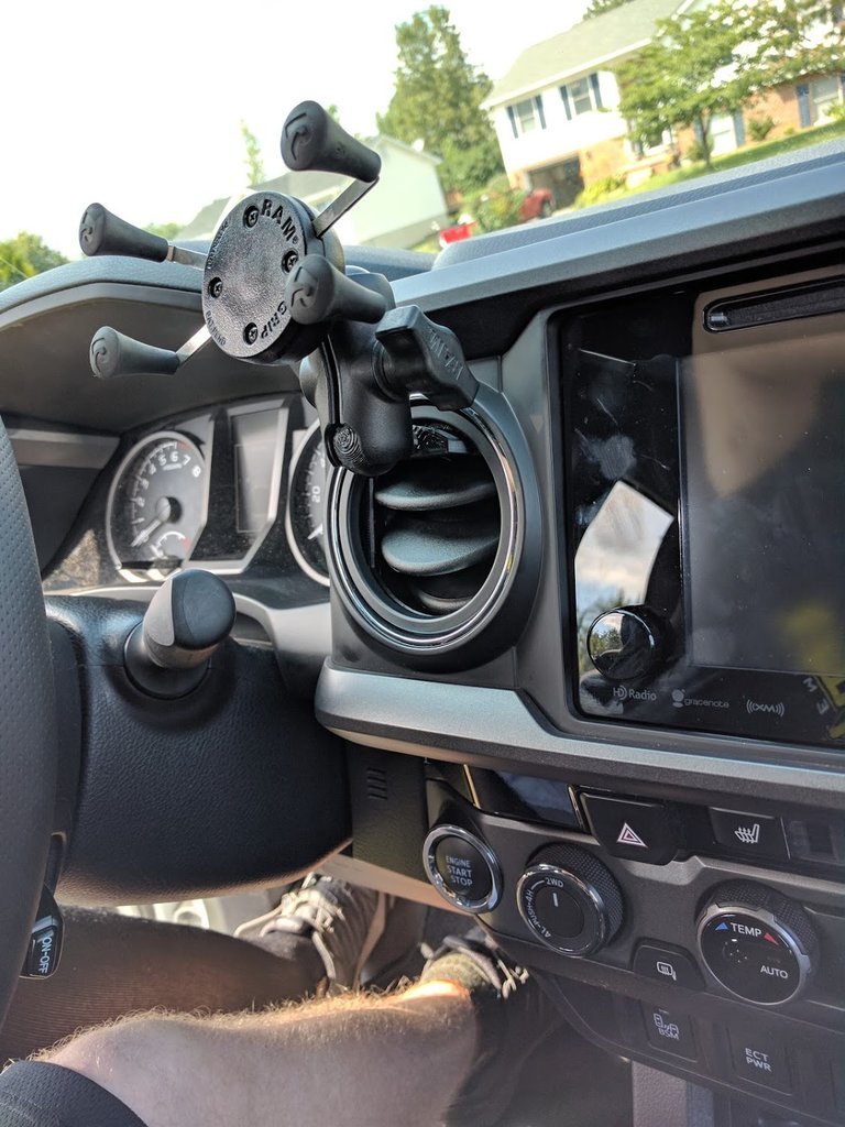

    Here it is with a RAM X-Mount (small) - this is the only RAM product I own (for the street bike).
    dSTI2so8ZjSzEPXChY4PS6wL6JMDcw4TB0brAAwv_693c5adf2896e7b136c314ce3232baa66dd662d7.jpg
    cbNfGpY6CEGbxMp0W0a2mFUmh7N76gozmpNu8FaM_a524a8f87f7ab9e84c515d757cefc03084be9a74.jpg
    In the photos I have it positioned in the top, as that seems the most reasonable, but it can go anywhere really. Looking for feedback.

    IMHO, the (ball) Ram Mount option will give the user more options for devises (cell phones, small tablets, etc) vs. the magnet mount (looks like it could only be used for a cell phone with a thin case). I think that either direction that you decide to go with; folks will like it. I do not know how difficult it would be to offer both options, or maybe a bundle option. Great job on the prototype though.

    i agree. i need full vent opening and control, and keeping the ball at that position is probably ideal, or that's how it looks from here. could be a winning combination.

    Thanks for the feedback, I do agree, the RAM (ball) option is the most versatile, but detracts from the "low profile", hence why it's not my favorite. As far as printing, it's really no difference at all. I'll need to do some more "final" prints with the RAM (ball) option to test strength, and get the stick-out right. Need to grab some more stock to cut something out of aluminum and test that as well.

    Just FYI, That RAM mount is going to HAVE to be machined out of Aluminum... I have printed a far beefier version out of HTPLA, ABS and now nylon and all melt and bend during the day as the truck heats up (its been in the high 90s)

    Thanks for the feedback and evidence, I was curious how nylon would hold up. My goal is simply to prototype on the printer, if anything actually comes of this it will either be milled, or injection molded (glass-fiber reinforced, etc). I know without big money and equipment I have no access to, 3D printing is not a production means, at least not for these types of applications. In addition I realize the forces on a RAM design are going to be far greater than the basic magnetic design of my original - this is one of many reasons why I continue to not want to go that route, but still see the demand from others.
