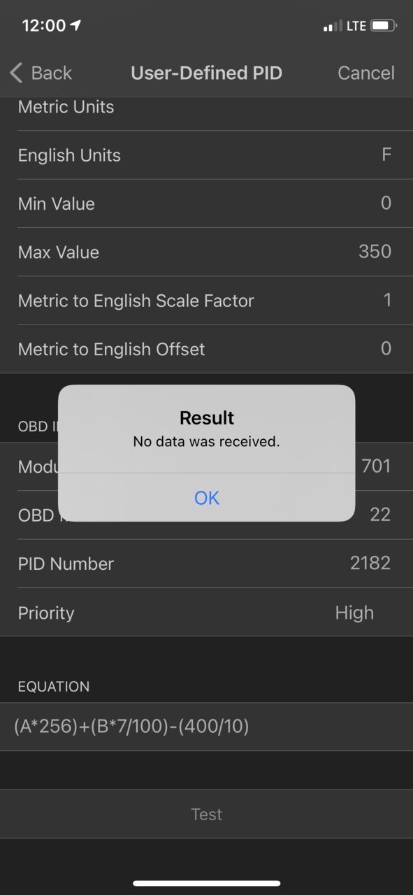

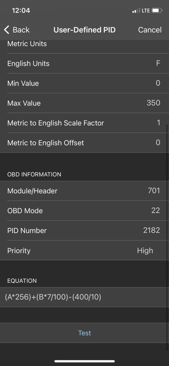

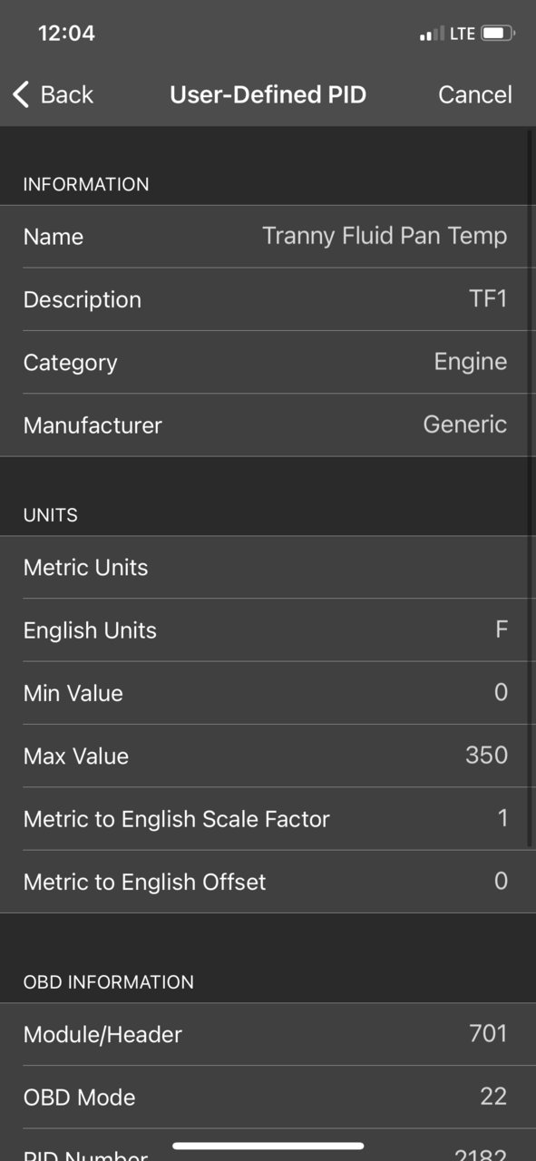

    Good day. I have been reading plenty on how to add the custom pid, but most are for using the Torque app. I am using the OBD Fusion app and pretty much added the custom pid as seen in the screenshots, but unfortunately no data is received. Can someone that is using the OBD Fusion app, let me know what is wrong or missing? I know most posts have the equation like this ((((A*256)+B) * (7/100) – 400)/10) but OBD Fusion does not like it and has to be added like what I put in the screenshot. Thanks in advance.

    Figured it out... Disregard.

    The way the calculation was written. Also the pid and OBD mode was wrong.
