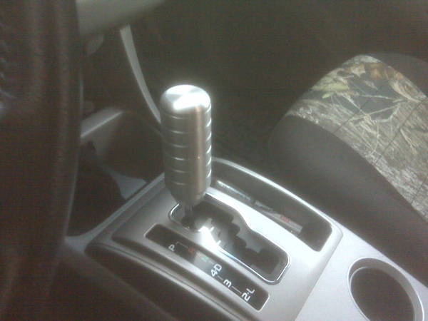

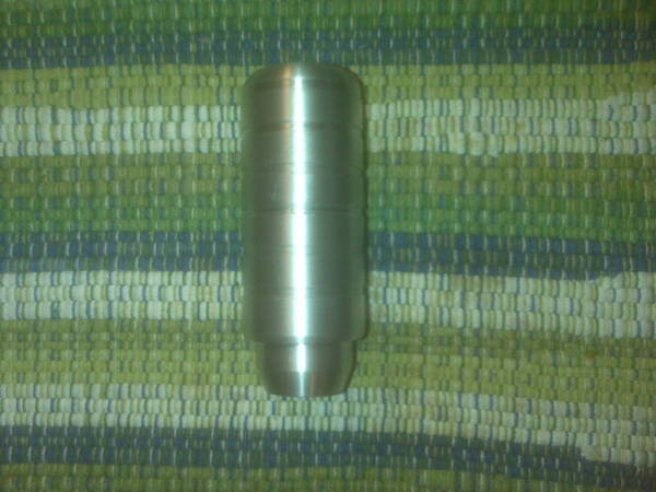

    So I was bored the other night and thought hey I'll make a shift knob. It's not finished yet, but I figured I'd put some pics up and get some feedback in case you all some good ideas on what else to do to it. My plans now are to modify the bottom (maybe turn it down some and/or shorten it) and paint the grooves black. I'm still not sure if I like the rough sanded look or if I want to polish it. I might polish it tonight then post some pics tomorrow to see what you all think.
    It still kinda looks too long to me. I think if I turn the bottom diameter down some it will make it look better. Sorry for the pic quality, my phone kinda sucks.

    I like it! I like the rough sanded look, but I also think that the strips should be black.

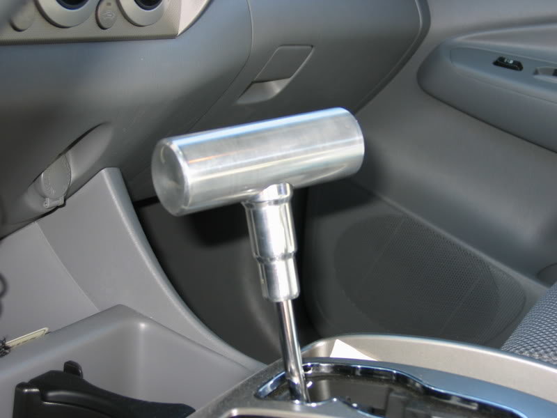

    Since you have a lathe, you might think about a 2 piece design. Here's the one I made:

    Nice! I like that toku. I'm gonna mess around with the one I got for now, see what I can come up with for it. I might try to come up with something 2 piece for the next one.

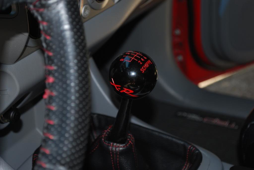

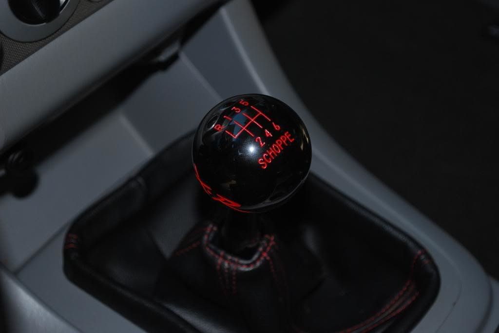

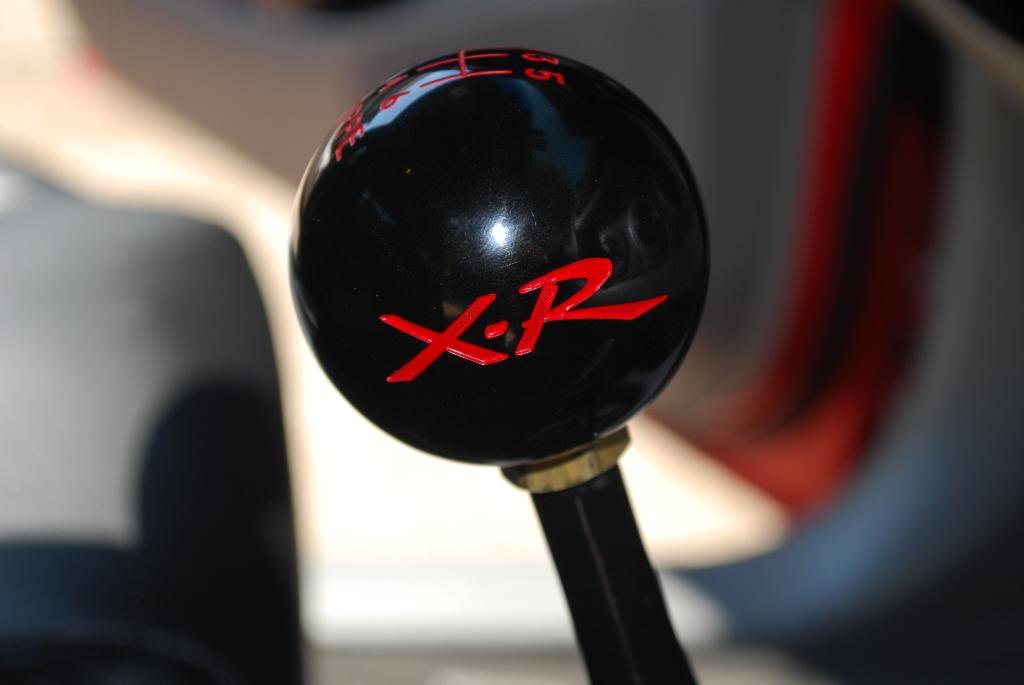

    This is mine. This is on a X-Runner. 2 1/4" diameter.

    How exactly is it made? And out of what?

    I say no paint, I like the look of it now....all metal, tough.

    Mine is made out of 6061 T6 aluminum round stock. I just cut a chunk off and threw it in the lathe and started cutting. I actually had to make it 2 piece but you really cant tell. I had to cut it in half because I didnt have a tap long enough to reach all the way inside. Then I just turned a shoulder on one end and bored out a hole on the other and pressed it back together. I just got done modifying it some more. I cut the bottom down some and put another shoulder on it. It looks and feels much better to me now. I'll put up some more pics when I get home in the morning.
    PS: I took a black paint marker and painted the grooves black. It looked ok, but I liked the rough full sanded look better so I sanded the paint back off.

    Looks good down close to the shift gate & yes, do the grooves black.
