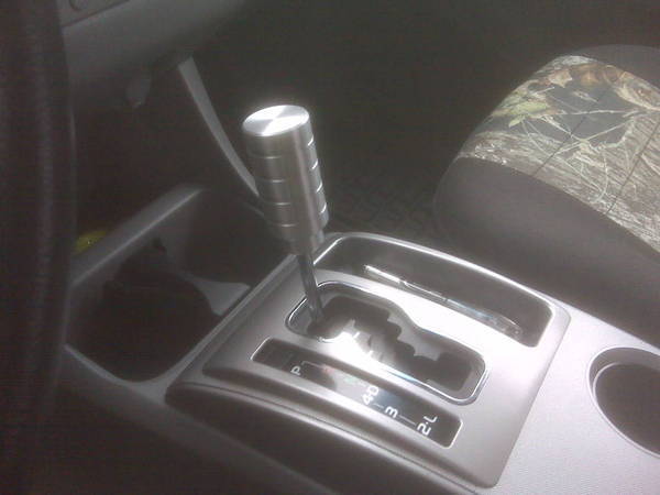

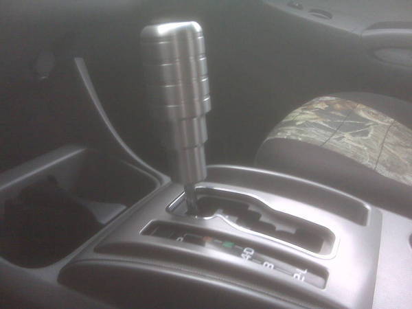

    Well I modified my orginal one and made another a little bit different.
    Original
    New
    The new one is a bit smaller.

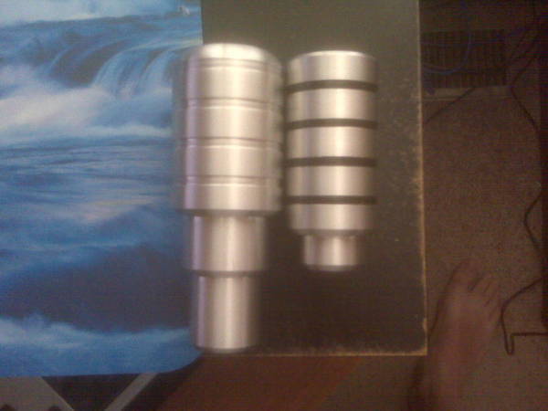

    Im bored so Im gonna go paint the grooves in the smaller one black and see how it comes out. I'll be back with pics.:D

    Ok. I am terrible at taping, but it looks decent. Here it is next to the other one.

    looks good.

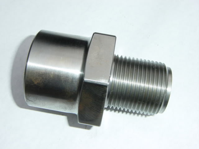

    If you have access to a lathe you could make an adapter pretty easily. Just make the male end 12x1.25 or whatever the manual thread is then the female 8x1.25.Below is an example of what Im kinda talking about. Thread_Adapter2_5d8238b0bbcbc6f39ada6e1b652f3f8fe7840500.jpg
    Just an idea for anyone with an auto who really wants a TRD knob.

    So is the automatic shifter stalk M8 x 1.25 threads?

    Maybe instead of painting you could just get some O rings that would fit the grooves really nice. Does your shop send out parts to get anodized? It's be pretty sweet to get it anodized and then cut the grooves in or the design on top. I guess it may fade but you could do a color then the clear hard coat.
