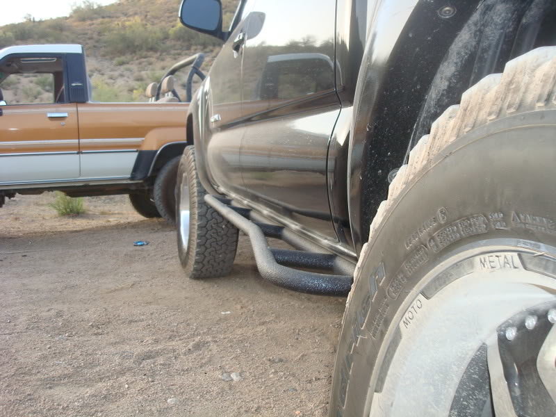

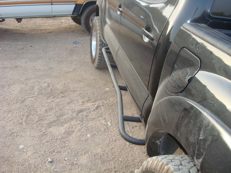

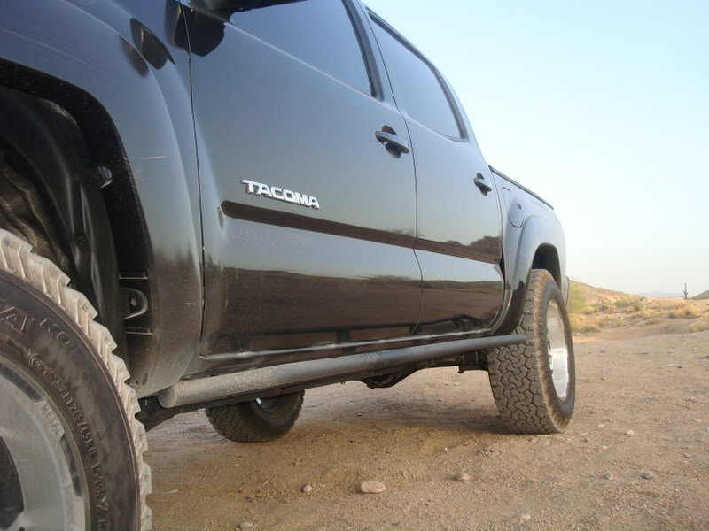

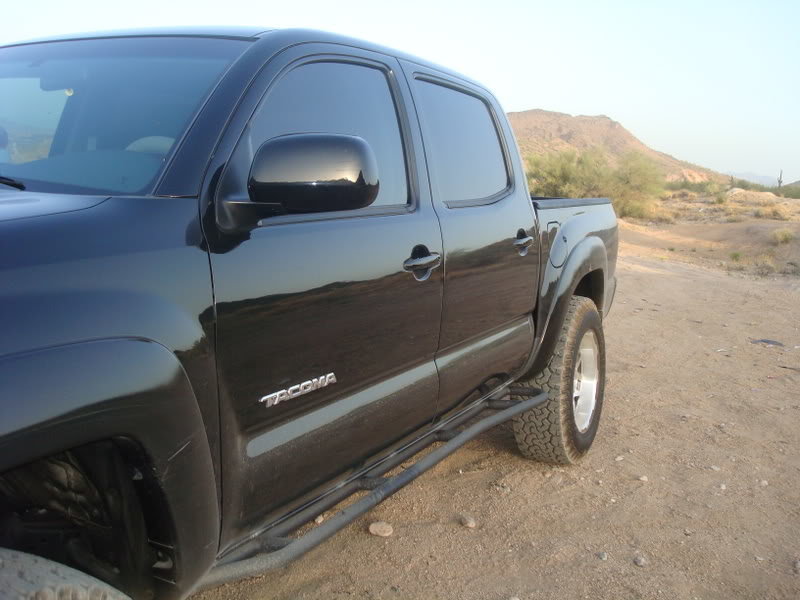

    They aren't custom but heres some pics anyways... they are Allpro sliders that I had line X'd

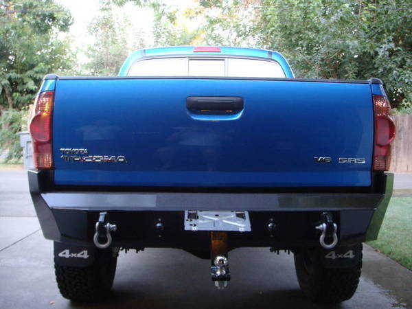

    Here are the ones that were built/installed by a place here in Sac called "Bent-Up"

    Grey- How does that line-x hold up to wear and tear?? I like how that looks...and I love the allpro sliders

    i was gonna ask the same thing, since i'll be getting a set of the allpro's if i dont have mine custom made. and at the same time, when i get it home, i'll be using herculiner on it as i did my bumpers. that stuff is easy as pie to touch up too.

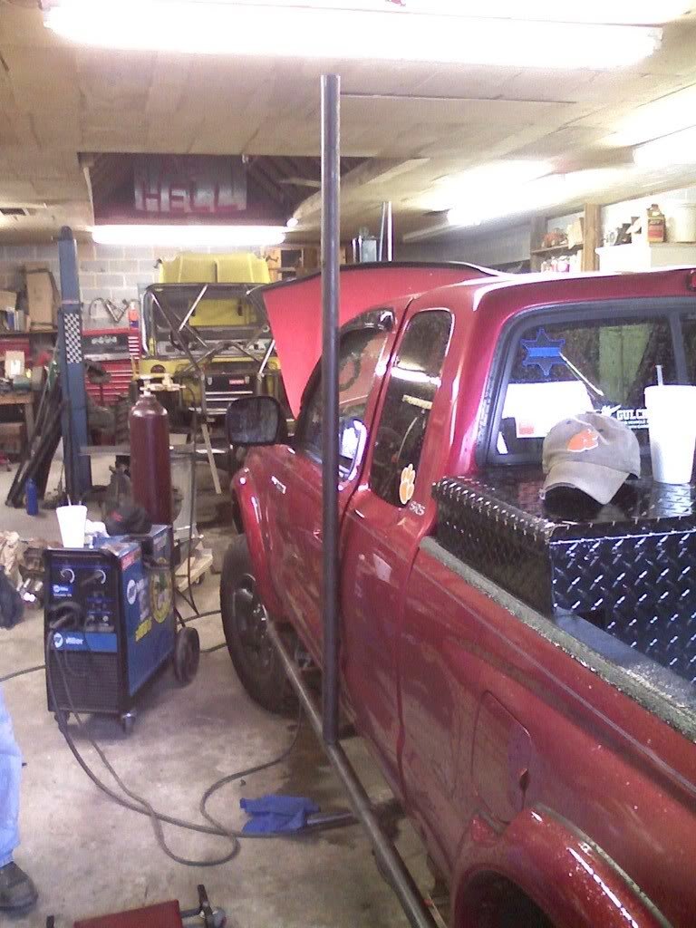

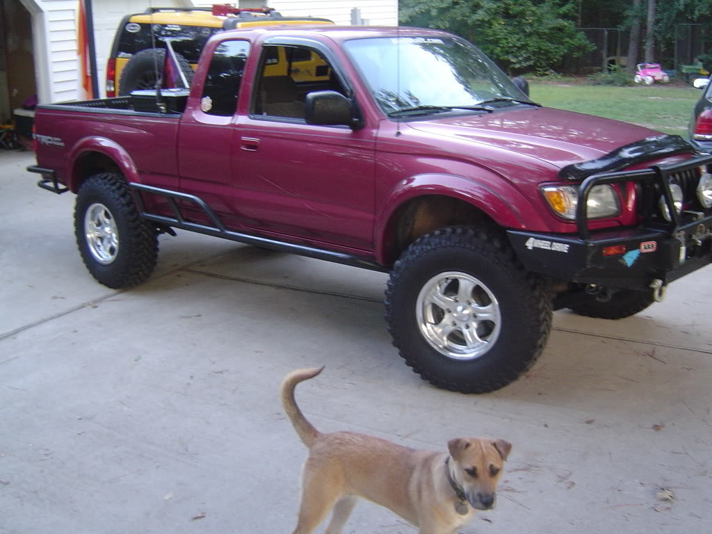

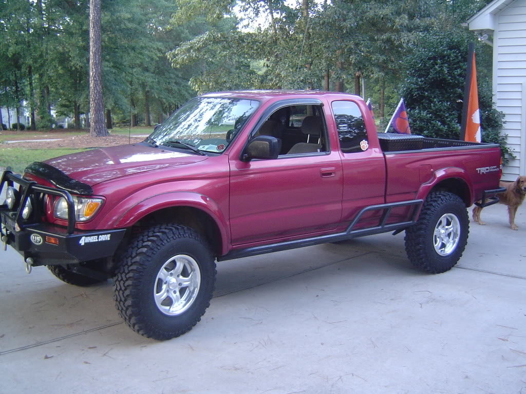

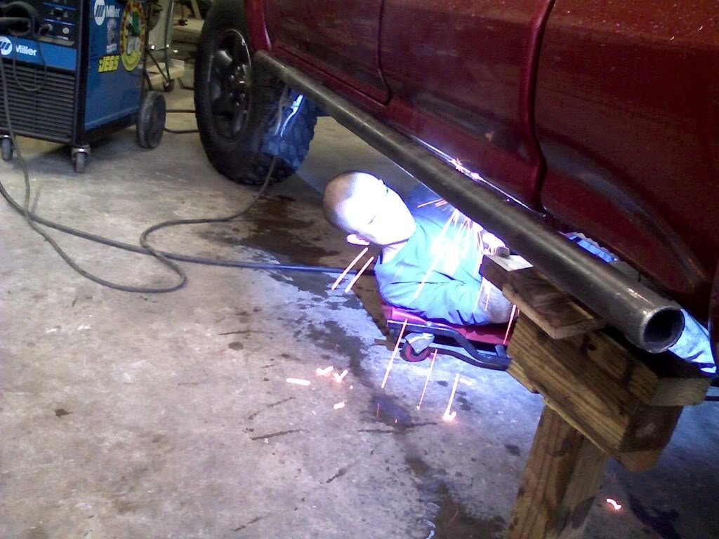

    i'll jump in here since everyone else has posted "off the rack" stuff...i know im a little late and all...
    mine are completely custom...by Unbreakable Fabrication in Lenoir, NC
    theyre welded to the frame in 4 places on each side...they do tilt up but thats so i can keep them closer to the body...theyre made out of something like .120 wall DOM tube...even when they were tack welded on for test fitting we had to grind them off...they wouldnt just break off like a tack weld normally would
    id say mine are just as good as shrockworks...plus theyre custom...and mine only cost me $375...that was for the steel, labor, and first coat of paint...i chose to rattle can mine because its easier than liner to touch up...and cheap...ive stood on mine in the rain and mud and never slipped off...so i dont think traction is really necessary personally...

    That first pic doens't look real safe...I like my eyes waayy to much to play around with welds like that.
    I do like those sliders tho...They look sharp.

    typically it wouldnt be...but that was doing tack welds and he'd shut his eyes before he did it...so he only got sunburnt :rolleyes:

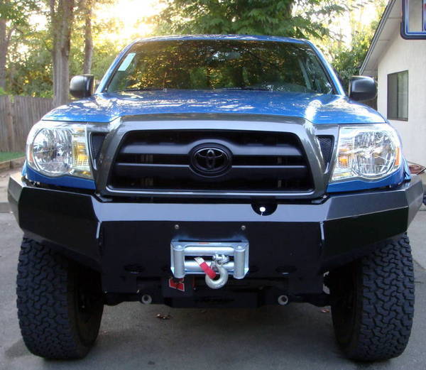

    Bumper and sliders look sick!! Great job - would love to see more pics of the bumper... Where did you get it? Price?

    Thanks! They were all built and installed by "Bent-Up" here in the Sacramento area. I am not sure on pricing as they were installed as part of a package deal for the wholesaler that bought the truck and then ended up selling to me. For more pictures I have some in my gallery here on TW.

    That is definitly awesome looking - I like it better that ARB or Allpro bumpers...
