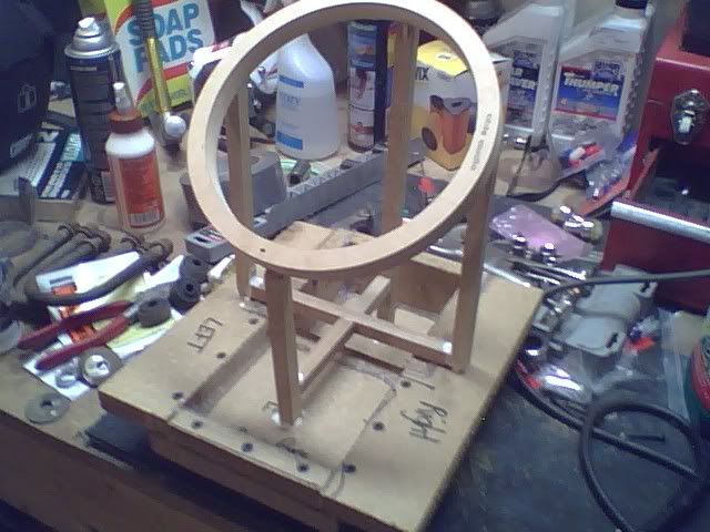

    Here is the custom box im making for my 98 Reg Cab. Its going between the bench seat and the middle of the dash, where the cupholders go. I'll get better pics when i get home, and after i get done fiberglassing it.:D

    Sweet! What material will you use to stretch over the framework?

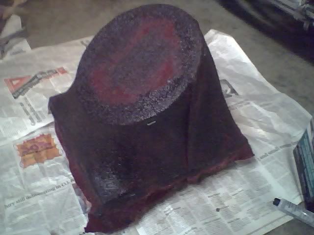

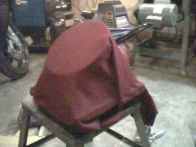

    Well it turns out i had some clearance issues with the dash, so i had to cut the four posts holding the ring up, by 2 inches. So, all i got done was stretch the fleece and put my first layer of resin on. Sorry for the crappy cell pics, mom stole the camera.

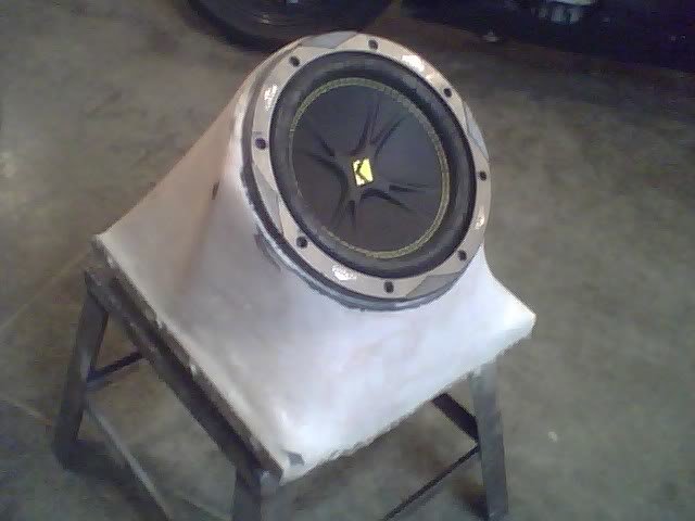

    Here is it in its current state. Painting tonight. 1010082131a_824f77e172b47f348a940b8974223f27a13613c6.jpg

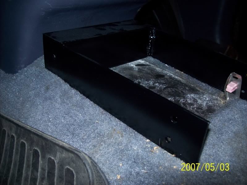

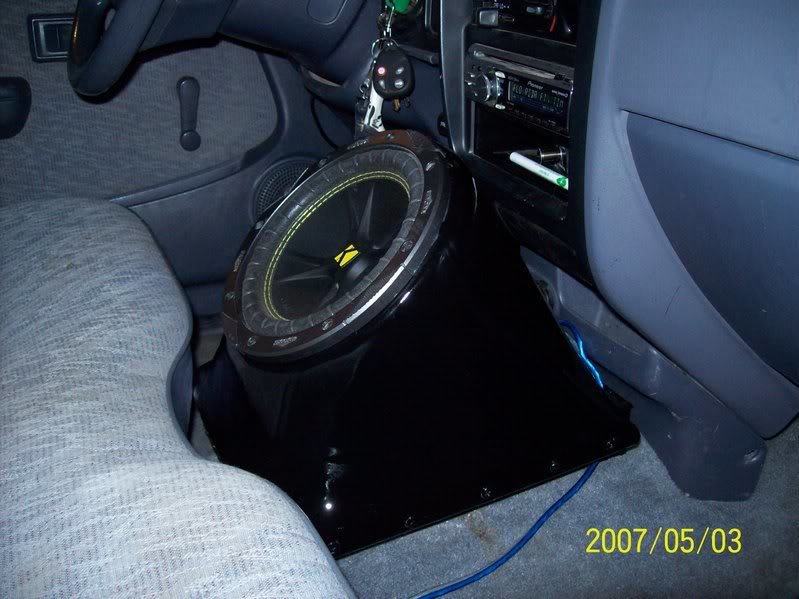

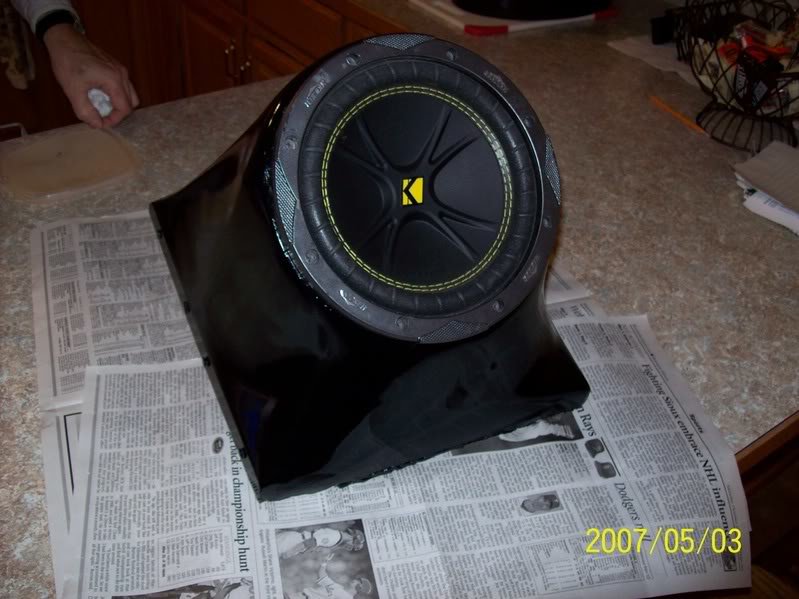

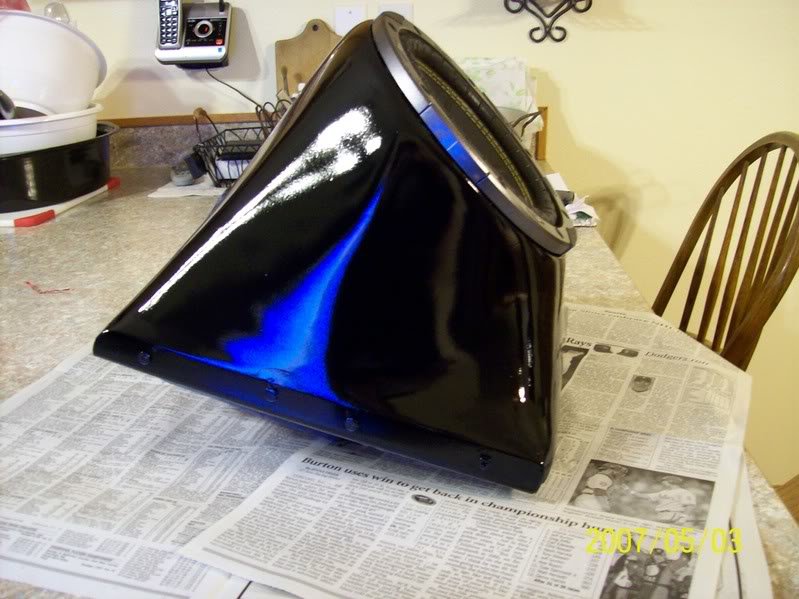

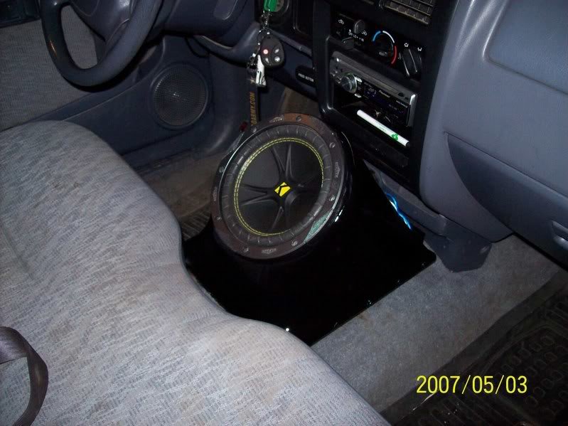

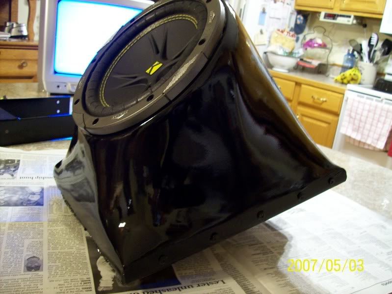

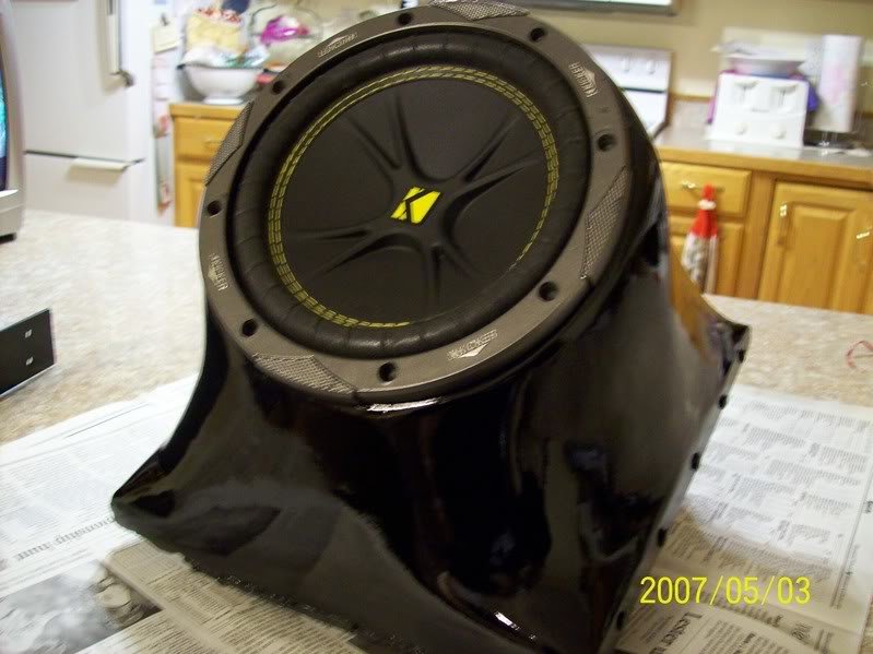

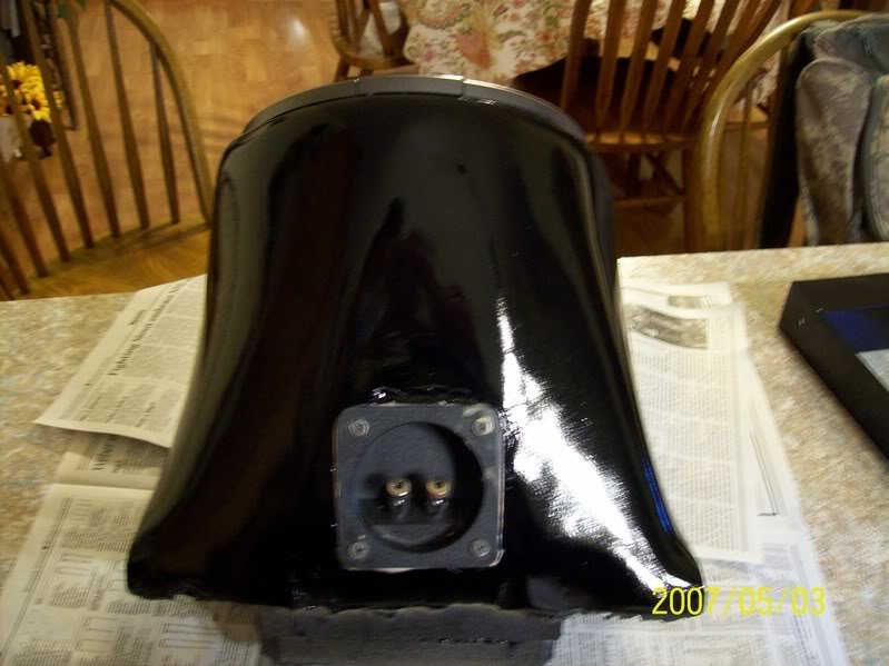

    *Finished*
    Here are the final pics!:
    Mounting Bracket:
    What you guys think?

    looks great! Good job!! The only thing that worries me is that it's in plain wide open view... (could attract thieves)

    Yeh, not too much crime up here in ND.. SoCal might be another story though!

    I was suprised it sounds as great as it does!
    I did all the bondo work (that i thought was needed) and put the sub in and hooked it up. It didnt sound good at all, there was air coming out from between the sub and box. Well, i let my autobody friend do a little work while i was cutting out rust and replacing it with clean sheet metal on his 88 camaro. Damn did he make it look good. He also leveled out the mounting surface for the sub. I let him prime it, but I did the base coat with some Duplicolor Gloss Black acrylic enamel and clear enamel. I siliconed the sub to the box and it sealed very nicely. No leaks and sounds amazing!
