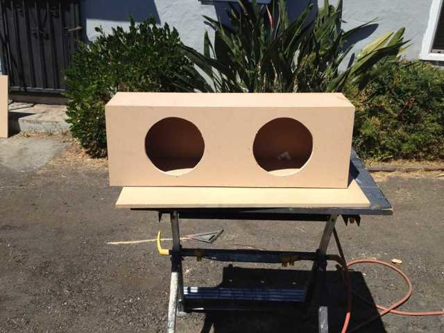

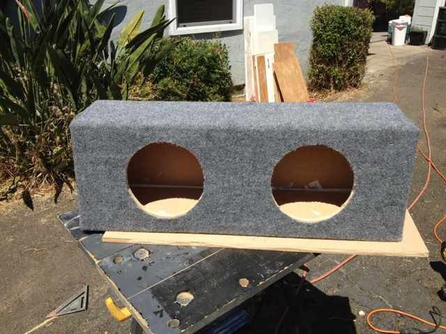

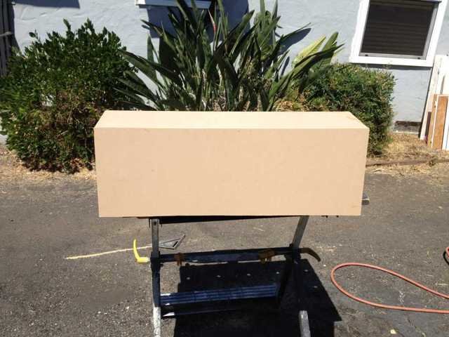

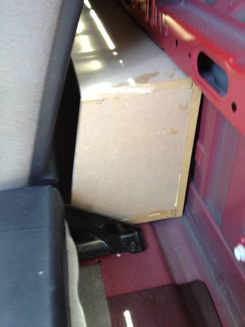

    I have had my tacoma for a week now and love it, just needs some bump. I started looking into sub boxes that fit behind the rear seats and they are pricy, 130+30 for shipping. So I decided to make my own. I built It out of 1/2" mdf, all joints are glued and nailed with 1-1/4" finish nails. Then just wrapped with some thin carpet I got from home depot. The Box will house 2 8" kicker comp subs. Going to run a mtx 500w amp, and going to replace stock deck with a double din USB deck. All parts coming from eBay, I'll post more pics as I go.

    Looks good. Just make sure the 8's have the recommended air space. That box looks to be about .3 cubic +/- per side.

    Thanks, I did the calculation, it's .88 cu foot, so .44 cu per sub, they recommend .5 per sub so I think it's close enough. I don't plan on pushing them to the max.

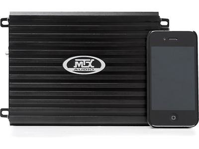

    I honestly had no idea the amp i purchased was this small :eek: It is a mtx td500.1d, the very limited reviews i find on it are good. The 2- 8" subs i will be running are 200w max and 100w rms, so that would be a combined 400w max, being this amp is a 500w I think it should be fine. The subs are 4ohm svc and I will be running them parallel for a final load of 2ohms.
    http://www.tacomaworld.com/forum/attachment.php?attachmentid=168135&stc=1&d=1346811506

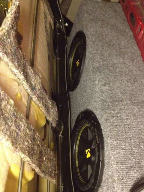

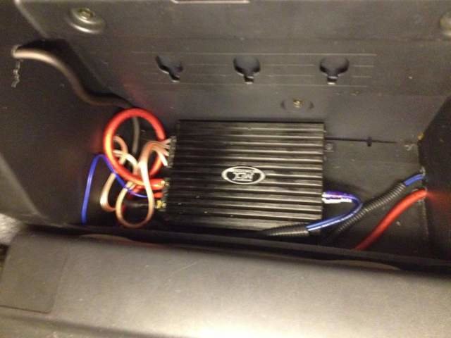

    05 Tacoma pre runner dbcb short bed
    Kickers mounted, amp fit perfectly in storage area. Now to setup my new deck and adjust gain. ujyzu7at_4a9127b18378debb18e267b530d046ba3faa2b59.jpgjyta6yhu_f2d96967e51a04a3774f1ef0bcebe8065b2993dc.jpg
