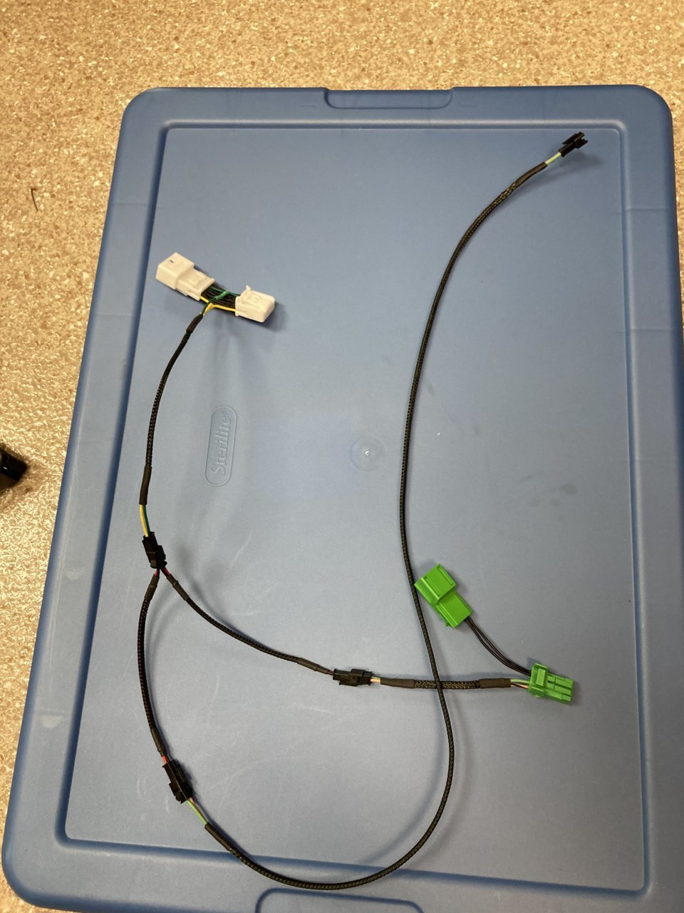

    @kmorgan3 scrounged up connectors and pins for my manual climate control hazard connector to T off switch illumination in the center console. I crimped on a 2 pin JST connector since Y’s are easy to build or source. Then, thanks to the prototype from @lapoltba I injected dimmed illumination into the 2 low switch and have a tap for other switches in the LSP.
    @kmorgan3 might be able to do onesy twosy stuff for others if you ask?
    The green male JAE connectors seem to be the challenge for me. I’m putting together an order of stuff and they are $3.65 each from hi-1000 which is not super sweet since they aren’t even a OEM part.
    So at $30-$40 for the T and then $10 for each switch injector, it does add up. I’m sure @lapoltba has much better plans for cost control with his sources and making someone else crimp in bulk is always better than spending time crimping yourself so I'm confident he will produce something far better in price and value than anything I can throw together.
    I know it's a very small change but now that my 2Low switch is dimmed vs always-on I'm a little bit happier.
    Congrats on the new addition, @lapoltba. May your journey be every bit as ridiculous as mine.

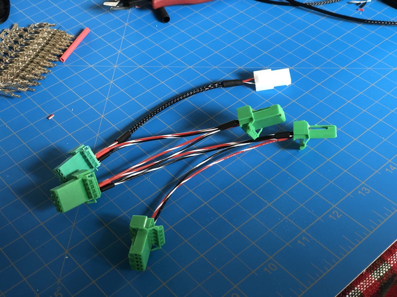

    The JAEs (IL-AG5) are actually really easy to find. Probably dont need to go through japan (shipping $$). I just don’t buy the plugs or housings as it’s easier for me to de-pin the ones you get from CH4x4 and build jumpers.
    Female: https://www.mouser.com/ProductDetail/JAE-Electronics/IL-AG5-5S-S3C1/?qs=XHhX5SAHOUOqqVYYEAtKUg==
    Male: https://www.mouser.com/ProductDetail/JAE-Electronics/IL-AG5-5P-S3C1/?qs=/ha2pyFadugXv4PDsDliQm/a6RfuasZReZkEUTQcSIv7UItCRIvOWQ==
    Jumpers made by de pinning and double crimping (not as reversible as the adapter you have... but cheaper):
    daveeasa[QUOTED] likes this.
