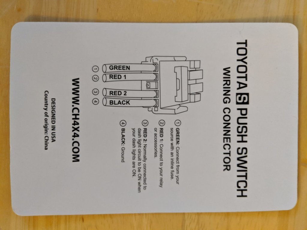

    Where did you get the male and female plugs for the 4x4 switches?
  14. Sep 17, 2019 at 1:01 PM
    #74
    lapoltba
    lapoltba [OP] Full Bridge Rectifier
    Aug 28, 2014
    #137089
    3,347
    CT - 06076
    '17 Sport, ACLB, V6,MT, 04B14 OV-Tuned
    The push switches, or the 4x4 mode selector switch?
  15. Sep 17, 2019 at 1:04 PM
    #75
    Gus87
    Gus87 Well-Known Member
    Jun 10, 2018
    #255991
    489
    Chicagoland
    16 trd sport
    The push switch
  16. Sep 17, 2019 at 1:06 PM
    #76
    lapoltba
    Aug 28, 2014
    #137089
    3,347
    CT - 06076
    I got them from a place on Rakuten Japan because I was ordering a bunch of other stuff from there. The same ones are available at Mouser though. JAE IL-AG5.
  17. Sep 17, 2019 at 1:15 PM
    #77
    Gus87
    Jun 10, 2018
    #255991
    489
    Chicagoland
    16 trd sport
    Thank you I couldn’t find them anywhere and I didn’t know how to search for them
    lapoltba[OP] likes this.
  18. Sep 17, 2019 at 2:04 PM
    #78
    Gus87
    Jun 10, 2018
    #255991
    489
    Chicagoland
    16 trd sport
    Sorry to bug you again. But I noticed those are 5 pin and the switches are 4. I don’t have a switch in front of me right now but I’m a little confused how it will match up.
  19. Sep 17, 2019 at 2:20 PM
    #79
    lapoltba
    Aug 28, 2014
    #137089
    3,347
    CT - 06076
    The switches are 5 pin, the middle pin is not used/populated. There are switches of the same size/shape that are double switches that do use the middle pin, FYI.
    Gus87[QUOTED] likes this.
    deusxanime and Gus87[QUOTED] like this.
