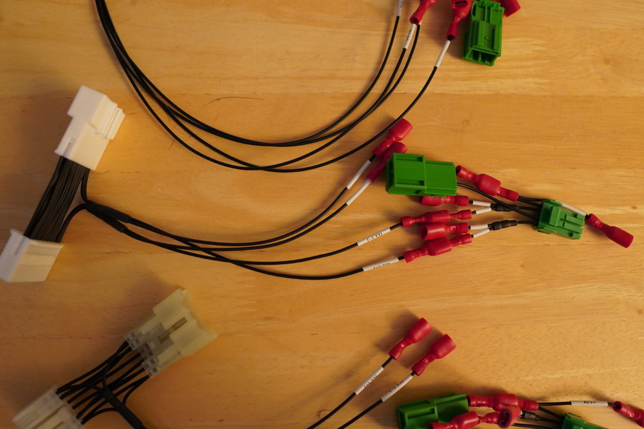

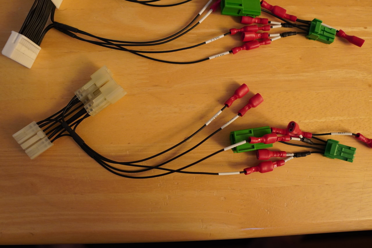

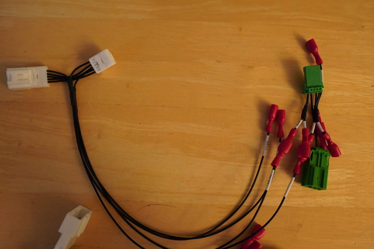

    Here are a few pictures. I am just getting a little time to look at them. The red spade terminals will most likely be changed to something else. I don't like these. They feel cheap and look like crap. I will also be using 1/4 and 3/16 spade terminals to help avoid wiring things backwards. All wires are labeled. I still need to actually plug them in and make sure they are all wired correctly.
    The green ones are what you would order to daisy chain more switches. The 12V power that operates the relay coil has a wye and female spade to run power to another switch as well. It can also be disconnected in the middle to isolate it from the truck side of the wiring, and/or use the other spade to supply 12V from your fused source.

  9. Aug 13, 2020 at 5:52 PM
    #149
    caribe makaira
    caribe makaira Well-Known Member
    Feb 13, 2011
    #51121
    11,781
    Caribbean, Puerto Rico
    05 PreRunner TRD Offroad AutoTrans
    Hood Struts, My version Fogs always ON, Map & Overhead Light Mod,
    How about this? ($$?)
  10. Aug 13, 2020 at 5:54 PM
    #150
    lapoltba
    lapoltba [OP] Full Bridge Rectifier
    Aug 28, 2014
    #137089
    3,346
    CT - 06076
    '17 Sport, ACLB, V6,MT, 04B14 OV-Tuned
    Yeah, I am sure I can have it made..... PM me what you are thinking. I have the parts for the other one we were talking about but haven't had time to assemble it yet. That one is next on the list.

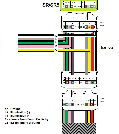

    Do these have ignition power coming off the main harness into the green splitters? I’d like it to where the only wire I need to run is the trigger wire for whatever accessory I’m using the switch for...if that makes sense...
  12. Aug 13, 2020 at 6:00 PM
    #152
    lapoltba
    Aug 28, 2014
    #137089
    3,346
    CT - 06076
    No, unfortunately. The connectors I am tapping into for illumination do not have 12V switched power. If you're using it with the 2LM harness, there is a spade terminal for supplying other switches that is fed from the 10A 4x4 ECU fuse.

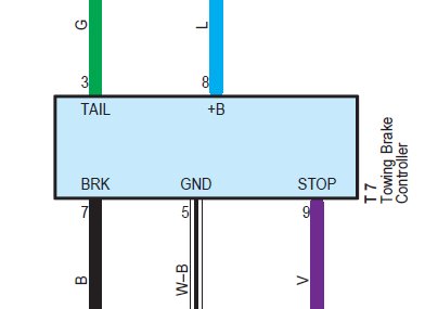

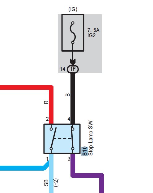

    Things
    honestly, I may just use a small fuse box under the dash and run it off the trailer brake harness. It’s a 40a circuit and has both constant and ignition power from my understanding.
  16. Aug 13, 2020 at 6:10 PM
    #156
    caribe makaira
    Feb 13, 2011
    #51121
    11,781
    It has constant but no ignition. Illumination and ground though.

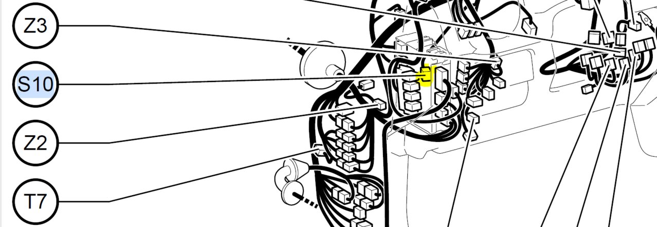

  17. Aug 13, 2020 at 6:14 PM
    #157
    SearArtist
    SearArtist GX poor
    Jan 5, 2016
    #174151
    18,972
    NC
    GX470 & GX460
    Things
  18. Aug 13, 2020 at 6:23 PM
    #158
    lapoltba
    Aug 28, 2014
    #137089
    3,346
    CT - 06076
    Yeah, I remember getting discouraged a while ago when I was looking because there really isn't a good source that is convenient to get to in the dash.
  19. Aug 13, 2020 at 6:24 PM
    #159
    SearArtist
    SearArtist GX poor
    Jan 5, 2016
    #174151
    18,972
    NC
    GX470 & GX460
    Things
    yeah and I really hate using add a fuses. I like to keep my wiring clean where you can’t even tell it’s not factory.

  20. Aug 13, 2020 at 6:28 PM
    #160
    lapoltba
    Aug 28, 2014
    #137089
    3,346
    CT - 06076
    Same. That one I just posted I will see if I can find a source for the connector.
