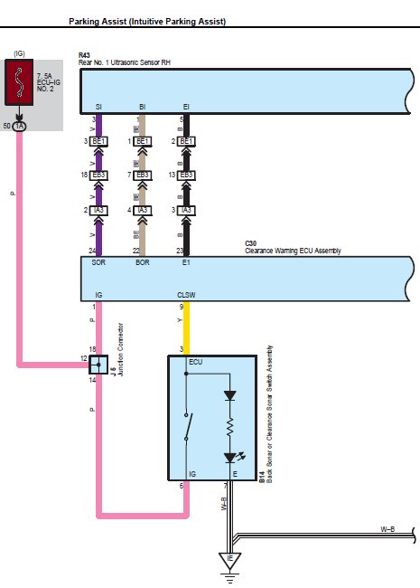

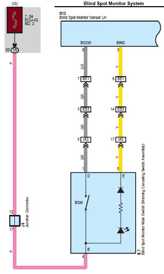

    Do the BSM or Parking sensors have ign power? I’m going to have to remove those switches (lost functionality with HC bumper), and if they do I can just tap them for ign power for the switches under the radio.
  2. Aug 13, 2020 at 6:31 PM
    #162
    lapoltba
    lapoltba [OP] Full Bridge Rectifier
    Aug 28, 2014
    #137089
    3,344
    CT - 06076
    '17 Sport, ACLB, V6,MT, 04B14 OV-Tuned
    Pretty much everything as far as switches go on these trucks is low side switched, meaning closing the switch connects whatever is on the other end to ground (usually the BCM, ECM, or other computer).
  3. Aug 13, 2020 at 6:32 PM
    #163
    SearArtist
    SearArtist GX poor
    Jan 5, 2016
    #174151
    18,968
    NC
    GX470 & GX460
    Things
    gotcha

    Same source:
    Grossomotto likes this.

    Lol, If it bothered me do you think I would have joined in!? It's all good info. I would love to come up with a good place to give a no-splice way to power aftermarket switches. That brake light switch is the best one I have found so far. I am not sure how I missed it last time. It should be fairly easy to get at under the dash and it's only a 4 pin hybrid connector. I think I have located a supplier for both the M&F of it. MOQ of 50 pcs, but price isn't bad.
