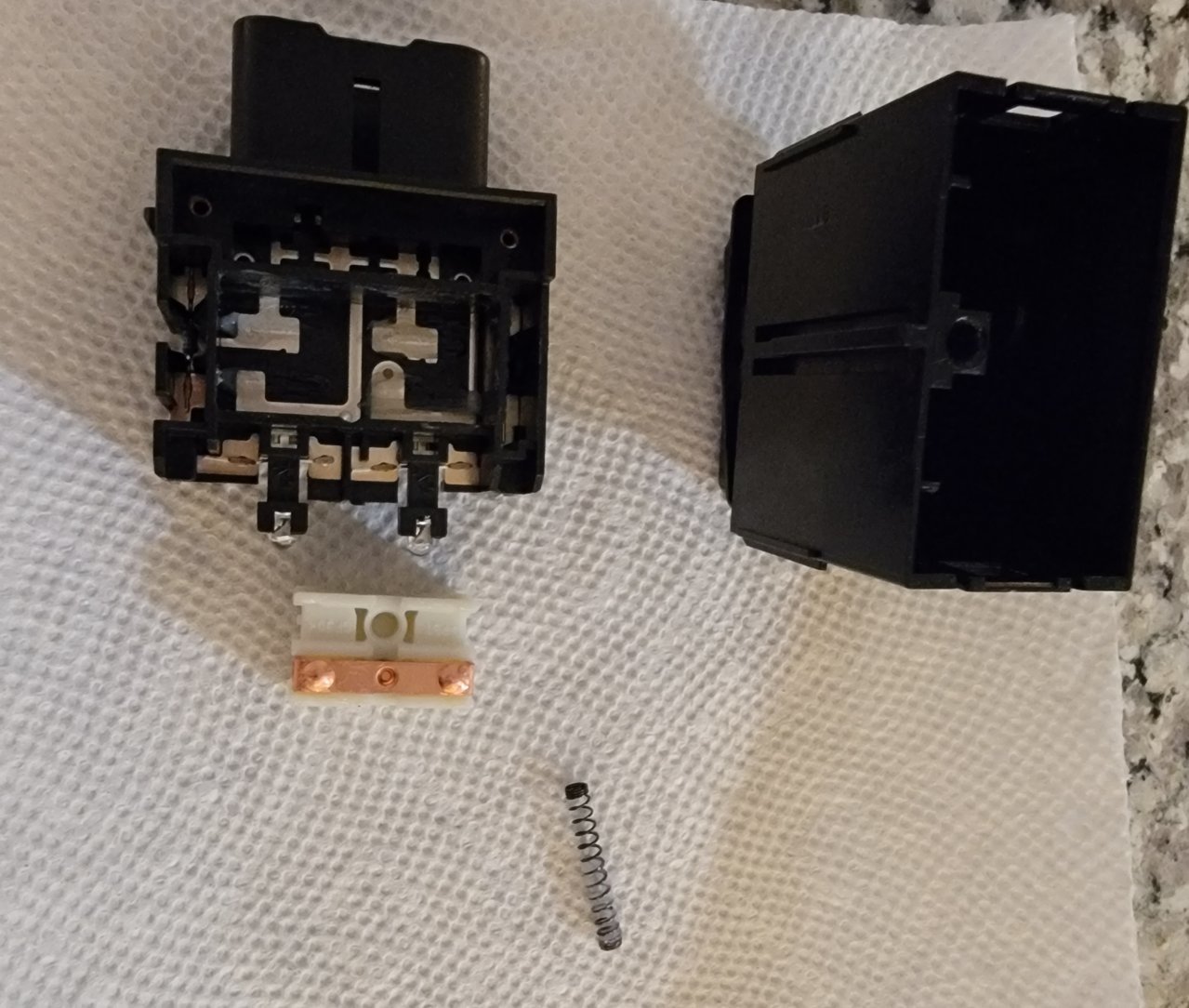

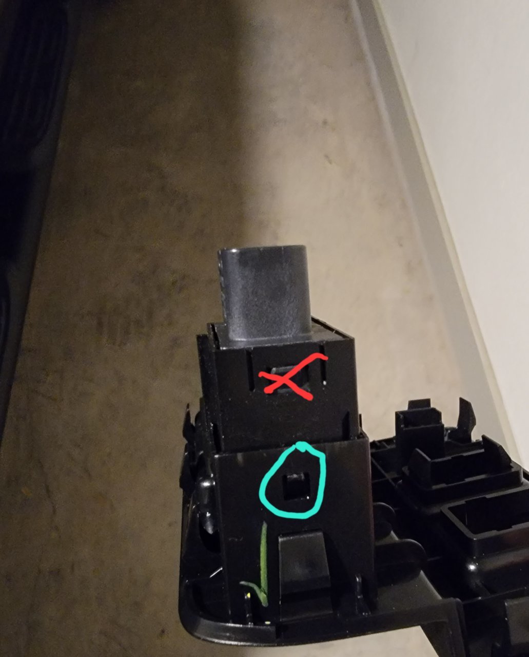

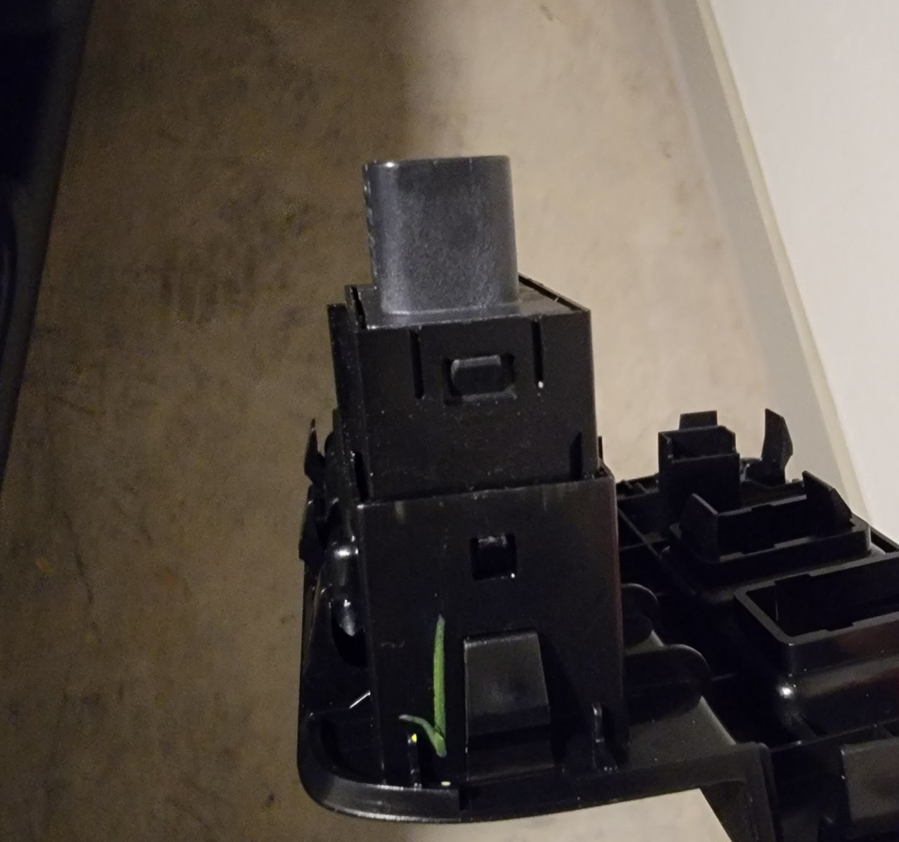

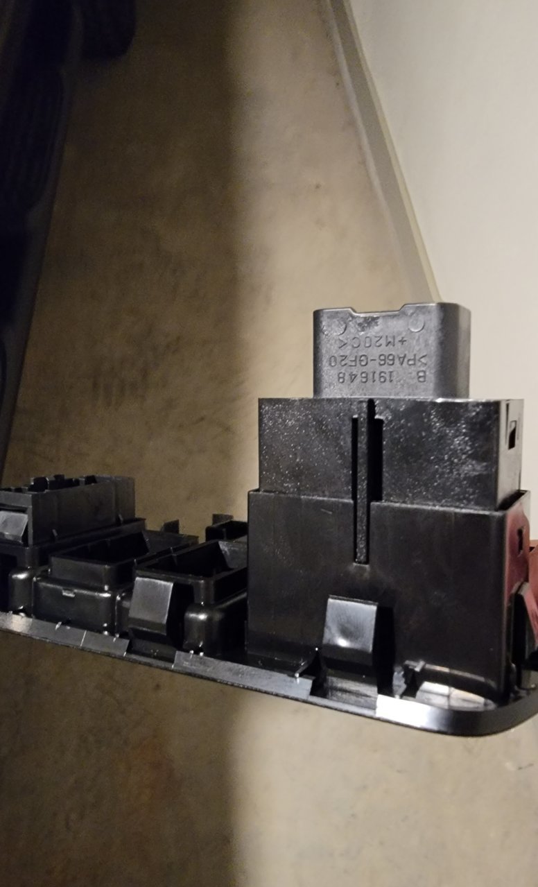

    How the hell do I get this cargo rocker switch out of the panel? Which clip is it? What I have found via search is not descriptive enough. Thanks in advance.
    Edit: Broke it, fixed it, got it figured out.

    No apologies necessary! That would have been perfect and thank you for the response. Maybe this can help someone later.
    The circled tabs are the only tabs that you need to push in. One on each side.20220208_165930.jpg
    And if you mistakenly pull the tabs marked with "x" you will disassemble the switch completely. Easy fix though. If you find all the parts off the ground...
