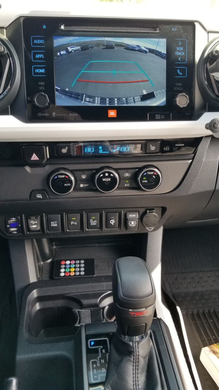

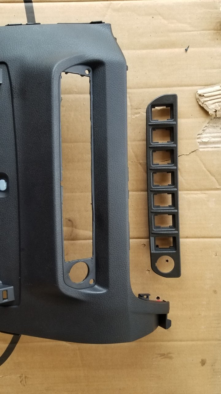

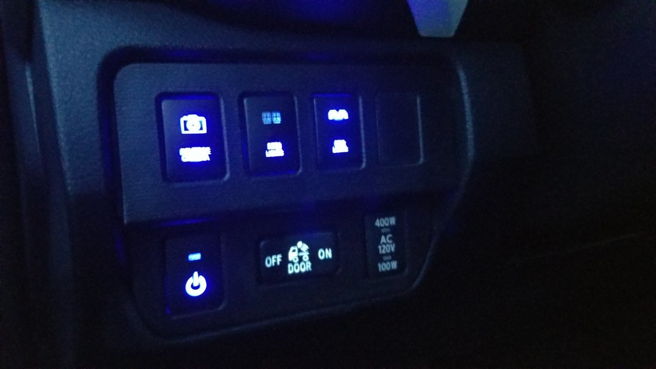

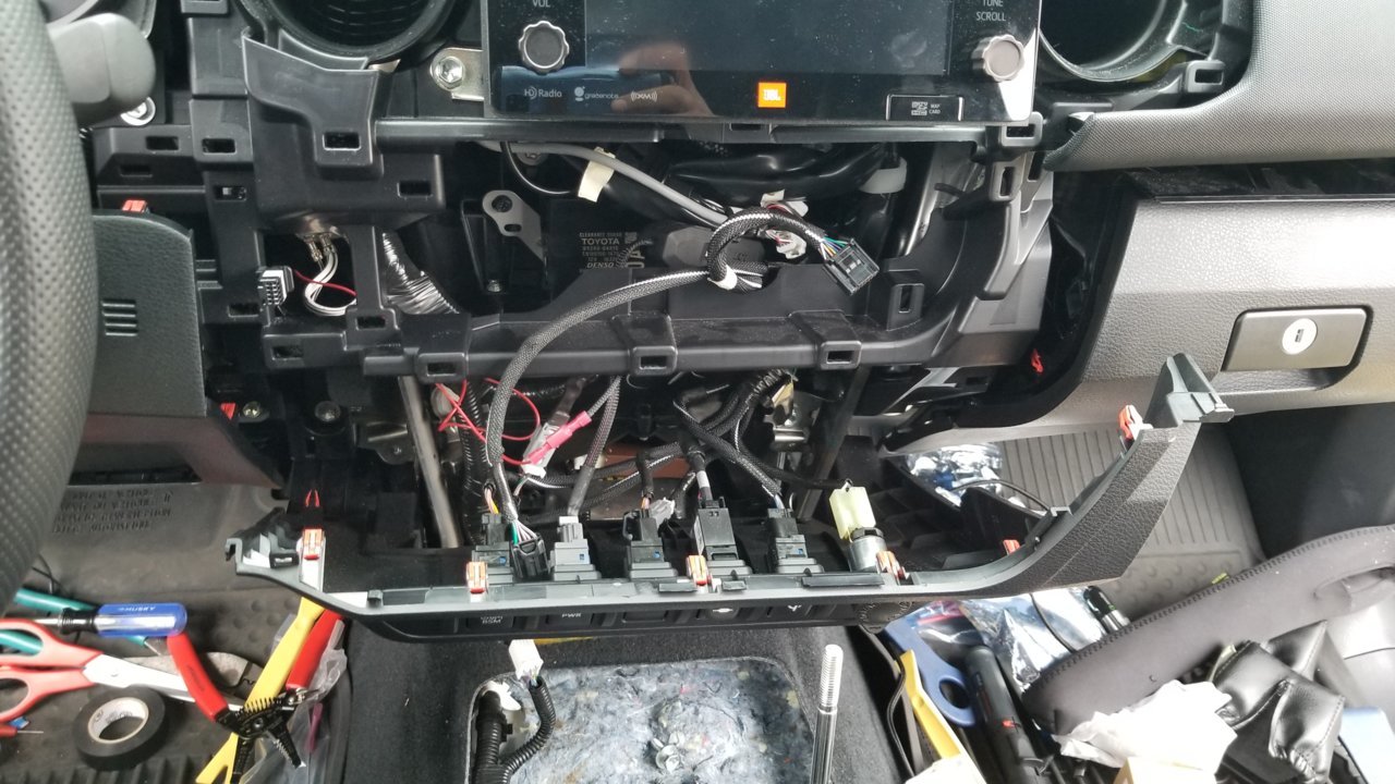

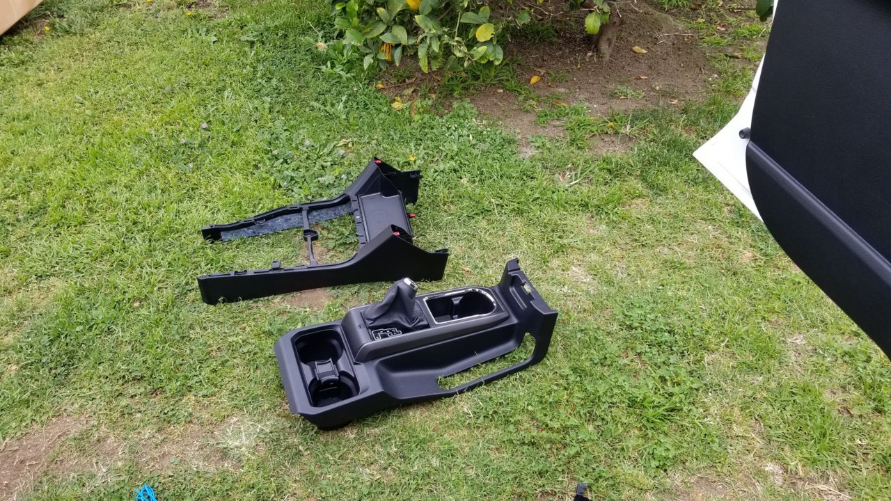

  12. Apr 5, 2018 at 3:19 PM
    #312
    Volksparts
    Volksparts AKA The Un"Official" Meso Taco
    Jan 13, 2017
    #207523
    899
    Dave
    San Diego
    2017 Taco Runner

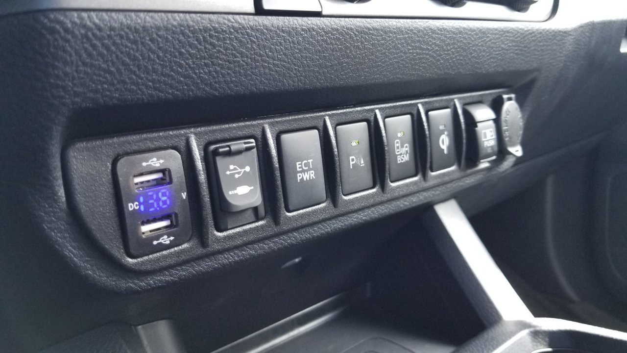

    Well I finally got around to installing the switch panels today. Thanks to the dude that had posted up the how to on this thread. It's also good thing that I had experience as a stereo and alarm installer in the past. I also installed the rear-view camera set up that Logistics sells. I used my own switch out of China along with the ones from mictuning. The two time-consuming parts were setting up a wiring to bring the rear window to the center panel and pulling off all the plastic pieces. As for cutting I used a cut off wheel, a file, and also a soldering iron at points. I used epoxy as recommended and only did it on the 3 mounting tabs. However at one point the bottom one wanted to keep popping out. So with that I ended up just using superglue to hold it in. I might regret it later but I did Plasti Dip the center plastic piece because I feel it did not match my left side pod well. Plus I figured that I already had plasti dipped my radio surround white and that is holding up pretty well.
    Toynado, tonered, Stew22 and 3 others like this.
  13. Apr 5, 2018 at 5:19 PM
    #313
    K-Bear
    K-Bear Well-Known Member
    Jan 7, 2018
    #240524
    174
    2017 Inferno DCSB TRD OR
    @Volksparts how did you extend the wiring for the window switch? Im looking to do the same...
  14. Apr 5, 2018 at 6:07 PM
    #314
    Volksparts
    Jan 13, 2017
    #207523
    899
    Dave
    San Diego
    2017 Taco Runner
    Cut and add wire. It's that simple. Yes it sucks you have to cut the factory wiring but that's the only way to do it that I can think of. Unless you get factory reverse harness and harness. I had bought one of those mixed wiring boxes from harbor freight awhile ago and low and behold I had the same color wires in that box that matched the factory colors. So I just matched them for ease of identification. Then at the end of the wires I connected it to the factory plug I had cut. You can either solder or what I like to use is butt connectors I get from Amazon that you can heat shrink. This is also a great time to wire up the illumination for other switches when adding the wire which is the brownish tan stock wire into your switches themselves. I also could've connected the 12 volt accessory of the switches from the pink red stock wire but decided to run a fused wire directly to the fuse block with an add a fuse. Also coming off that same rear window plug is the white with black lined wire which is the ground. So essentially yes I cut but it gave me access to also wire in my left side switches at the same time. And the remaining accessory wire went to the accessory.

  15. Apr 5, 2018 at 7:16 PM
    #315
    Beerpayzdabillz
    Beerpayzdabillz Pastryatarian
    Jul 28, 2016
    #193169
    1,528
    Nor Cal
    2016 DCSB 4x4 sport
    in for LSP7- 7 Switch Hole when back in stock.
  16. Apr 5, 2018 at 8:52 PM
    #316
    cruxx
    cruxx Well-Known Member
    Apr 20, 2017
    #216831
    1,199
    Huy
    2017 TRD Sport
    Looks really clean. I really want to move that slider to the center as well, but i really dont want to break any trim inside the cab. Already broke a clip changing the tweeter. Was it straight forward and easy or fragile and complicated?

  18. Apr 6, 2018 at 5:52 AM
    #318
    Volksparts
    Jan 13, 2017
    #207523
    899
    Dave
    San Diego
    2017 Taco Runner
    I think if you take your time, have a set of panel poppers, maybe a cordless drill will socket attachment ( but not necessary), and use the step by step another guy provided then that helps. Again as mentioned before i was a stereo installer 17 years ago. Two tips, one being to take off the ebrake boot I released the bottom part of it with the L-shaped retaining wire from under the console which made it easier as the handle doesn't come off easily. The other was on the "step by step" on the passenger air bag it circled a bolt or something to remove but I couldn't find it but was still able to ease out that center panel with everything else removed. Also try not to scratch up your panels. I later had to do the heat gun trick on some of the scratches I made but couldn't remove all of them.
    Lastly, now that I think about it. This is definitely for the do it yourselfer. You have to be comfortable with handling your wiring, have tools to cut your stock trim, having all your wiring connectors with tools, and have time set aside I did my left side one day and the center part another. It can easily be done in one day but I didn't want to feel rushed. I also installed Led foot lights at the same time I got from Amazon for $20 and setup the button on the left life panel.

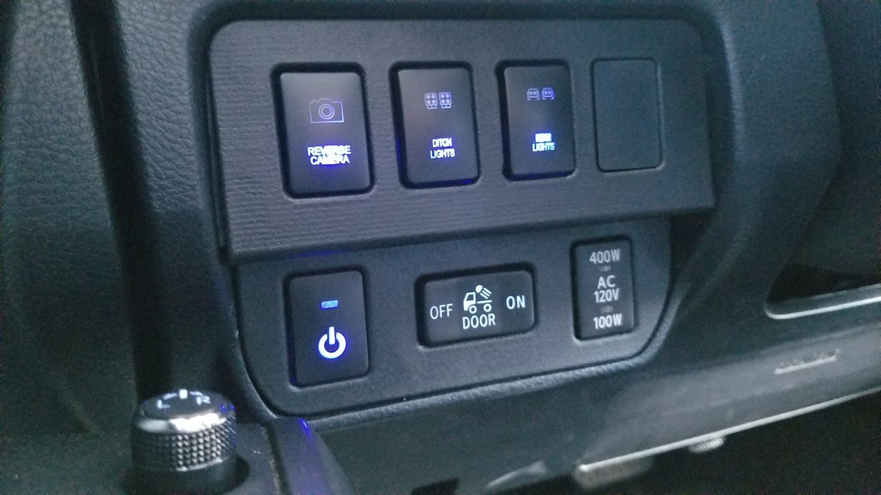

  20. Apr 6, 2018 at 6:20 AM
    #320
    Volksparts

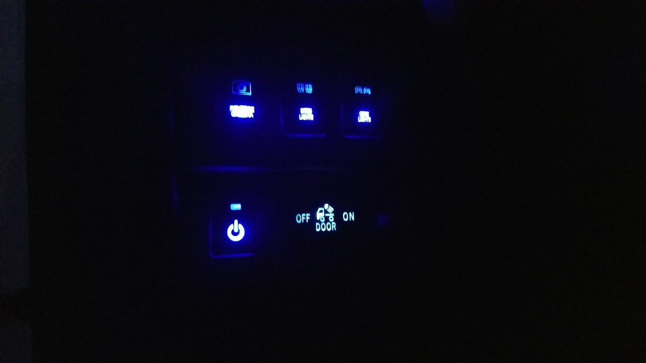

    Jan 13, 2017
    #207523
    899
    Dave
    San Diego
    2017 Taco Runner

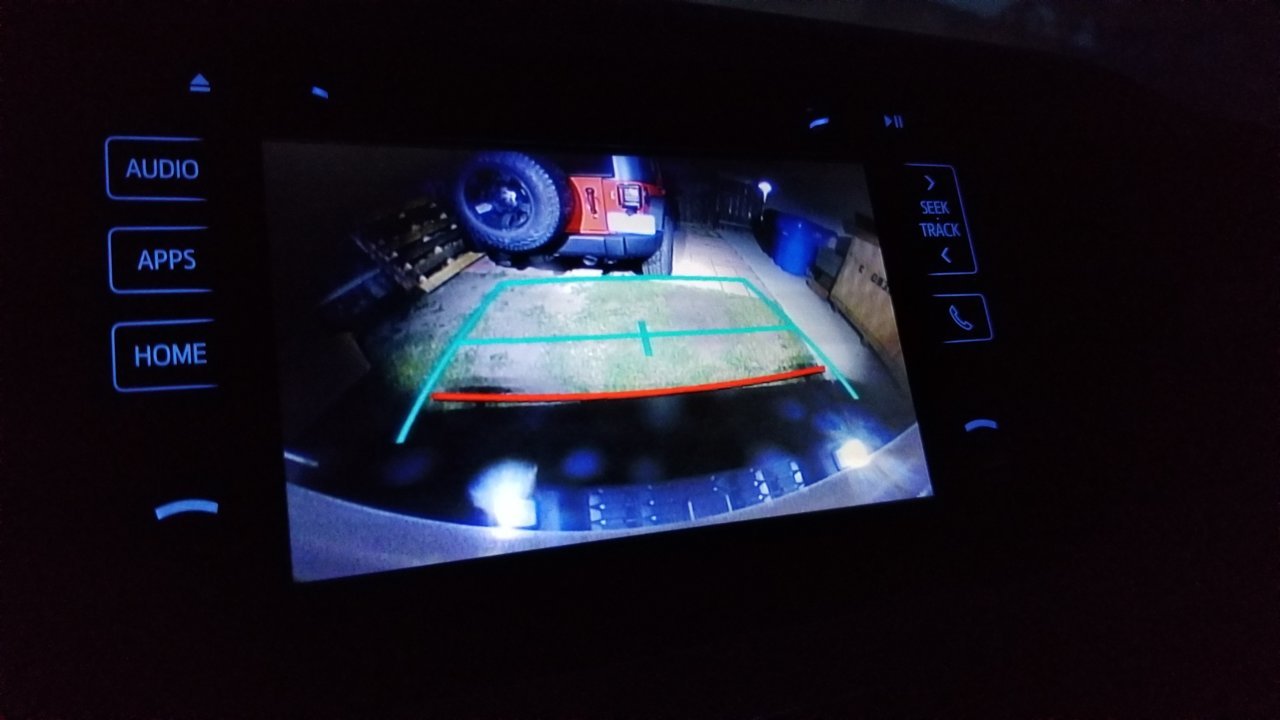

    Oh and just wanted to post this picture of the button for the reverse camera being pushed at the same time as my button for the rear rooftop flood lights and what I see at night.
