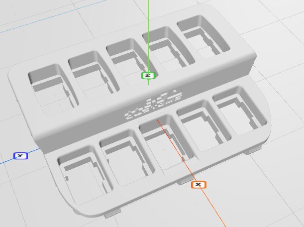

    @MESO if you have the cargo switch on the bottom of the panel, how many additional spaces/buttons could fit? I actually bought one of these on this last run but have found that I’m needing more and more room for accessories (ran out of room already)

    You guys want me to open up another round of these?
    You could mount it vertically on top. But if keeping it at the bottom you could do E(cargo) + 3 B’s max

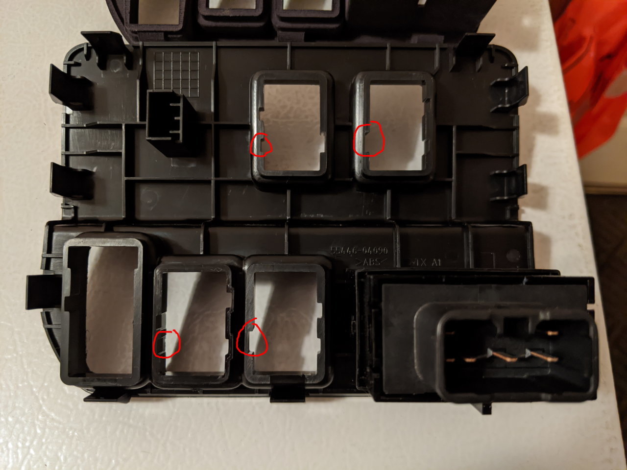

    Anyone who got a left side panel that uses B size slots, did you have trouble with re-slotting in the OEM switches to your custom panel due to keying on them? I went to put in mine (BBBB top, stock bottom) and ran into issues where I couldn't put the OEM switches in to the @MESO custom panel due to the "keys" on the switch being lower than the cutouts on the generic B slot.
    Here's the stock/OEM panel, with the "keys" on the lower left (when looking from behind) that are causing issues circled:

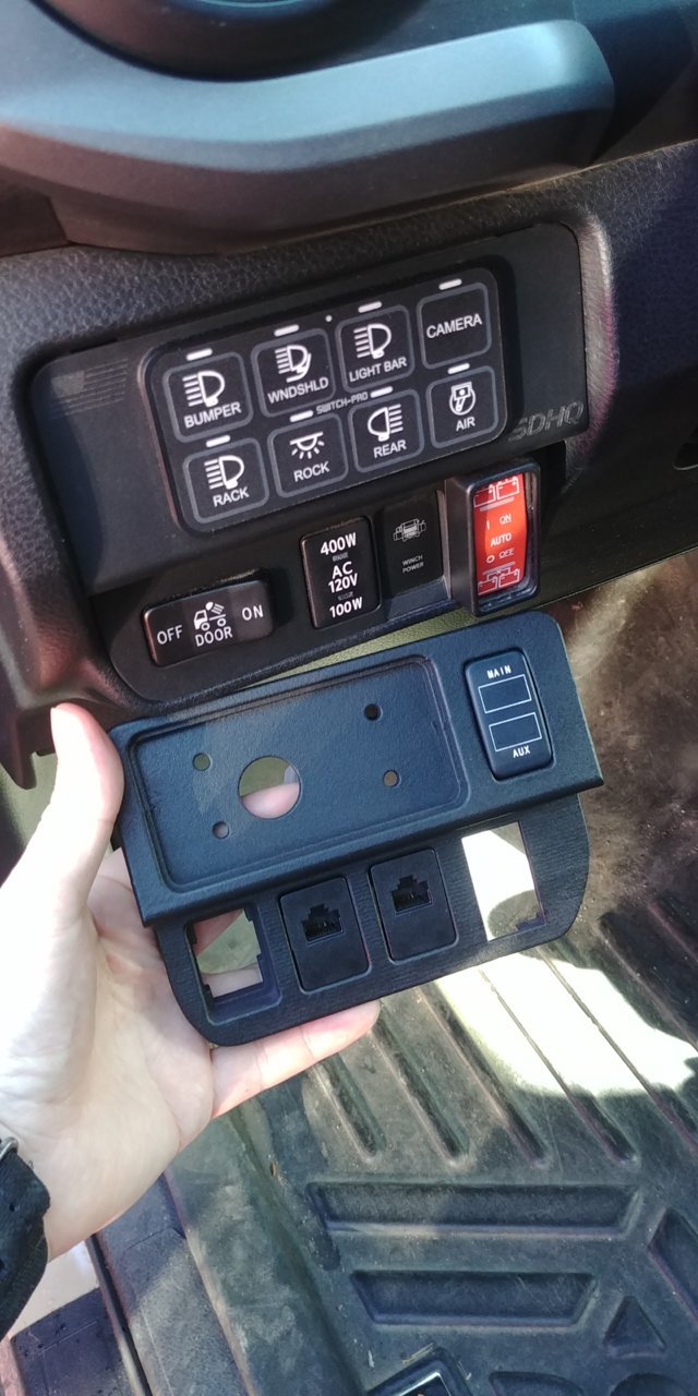

    And here's my @MESO custom panel I had ordered back almost a year ago (ended up trading in my truck and took a long time before I got my 2020 and was ready to install). As you can see on the left side, the cutout doesn't go down that low:
    I messaged @MESO and he's being awesome enough to let me send it back to him and trim them out for me so it works and they'll fit, but it surprises me that no one else has run into it before. Not sure if keying changed in 2020s or people are just shoving them in there anyway (you can kind of force them in if you REALLY try, but I don't like forcing it if I can help it). If it truly is a problem, wondering if the generic B slot he uses needs to be updated for the future.

    What is that red switch? Is that for running different batteries while the car is off?

    It's a Blue-sea ML-ACR. It's a voltage sensing battery link/disconnect between the 2 batteries.
    Technically it's not required for a dual-battery system but I like having the option for a manual override.
