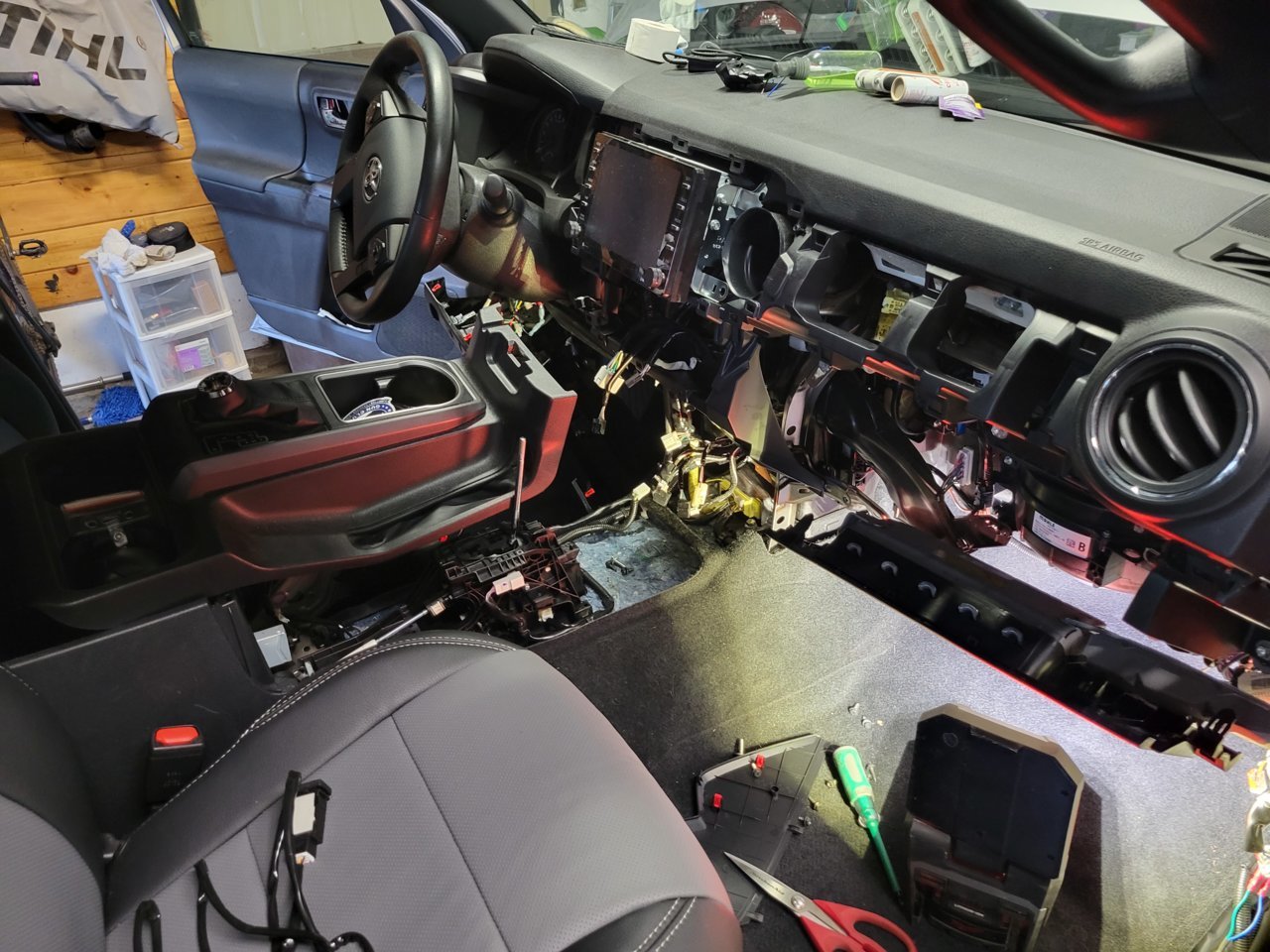

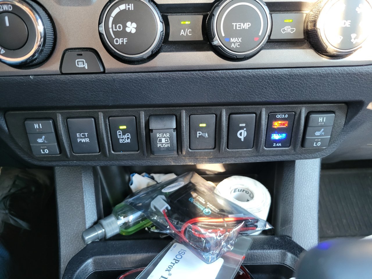

    Finished installing the lower switch panel this weekend. What a pita. You have to rip the entire interior of the truck apart. Worth it in the end and looks totally factory. I did end up with one extra screw. Seems to be normal.

    This is almost exactly what I'm going for. Did you follow any guides or videos for your USB or seat heaters?

    For the USB plug I just stole the power wires from the old cigarette lighter plug.
    The seat heater wiring harness was a terrible design. It put relays under the carpet in odd places. I already have an aux switched bussman panel. I wired all the hots together and ran 1 extra wire to that with a 20 amp fuse. The ground was done on a bolt under the Qi charger. I got the plug and play switch illumination harness in the BST thread. The yellow wire ran to this. All the wires and relays are hidden under front cup holders/Qi charger. Just the one wire through the firewall.
    The nice part is that if I ever have to get to the fuse or relay I can just pop up the center console and not need to unscrew anything.

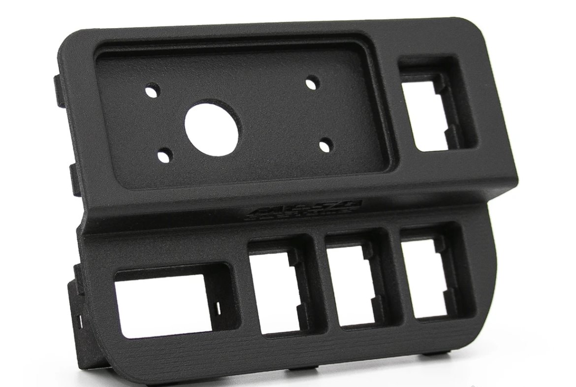

    I need this type?! Can anybody direct me to one pleeeease!!

    I know, sorry I am out of switch blanks at the moment. I have more in production.
    That's a CUSTOM LAYOUT [HERE]
    CONFIG:
    TOP: F-B
    BOTTOM: E-B-B-B
