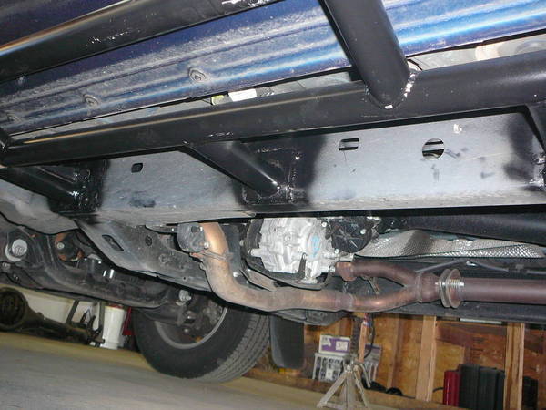

    He just used the krylon inside/outside satin black spray paint with the adjustable nozzle. It seems pretty durable, and what I like about it...if it scratches, its an easy touch-up. In the future Derek reccomended going to a skateboard shop and just buying the grip tape and laying over the top for wet weather.

    Last night I swapped my tires back to my muds. I used my Hi-Lift to jack up the truck with my sliders. I expected them to flex and moan with the weight of the truck. Fuck no, those bastards didn't even flex they are strong as hell. I even put the jack stands under the legs and let the truck rest on them.

    I see that there is a square plate welded to the slider then to the frame, who else has done it this way? I was considering using some angle iron and welding it to the slider then to the frame to give more coverage and strength.

    That sounds like a good idea. I'd still use the gussets for support on the top too.
