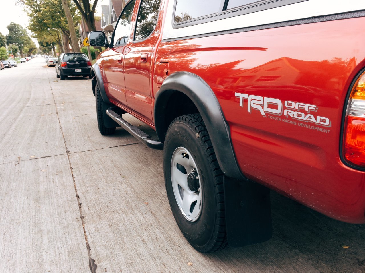

    I painted mine with 3 coats Rustoleum midnight black metallic then 3 coats clear. 70MM emblems off flea-bay.
