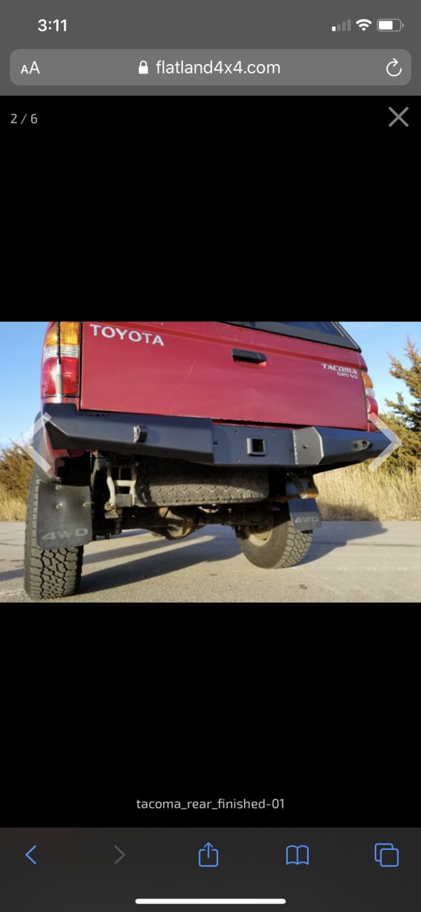

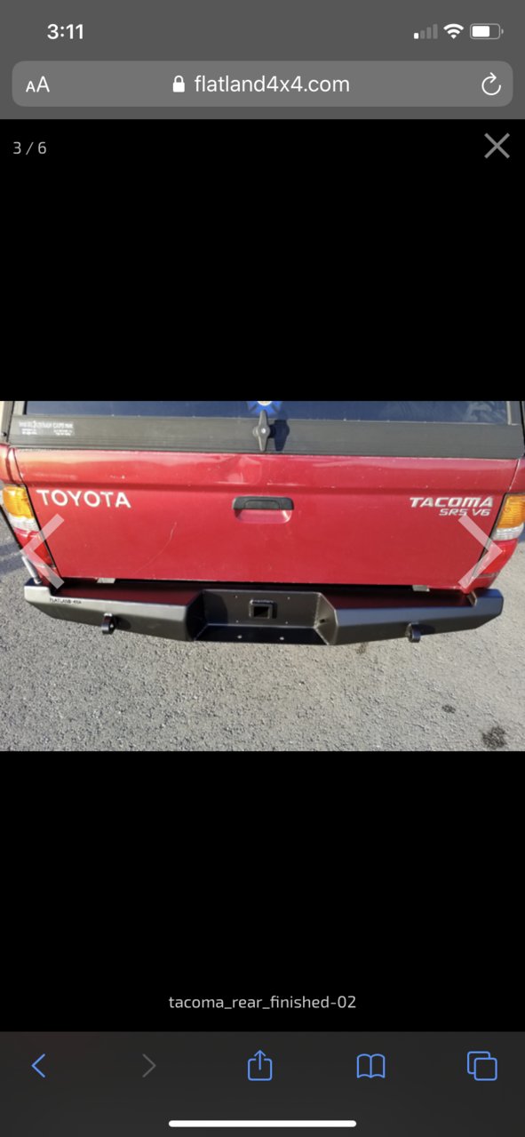

  15. Oct 7, 2020 at 2:12 PM
    #75
    96BlueTacos
    96BlueTacos [OP] トヨダ
    Jul 5, 2017
    #223188
    1,137
    Mikey
    Earth, 3rd planet from the Sun (CO)
    1996 Single Cab Taco Manual 4x4 3.4L V6 370k /1985 4Runner 4x4 22RE 200k /2001 Double Cab Taco Auto 4x4 Supercharged 3.4L V6 180k
    1996-JBA upper control arms, replaceable Cardan joint drive shaft, leveling kit, camper shell, trailer hitch... 2001- TRD Supercharged, TRD headers...
    this is the bumper I just downloaded plans for4C733FE7-467D-4B92-B5BD-4136B65F7FFF.jpg03AFE538-D7A8-4710-A72E-6B3C0E5C4E67.jpg
  16. Oct 7, 2020 at 4:01 PM
    #76
    jbrandt
    jbrandt Made you look
    Feb 12, 2011
    #51038
    17,612
    Justin
    El Dorado, CA (NOT El Dorado Hills)
    '04 TRD Tacoma 4x4 DC
    Kings, J59's Total Chaos UCAs Custom skids Sticker mod
    Nice, that's a slick looking one!

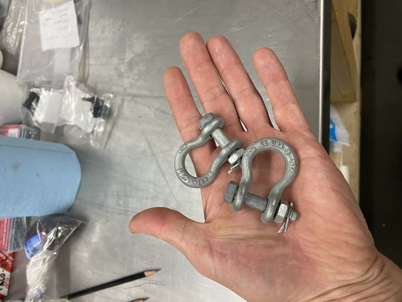

  18. Oct 7, 2020 at 6:11 PM
    #78
    Kwe1982
    Kwe1982 Well-Known Member
    Dec 24, 2016
    #205616
    107
    Wisconsin
    Gone - Just a couple Tundras and a Sequoia
    Sorry, about the late reply. I thought I hit post reply.
    I used a 4" grinder and an end grinder, plasma torch would have worked better.
    I had to get the small 2-1/2" blades on the end grinder really worn down before I could make the 1" cuts for the shackle lugs.

  19. Oct 7, 2020 at 6:12 PM
    #79
    Kwe1982
    Dec 24, 2016
    #205616
    107
    Wisconsin
    When you wanted 3/4” shackles and ordered 3/4 ton shackles.

  20. Oct 7, 2020 at 6:40 PM
    #80
    96BlueTacos
    Jul 5, 2017
    #223188
    1,137
    Mikey
    Hahaha those are so cute!
