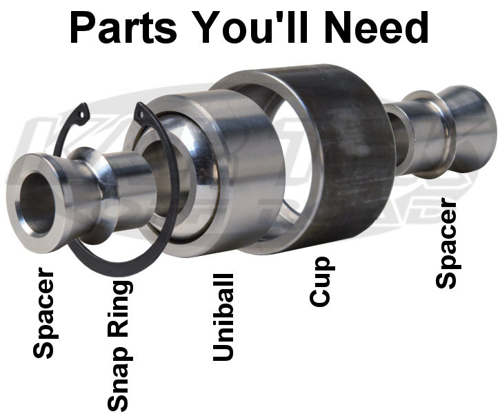

    Why weld back on the weak factory ball joint. Why not upgrade while your cutting and welding and throw in a uniball. :notsure:
