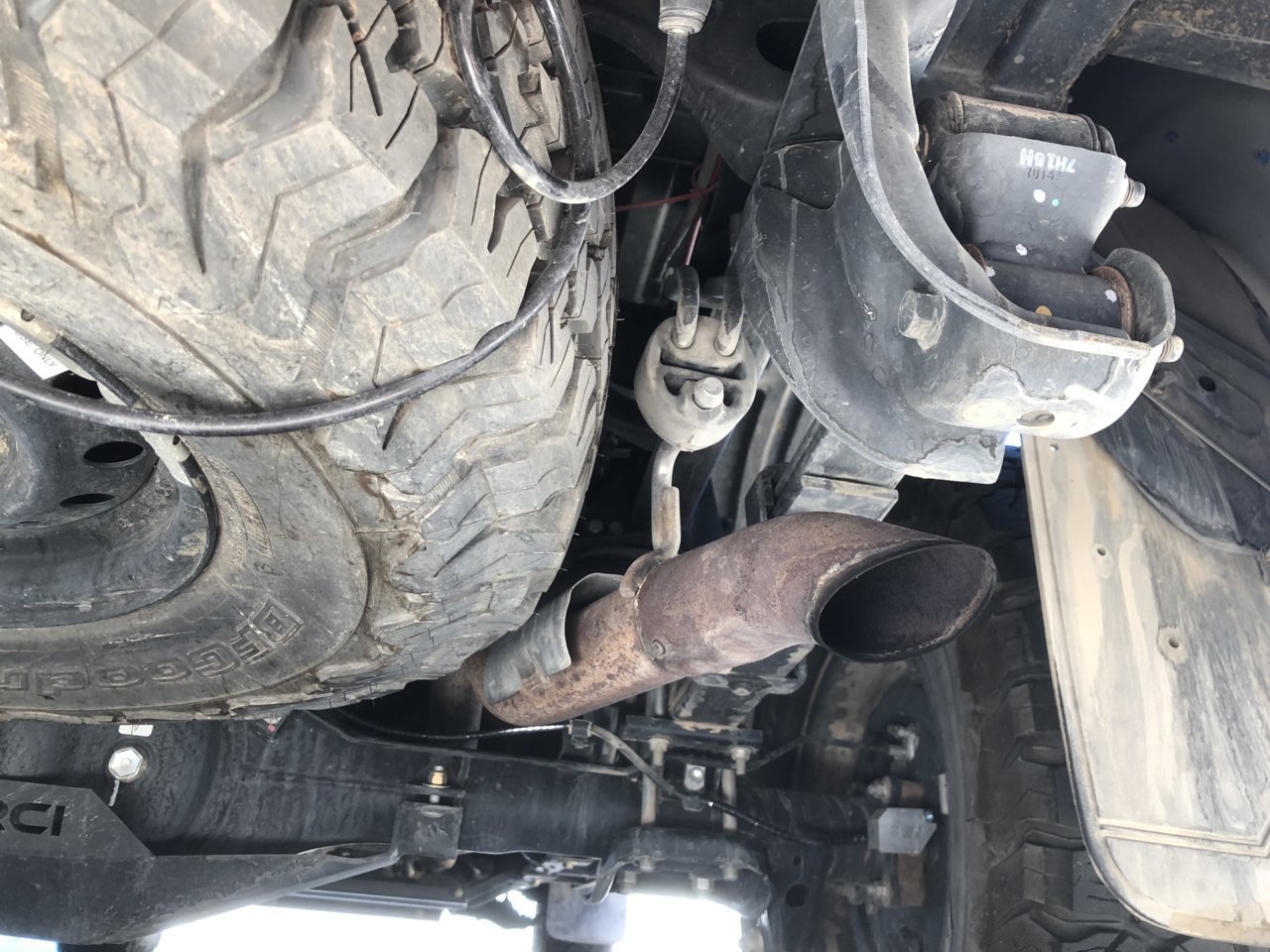

    cut mine like this. have the mbrp cat back setup which came with the pickup. i don't notice and fumes or extra drone the mbrp is not the quietest though lol. I had to cut mine to fit my 285/70/17 in the spare tire space and i had to hammer the tabs where the spare tire goes open and drop the air pressure down to 13psi.

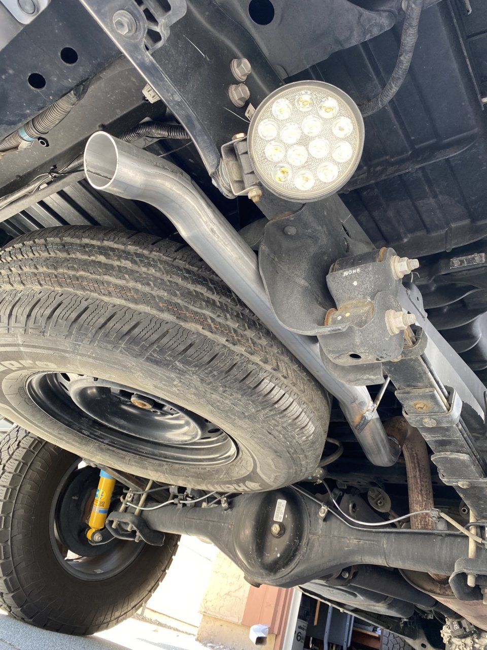

    Instead of cutting it above the axle, I cut mine off behind the last hanger and put a downspout tip on it. Works great and clears the spare- puts the exhaust outlet further back so there are no fumes. Makes it useful too as I scrape my rear end occasionally on ruts and other obstacles like boulders when I drive up and over them, especially on that right rear wheel.IMG_1252.jpg

    Great idea, lots more to think about here.

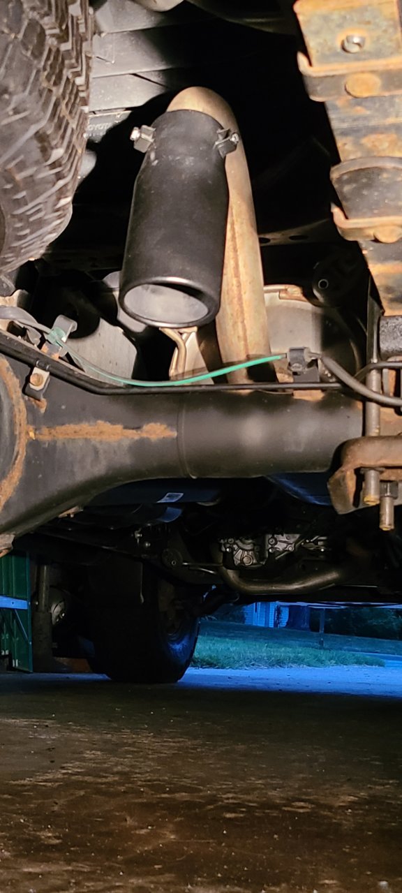

    This is perfect. I'm not catching this drone everyone speaks of. With stock muffler and 2.5" pipe this is about as good as it gets without getting loud. I should add it's a resonator tip.
    Not much difference in noise which I like. I'm telling ya, getting rid of those 2 extra bends opens it up.

    I was reading resonator tips will eliminate any high tones from the exhaust.
    Not looking for loud.
