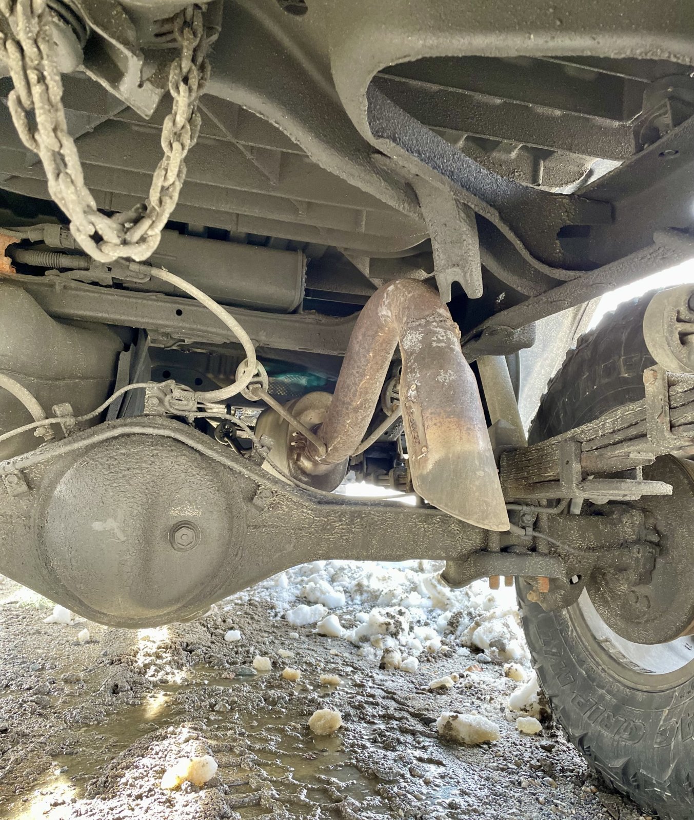

    I cut my exhaust in my 2007 FJ cruiser because I smashed the exhaust tip, I started to get heating issues underneath the cargo area.
    I eventually wound up rerouting it behind the rear wheel.

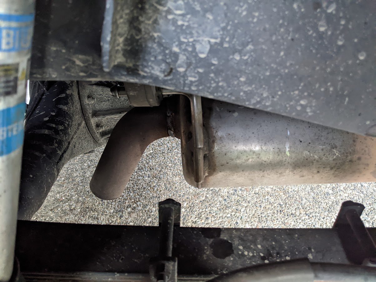

    Yeppers. Pro cut at the outlet and turn 180deg.

    In addition, I was thinking of turning it a bit towards the side so that the rising warm exhaust has less opportunity to linger underneath the Taco (potentially rising underneath and then accumulating inside the covered rear (cap) or coming in thought the cab vents.
    Getting it to the side in this way most of the exhaust would be pushed past the body to the side and then it would rise freely away from the taco.
    I don't think accumulation is an issue while moving - it would be more likely when slow-going, or while idling in one spot.
