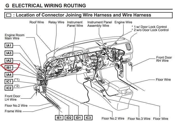

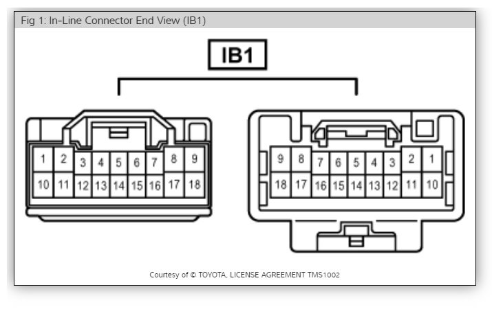

    Sounds like the fuel pump may have failed but check Connector IB1 Pin 8 (Black/Red) behind the drivers side kick panel for signs of melting or burning.
    If it looks good make sure you have power there during cranking, if you do then you have to go to the fuel pump.
