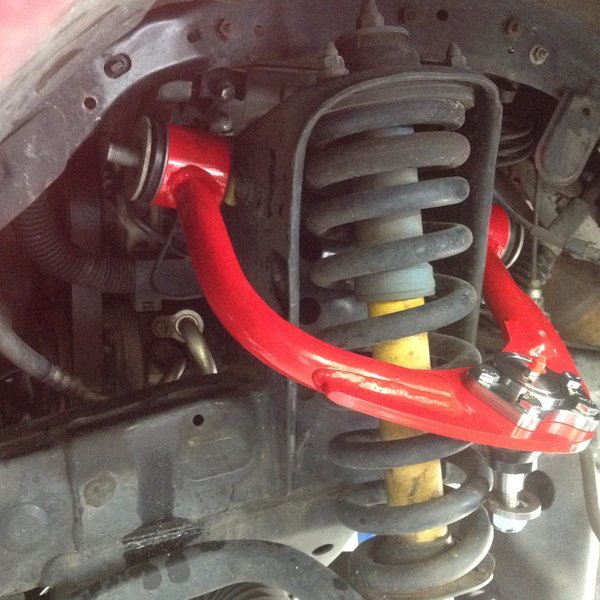

    I went with cutting and installing from the rear with two new bolts and nuts @ $24. Even if I bent and went from the front, I felt reusing the bolts and nuts vs $24 wasn't peace of mind. I did use red loctite.
    My new JBA UCA,s for un-lifted Tacoma.
