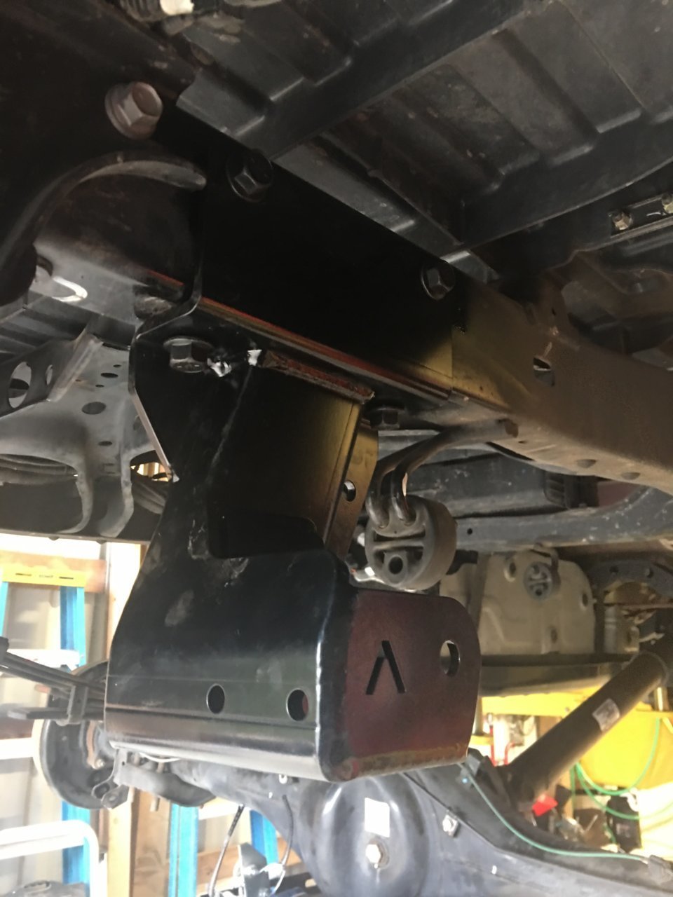

    Guys I’m new in this forum. I have a 2019 tacoma. And I have a question. I want to lift the truck 6 inch but I hear that the have to cut the frame to do that. Is that right?

    You cut a cross member for the drive shaft to pass through after the drop bracket is installed.
    Do your homework on here before you pull the trigger, its not for everyone.
    6" is primarily for looks, and big tires.

    They cut one of the cross members but drill holes in the remaining center part and insert tapped sockets. Then they bolt the new dropped cross member to those two holes as well as two other long bolts at each end of the new cross member. The cross member is cut to allow for the front driveshaft to stay at stock height while the rest of the truck is lifted.
    It is not impossible to re-weld either the piece that is cut out (provided the shop that cuts it out does so in one clean cut) or you can always get a shop to fabricate anew piece should you ever want to go back to stock.
    18" rims are a necessity to allow for more clearance on the new spindle that will be added to achieve the lift. Otherwise you could always go with wheel spacers, however assuming you'll be going with rims that have less offset, the stress created by that offset plus the offset created by adding a spacer will add to potential premature stress on bearings.
    Most drop bracket lift kits come with very large rear blocks as well. Axle wrap is a bitch but can be combated with traction bars.
    Do lots of research and if at the end you decide a 6" lift is for you then do it! They look awesome and definitely allow you to clear larger tires with a little less cutting/massaging but they do present problems just like any other lift out there.

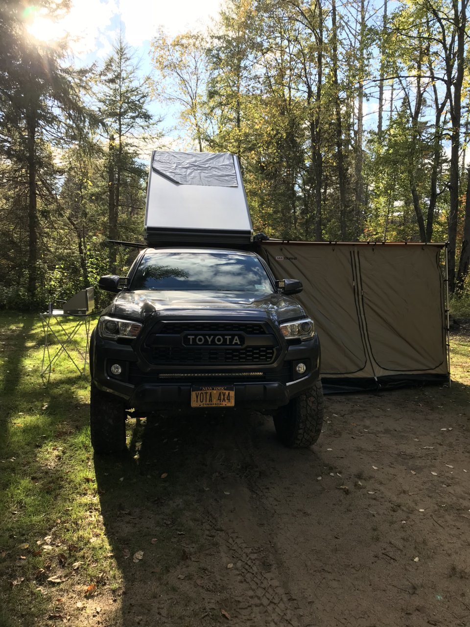

    What’s your ultimate goal for your truck? Not to be snarky at all but it’s true a 6” lift on a Taco is mostly for looks. If you’re looking to really Offroad look at other options. That said if you’re doing it for looks and to put 35’s on it, well I’ll be honest I do think it looks cool. Just be realistic with your goals before you pick a direction.
    This is my 17 with a 3” lift and 255 85 R16’s. It’s the ideal compromise in my opinion.
    Again not knocking your idea just have a plan before you start spending.
    Welcome to TW
    Keep in mind you’ll need 18” rims and prob want to swap gears so your truck has some kind of power and gas mileage still. It’s a pricey direction to go.

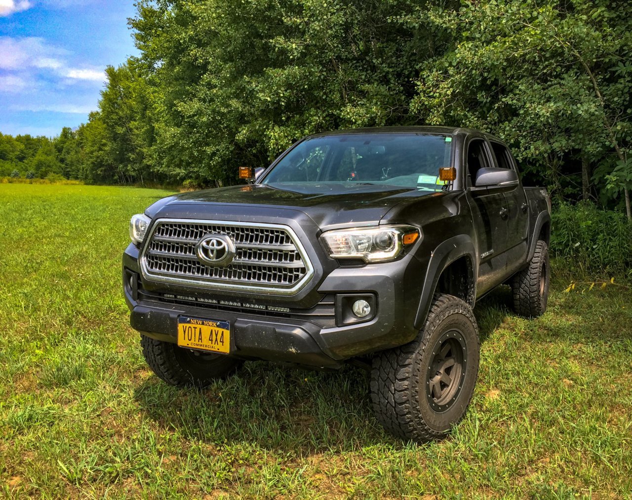

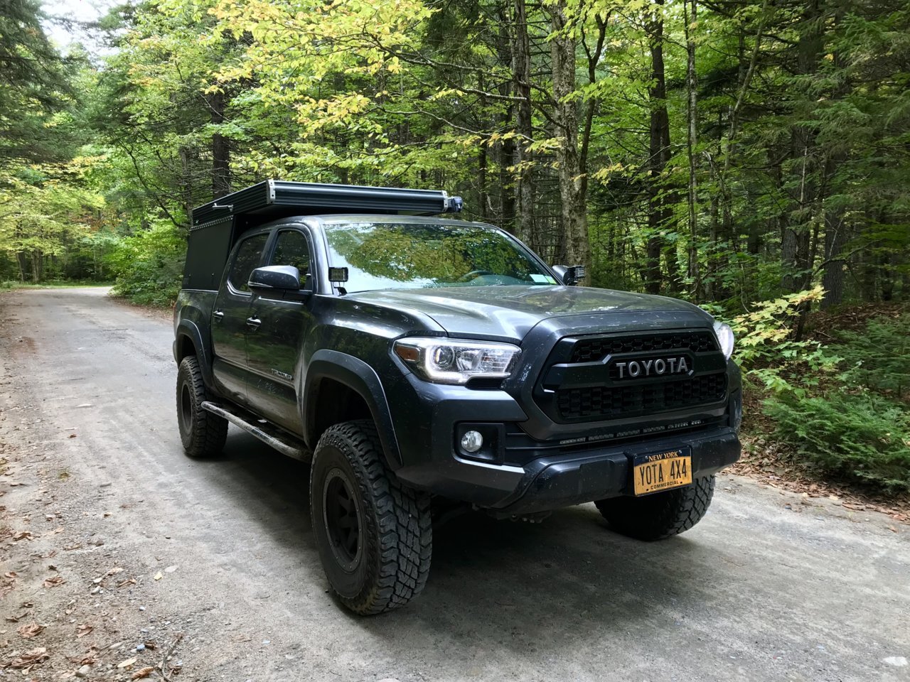

    I love the 255’s there’s a lot of big advantages to them depending on what you’re doing. My truck is purely a mild Offroad and serious camping vehicle and they fit my needs perfectly.
    They wear like iron, get great traction, and allow me to run 33’s without the cab mount chop. I dog there look too.
    Here’s my truck as it sits today.
    TacoPandaTRD, Jaggerbub and 13txtaco like this.

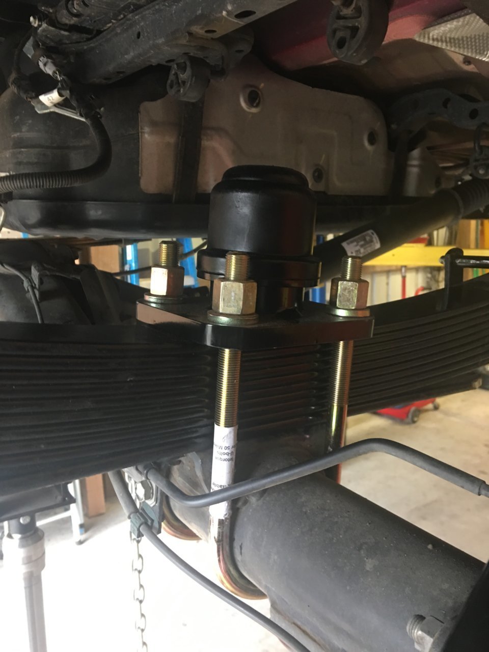

    Here is a great install video to give you an idea of what is involved in a BDS Suspension System. However, there are a lot of different Suspension Systems out there other than BDS.
    https://youtu.be/OKKeRZ1y8Og
    As for rims, most people buy rims once after they get their truck. Some can’t make up their mind and switch out rims all the time. If I were you, I’d figure out what size you want to go with first and go from there. I originally purchased 17x9 for my 295/70R17 Nitto Trail Grappler Tires and absolutely loved them. However, I had 18x9s in my cart at the time of purchase and switched last minute to the 17s. If I had went with the 18s for my original purchase, it would have saved me money when I made my switch with my Suspension System. Instead, I purchased a brand new set a second time going with 18x9 for my 35x12.5R18 Nitto Trail Grappler Tires. I was lucky and was able to sell my original set and didn’t lose much money at all. So do your homework on what you want first before you just go with something to go with something. Both of my sets were/are -12 offset with 4.5 backspacing.
    Yes. The rear suspension system does come with a Block, but you do not have to use it. It is up to you. You can do your research on whatever System you want. Again, it just comes down to money. However, any System you run, if it’s a true Suspension System worth a damn, it is going to cost you. There is no cheap way around it. Here is some pics of my rear suspension system:

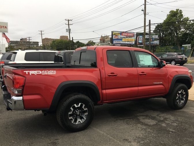

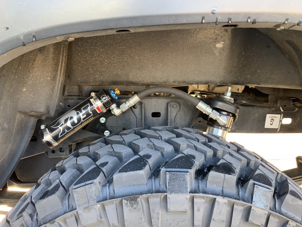

    I went with the following:
    I do not have Axle Wrap and I do not have Traction Bars installed on my truck either. I have not had to cut on my truck with any of my setups/tire sizes/etc. other than the one cross member for the Drop Bracket.
    Stock
    3” Lift
    6” Lift
    I did choose to do the CMC recently but I did not have to do it. I purchased the plates thinking it was going to be a MUST after hearing everyone say it was with 35s and it wasn’t. However, since I had them already I decided to not let them go to waste. Plus it is a minor mod.
    All systems present problems down the road. It depends on the owner whether it be sooner or later on how you operate and maintain your truck. I agree, do you research. I did research for 2 years before I settled on my final setup and I absolutely love it. I wouldn’t have it any other way. Looks, performance, etc. you name it, I love what my truck is capable of doing and what places it can take me. In the end, that is what you need to be able to say to yourself. I agree with @Dr. Emmett Brown

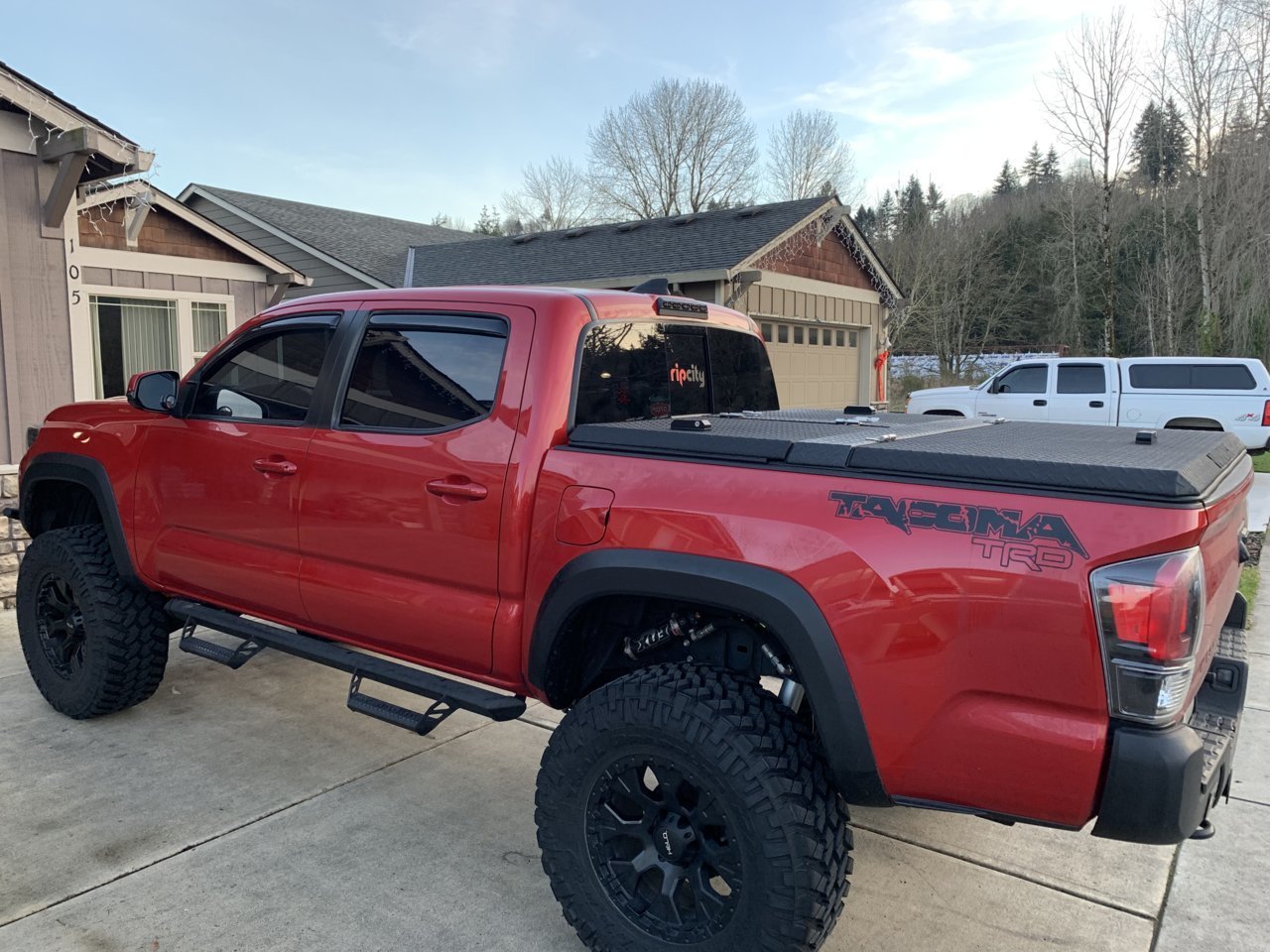

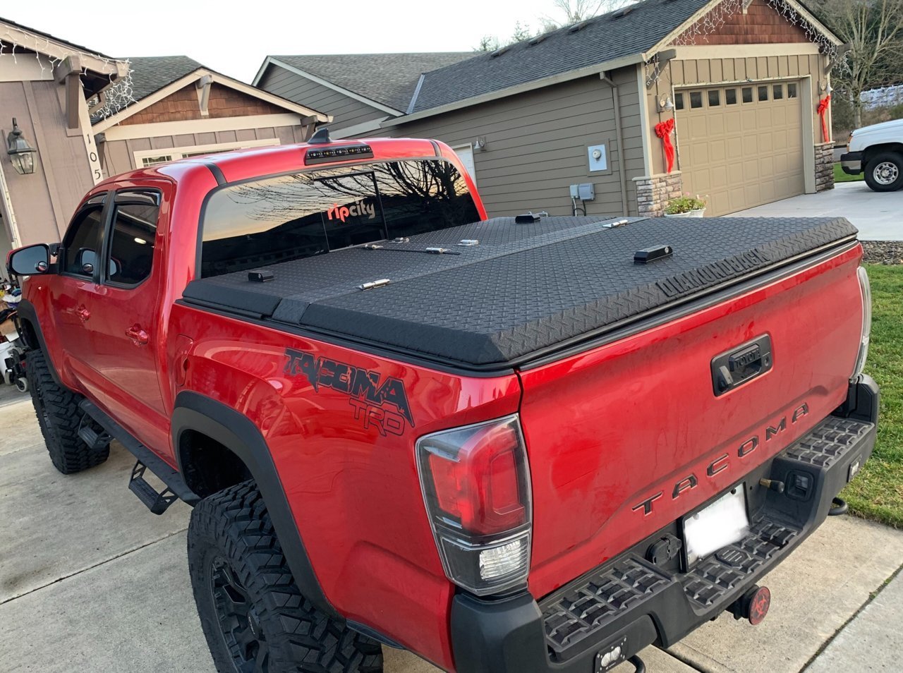

    Also what’s the story with that rear bumper and lights? Are those the bumper covers with a hole cut in for LED backup lights? Those are sweet...

    Yes. I installed Baja Designs S2 Sport, Wide Cornering, Flush Mounted to my OEM End Cap Covers.
    I have them connected to my SwitchPro and they also come on with the Trigger Wire for my Reverse Lights.
