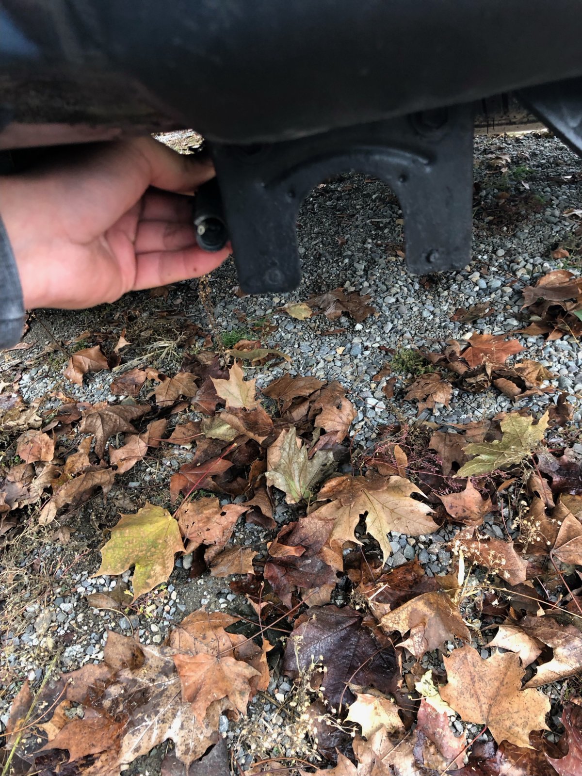

    Hey everyone, just picked up a 2015 TRD sport and it looks like the previous owner cut the trailer plug. What are my options to get this working again?

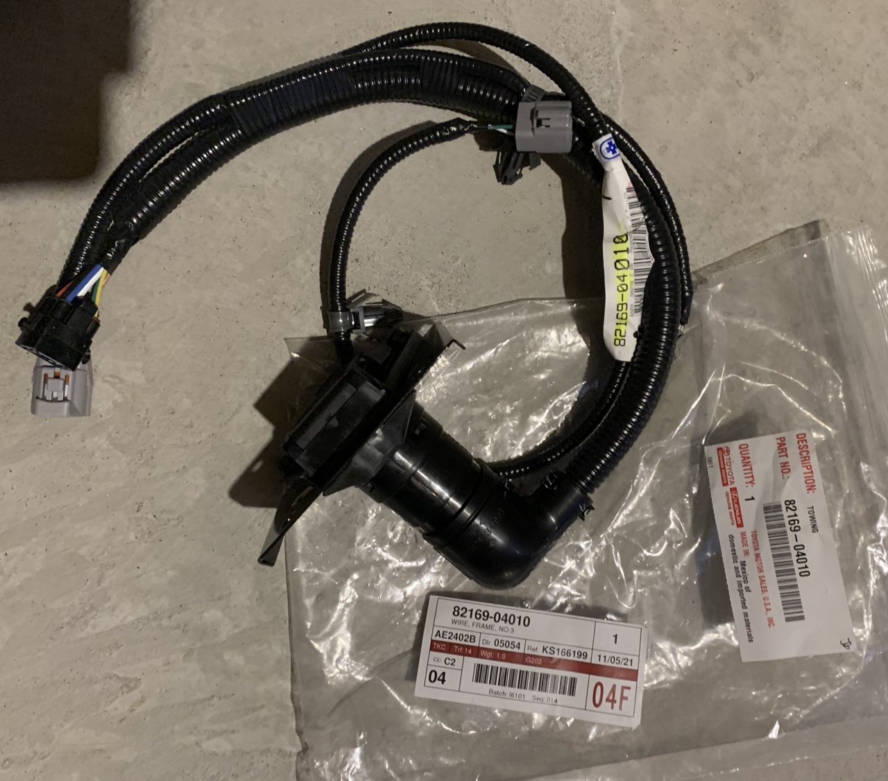

    That whole section plugs in under the bed of the truck. I'm pretty sure it even has its own part #.
    I'll see if I can find the post where we discussed this once before on here.
    UncleThom[OP] and HondaGM like this.

    Here you go.

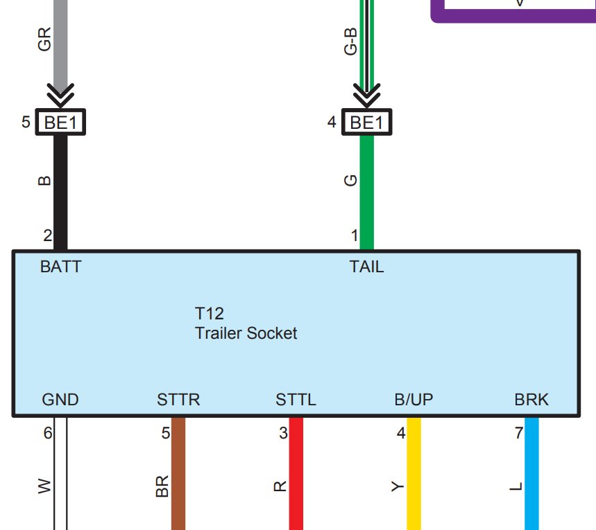

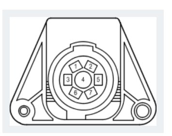

    If you want to try to go a cheaper route.
    Here is the diagram.
    STTR - Stop/Turn Right
    STTL - Stop/Turn Left
