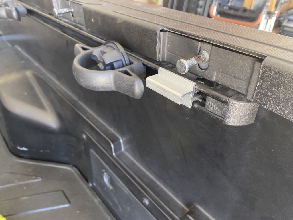

    I did it, just looked at pictures of the oem cutout, and used a razor knife, they are very easy to cut.
    Found a picture.
