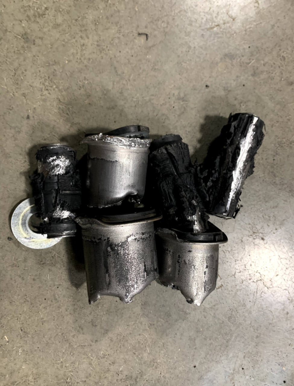

    Getting the bushings out is the hardest part I use a Oxy- Fuel Torch to melt and Burn them out.
    Once the arms are off they go to the drill press drill through the bolt once the pressure is off the cam bolts the air hammer pops them out easy It is the blows per minute that gets them out

    That's a verrry good point. Maybe I'll do the energy suspension ones... @jbrandt said that it was fairly simple burning them out. But he's also from CA. Now I'm debating getting new arms. Hmm.

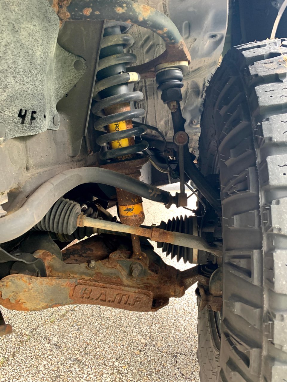

    mostly stock, grocery gettin' Prius
    Did this earlier this year on my 2nd gen.
    DeWalt battery operated sawzall with Diablo thick metal blades. Zero issues.
    55746442-8800-4C30-B6E9-DCDD08CB665C.jpg 4E7B182C-9059-41AD-9D9A-89D5907BE7D3.jpg

    Yeah, burning them out is the same whether you live in CA or not. The easier part for me was the fact that I didn't have to cut off the cam bolts.

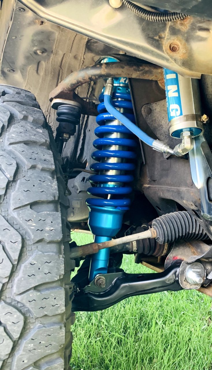

  18. Nov 16, 2021 at 3:21 PM
    #18
    geekhouse23
    geekhouse23 The "Liftman" - @DrFunker
    Jul 14, 2013
    #108251
    15,716
    2GMGMDCSB4WDTRDFTMFW!! TL;DR

  20. Nov 16, 2021 at 3:23 PM
    #20
    Green1GT
    Green1GT [OP] Well-Known Member
    Apr 29, 2020
    #326322
    268
    Maryland
    That looks like fun!
