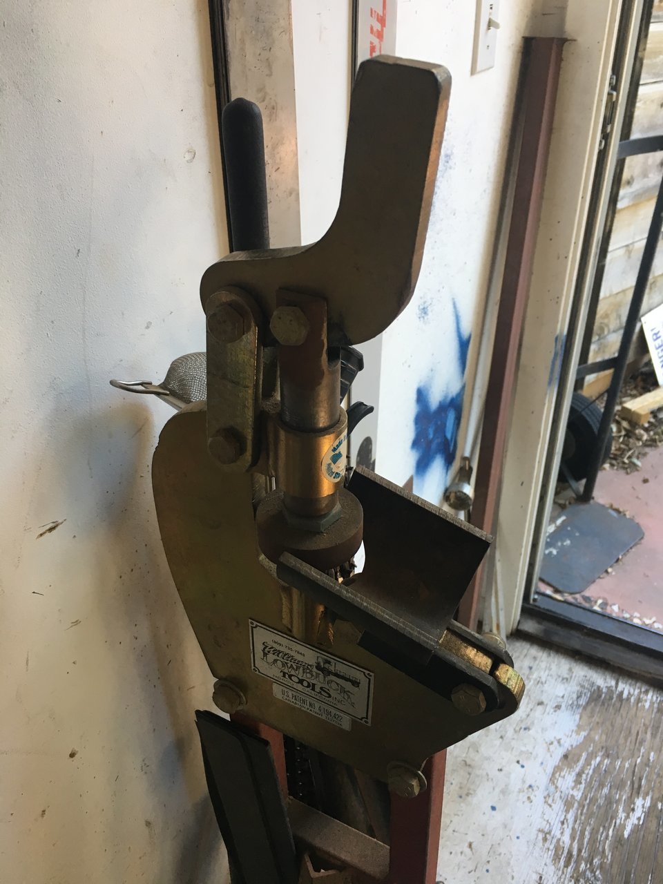

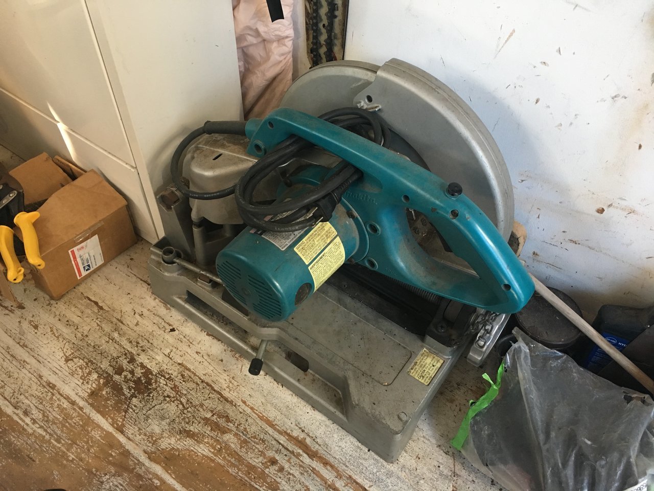

    For tube or rebar. Hard to beat.
    Makita LC1230, carbide blade.
    For a clean look, Williams LowBuck Tools tube notcher.

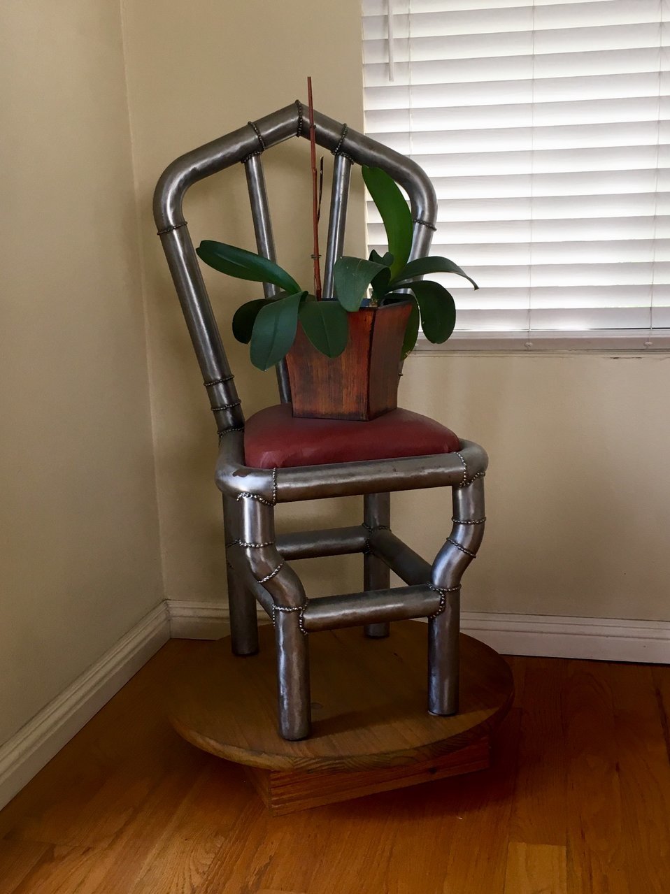

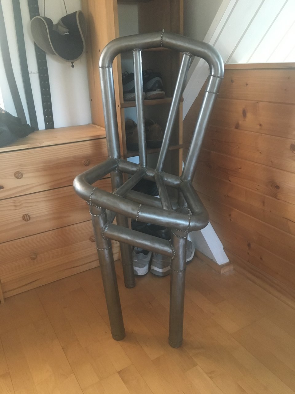

    Used both to build this chair. 18g Owner decided she didn’t want to sit on it. To each their own!
    What I like about the Mak is the 45° miter capability. Sweet machine.

    maybe steampunk fan?

    I was way cool with it.
    Hell, no one can sit on this one. Kept this one.

    drinking chair ;)

    what material did you use?

    18 gauge tube steel straight and mandrel pieces. Wire brushed and shot with clear coat.
