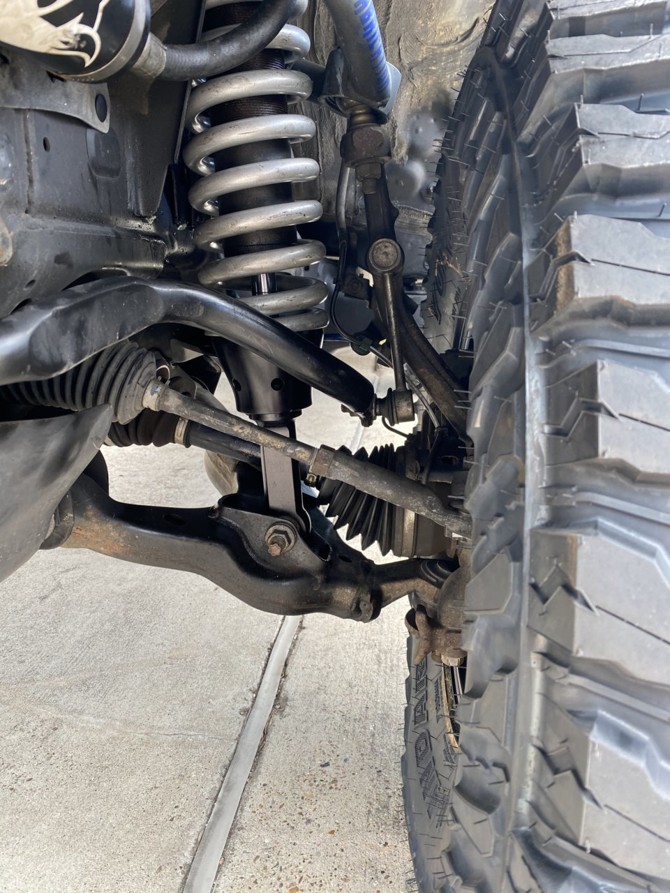

    Hi everyone. I am running a 2015 double cab sport. I recently just put 35s on it with the SCS F5 wheels with 3.5BS and 315/75/16. I’m running Fox 2.5 coilovers in the front with total chaos UCA. Took a look at my boots today and they look pretty wild. Any way to remedy this? Thank you

    Take some preload off the CO but then you'll need more trimming to fit the 35s also won't have as much lift.

    Taking some preload off should be good? I’m running 14x700lb springs for the weight I have in front. Does it looks real bad to you guys right now?

    Looks pretty standard to me for a lifted truck. You may be a little high but nothing catastrophic.

    To many fins touching, lower that thing and get some spindle gussets or you're going to bend those.

    That looks horrible, you have zero drop out at ride height... there is no way the truck will ride good like that. Uncrank coils asap
