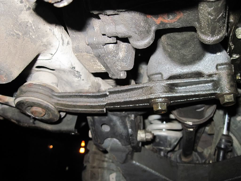

    Math alert:
    Graphed:
    Overlay:
    05+ rotates the front differential rather than dropping it. It does a decent job of shifting the gear oil away from the pinion bearings but not much for the CV angles.

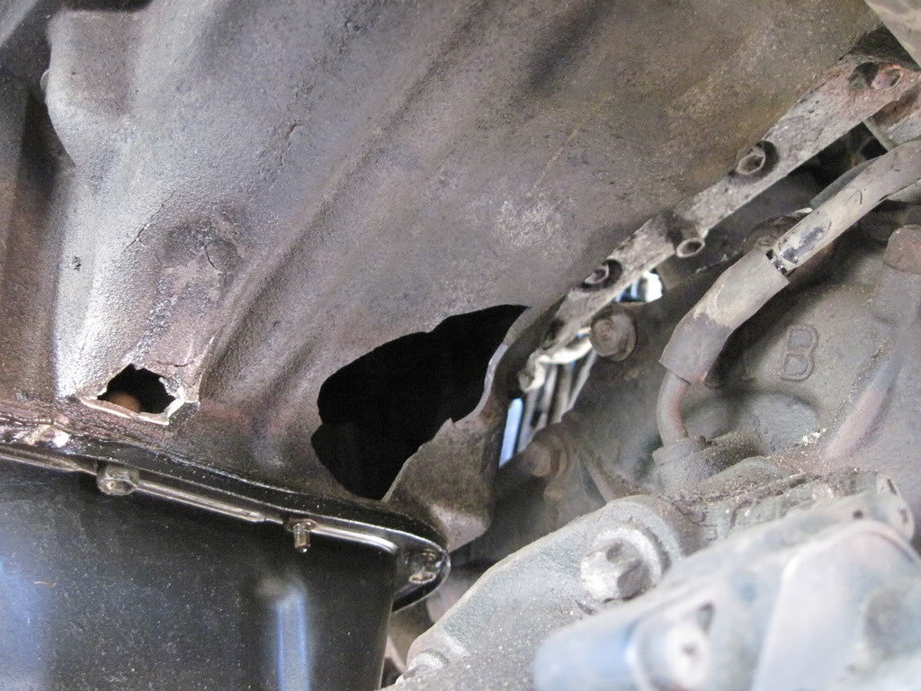

    Shattered 1 upper oil pan and cracked 1 front differential mount when it got hooked on a rock because the differential drop left it vulnerably low.
    I'll replace boots all day to avoid dealing with that again.

    Someones welds failed on that skid plate! ^

    Nothing would have helped it with that kind of impact, except of course for not having components hanging low enough to get hung up on the terrain. :p
