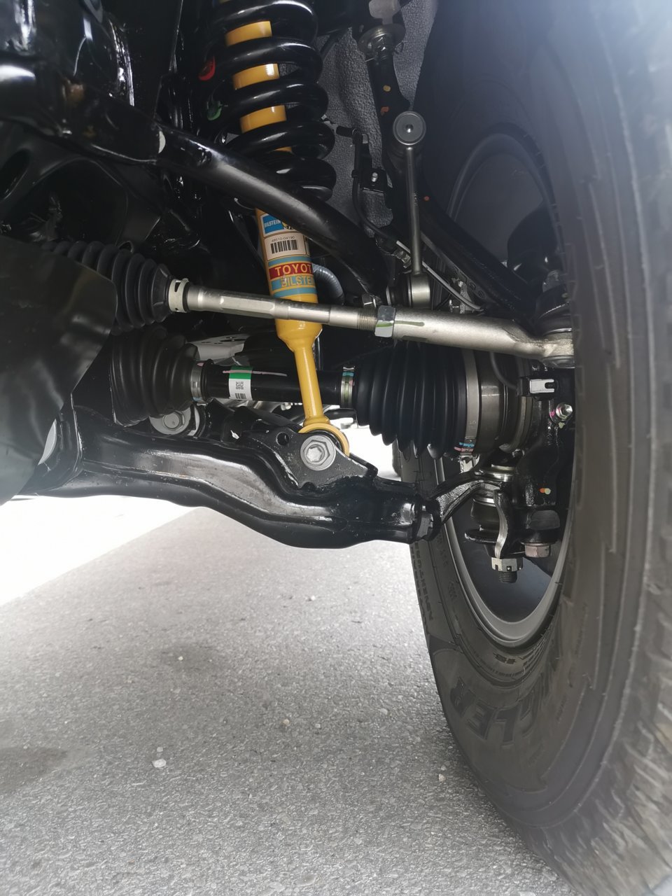

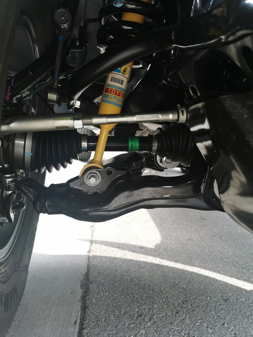

    Don't want to hijack OP's thread, but also don't want to start a new one on the same topic. Recently installed a 2" lift. How do my CV angles look?
    I didn't install the diff drop yet fyi

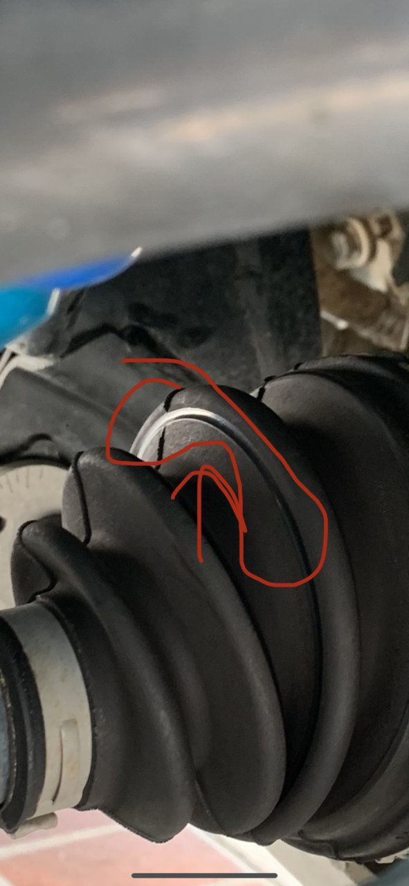

    Fins in the middle of the red circle here look like they're touching, those are the common ones to rub and leak..
    Fast1 and Evdunn[QUOTED] like this.

    CMC and just rubs on the plastic

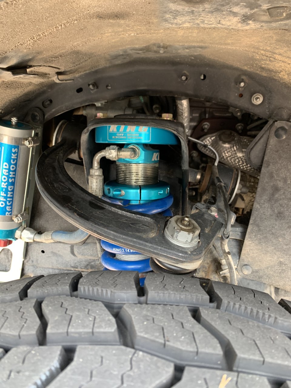

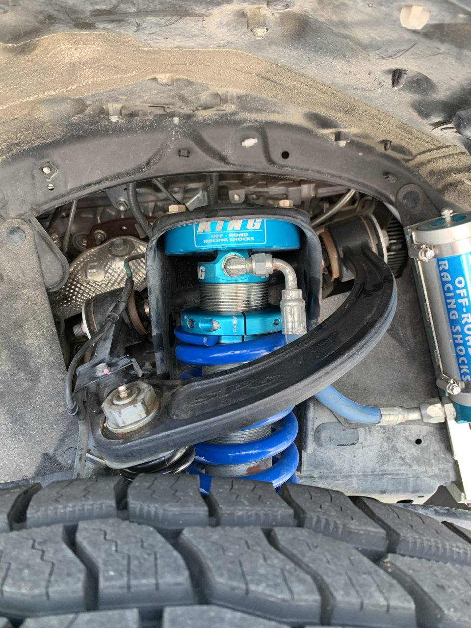

    Yeah it honestly doesnt look like you have a ton of lift based on the preload in that pic you posted. Im kind of surprised the inner fins are rubbing that bad. How many miles since the lift went in?

    Diff drops are a thing but somewhat controversial as to whether or not they help or create more problems than they solve. I have a diff drop in my 1st gen but to be honest I couldn't tell a difference after I installed it. Doesn't really 'drop' the diff either, it just tilts it downward a bit. I had to lower my lift a bit to correct the angles.
    Carrier bearing drops just help lower the drive shaft angle closer to stock, won't have any effect on the CV angles.

    C710D969-CACA-477F-968E-FCEBA4BBACF3.jpg 65FC88D3-9A1C-4823-81A6-723A6A7A5F2D.jpg
    Heres driver side vs pass side. Went on about 10k ago but just cranked both sides down 3 turns yesterday as I got new tires.

    Wonder if it been rubbing for a while now.. The grooves on the inner boots look kinda deep based on the pics you posted

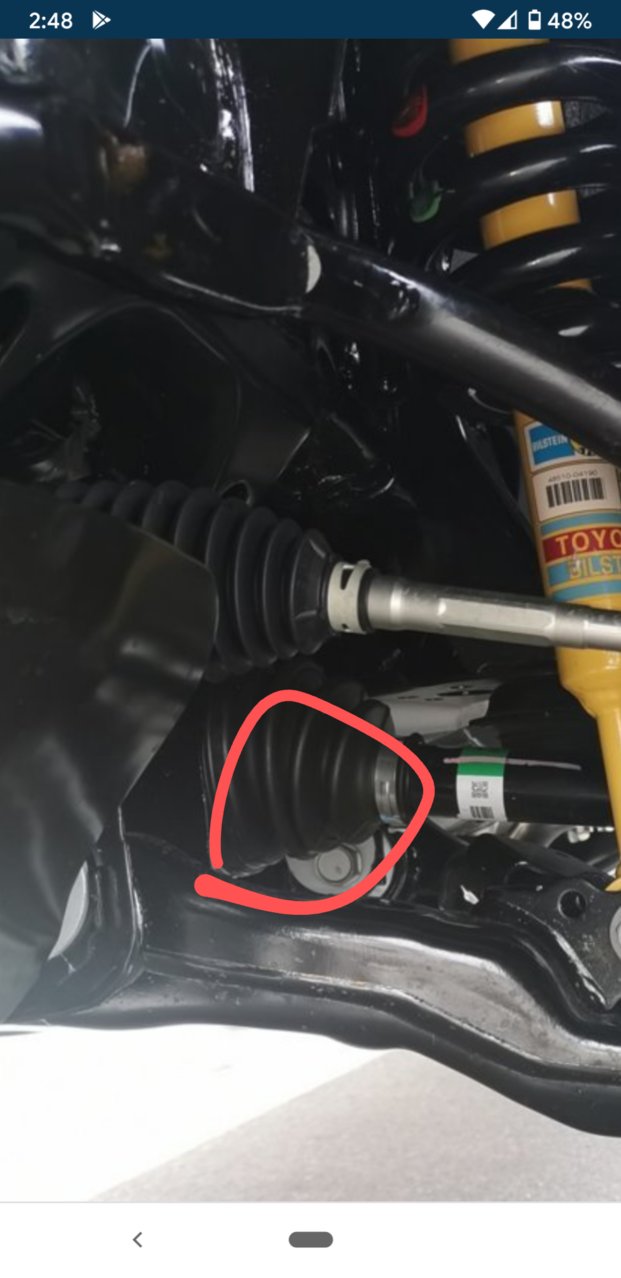

    Also is this wear or is this groove on everyones boots?
