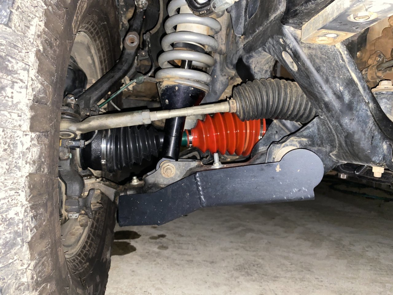

    2.5 inch lift with cvj axles! No rubbing on mine!
    13txtaco and Dirk Diggler like this.

    Those look like they have the boot slide mod done to them, I know that's an option with CVJ. Definitely helps prevent the fins rubbing

    Yes they do. It’s there high angle boot.
