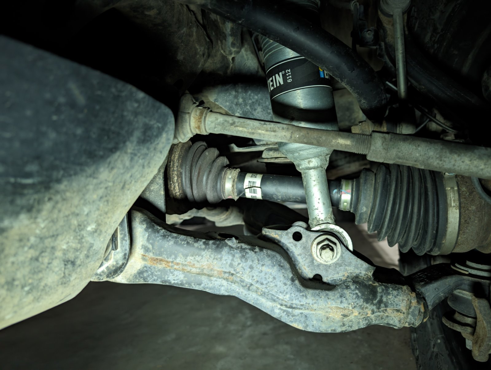

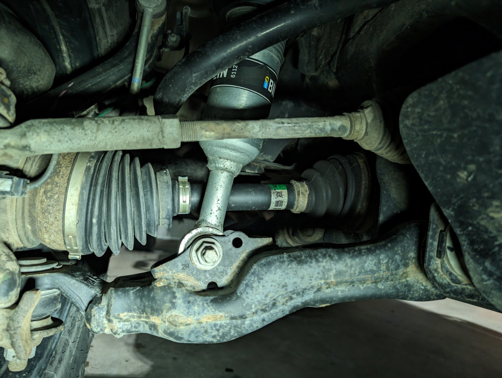

    How do my CV axle/boot angles look? I have a 6112 at max with standard coils/ 5160+ 1" block.
    I can hear a slight rubbing sound. What can cause the sound?

    Angles are fine, boot slide would help save your boots. As for the rubbing sound.....could be any number of things. Post a video

    Just make sure the fins on the inner boot are not touching and you should be good.

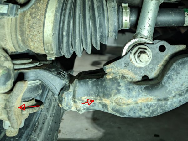

    At full lock, the steering stop touches the LCA. When you're moving and the suspension is articulating, there will be a rubbing sound at full lock:
    If you have stock 16" wheels, the aft edge of the LCA could also rub on the inside of the rim depending on the alignment cam bolt setting. Your cam bolts appear to be set to maximize caster, which will cause this rub (happened on mine).
    This is all assuming you have stock-size tires. Larger tires can of course rub elsewhere.
