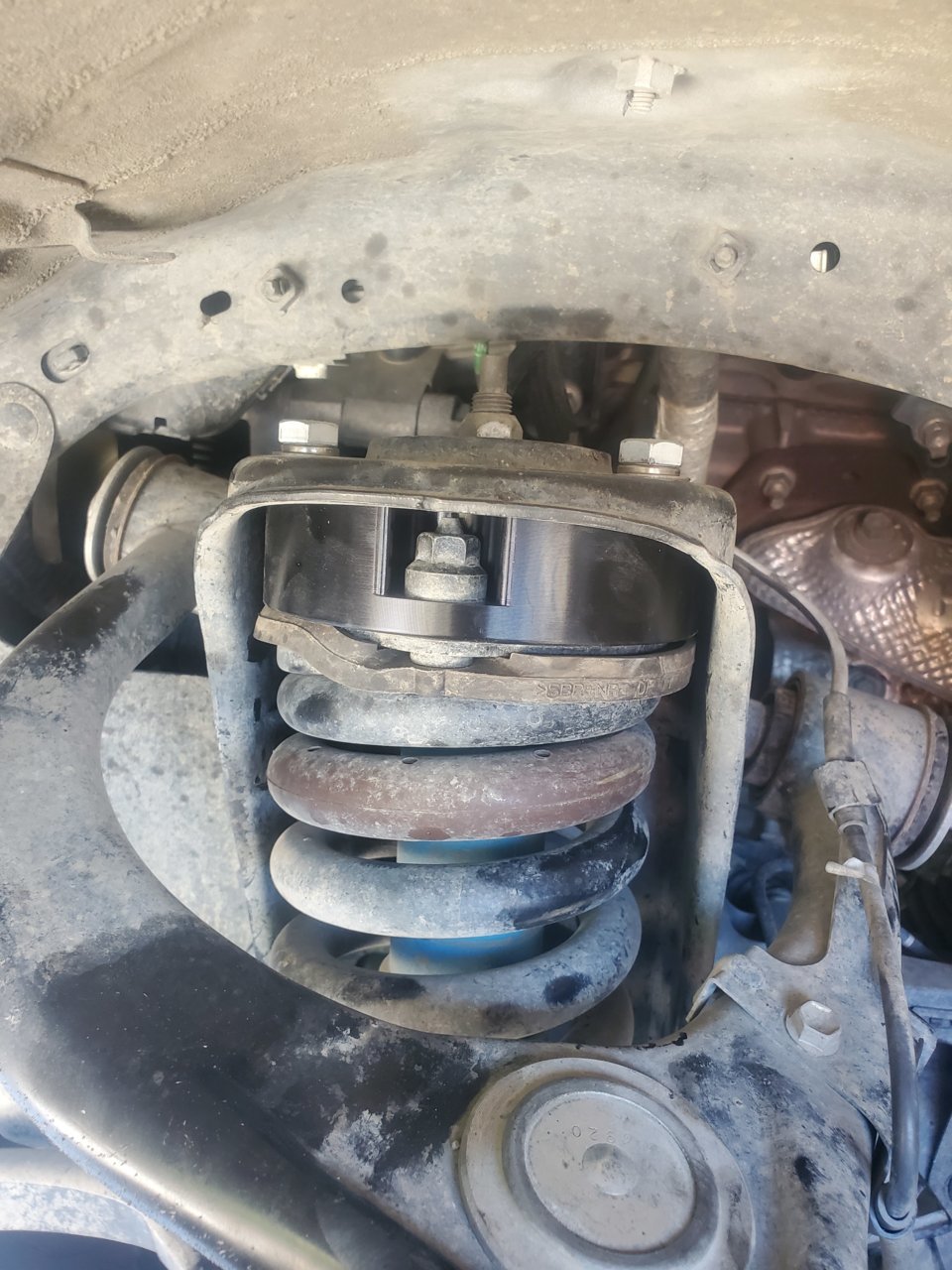

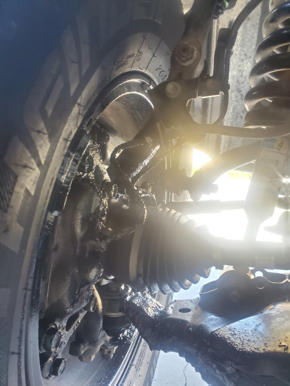

    Hey guys so I recently installed a 3" spacer on my 2017 Tacoma and now I see a bunch of grease behind my rotor and on my mudguards and I have no idea if I need to replace my CV axle or it may be something else...r u guys familiar with this issue?20200720_164838.jpg 20200720_164844.jpg 20200720_164903.jpg

    Yup cv grease. Might have punctured when installing lift. If you replace, buy refurb oem. Dont buy parts store cvs.
    you could reboot but outer is a pita

    I had that happen on a Chevy 2500 once after putting on a leveling kit. My boots had more of an angle than yours though. those don't look to be in a bind. Did you pinch or stab the boot or mis-lick it with a BFH trying to get your spacers in?

    Yeah boot is bad. You can do it for $20, but you need the clamp tool. Worth it to buy one for a few bucks.

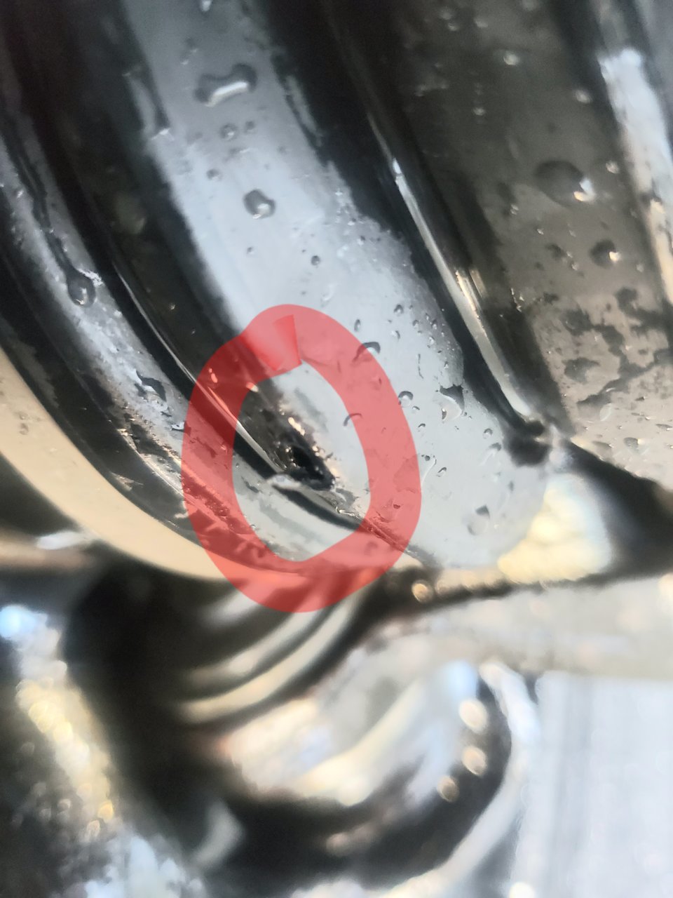

    Found the problem guys thanks for the support There's a small hole on the boot 20200720_182737.jpg

    You could get the shop to fix it, but I've done several of these and I agree with just buying a refurbished half axle. Anyway, you can also get away with not doing anything for a long time until you start hearing the clicking noise hahaha.

    A shop did the lift and it was an old friend ... i was kinda in a rush to fix it cuz am taking my family camping this Thursday.. i think if it makes it this weekend I'll order a boot replacement and have a shop re boot my axle.. ill post a pic of the temporary repair I did.. i filled the boot with Molly grease and some kind of plastic epoxy thats super tough
